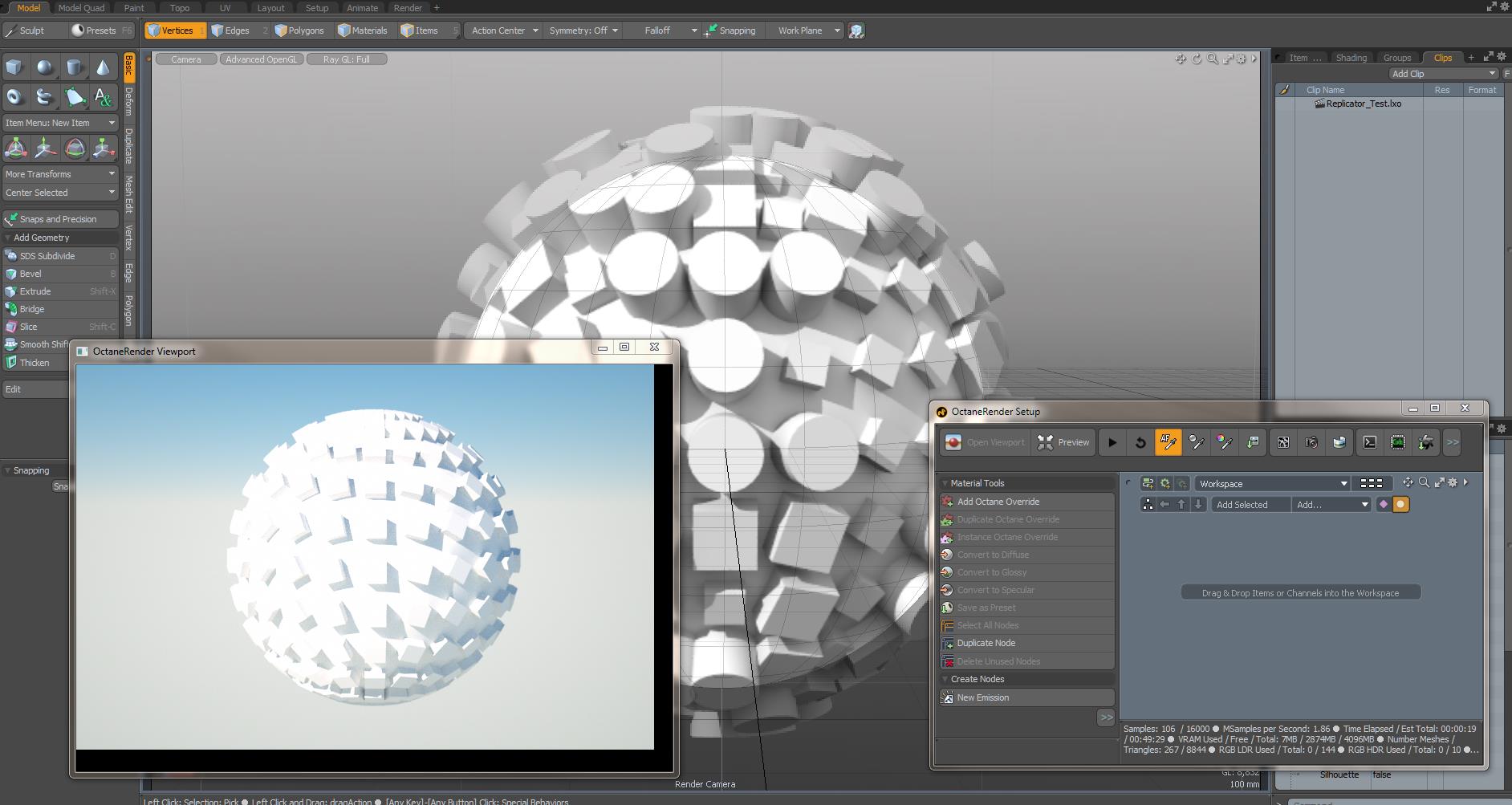

This scene instantly crashes Modo for me upon opening the Octane window: https://www.dropbox.com/s/7u265lls1ierz ... r_Test.lxo
Is it the same for anyone else?
It uses a replicator with a group as the replicator source. Is this supported? Even if it's not it shouldn't crash Modo. I noticed a few scenes crashing and they all had replicators set up like this so I made a very basic scene with a replicator to confirm this is an issue.
Edit: If unsure what I'm talking about scroll down to "Working with groups" on this page http://docs.luxology.com/modo/701/help/ ... ators.html

Seems to work for me, but I have the latest octane standalone, latest plugin for modo, I just deleted and recreated my modo701.cfg file because it got corrupted a couple days ago, AND I have Modo 7.01 SP5 (just came out a few days ago) also - on windows.Obizzz wrote:This scene instantly crashes Modo for me upon opening the Octane window: https://www.dropbox.com/s/7u265lls1ierz ... r_Test.lxo
I just noticed the scene isn't rendering the same in modo vs octane (cylinders are missing - everything is a cube of the same size.

Paul sent me a new version of the plugin in a PM earlier today so I'm probably not on the same version as you.
I did a test just like this one with the first version of the plugin and it gave the same result as you're getting here. No crash but it ignores the meshes in the group. I'm not sure when it broke though. Maybe it's something in the new version Paul sent me.
This scene is crashing because the Replicator Prototype is a Group, ad because the group is "Visible", the plugin is trying to add the locator transform to the Octane Scatter node transform list, but a Group does have a transform, so it's causing the crash. I will fix this in the next version. Also there is a change in the WIP test version that Obizzz is using to iterate all the child meshes if "Include Child Items" is ON for the replicator. In this situation, that is unchecked, and the plugin is interpreting the meshes within the "repl" group as child items, so not including them in the geometry. To my thinking, they ARE child items of the group, so they shouldn't render - but Modo thinks otherwise, so I will modify the plugin to cope with this situation.This scene instantly crashes Modo for me upon opening the Octane window: https://www.dropbox.com/s/7u265lls1ierz ... r_Test.lxo

Some more work on this - I'm not sure that Octane support the type of Replicator you have setup in that scene. Octane will scatter a single geometry object multiple times (by specifying a transform for each instance). In the scene you provided, the one Replicator is actually scattering 3 different geometry objects (2 x cylinder and a cube) - so by adding those 3 objects to the group, the replicator is selecting just one for each instance. However the plugin does know know which one (since that is not exposed in the Modo API). Perhaps it is selecting one of the three at random, or maybe in sequence. Regardless, Octane does not support scattering 3 different meshes from one set of transforms. So unfortunately, I don't think having a Replicator Prototype = a Group can be supported by the plugin.This scene instantly crashes Modo for me upon opening the Octane window: https://www.dropbox.com/s/7u265lls1ierz ... r_Test.lxo
Paul
