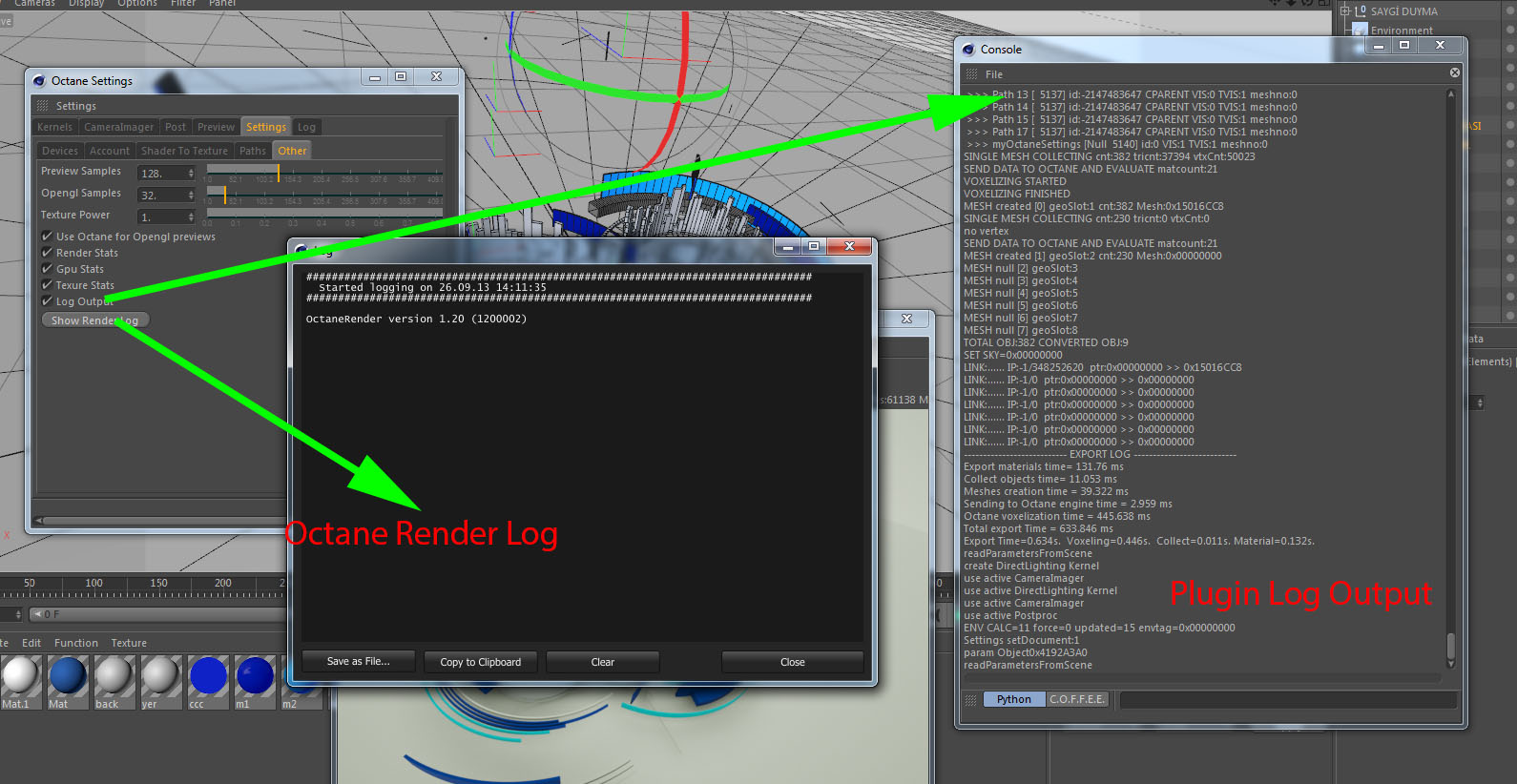

I want to do some explanation about this double frames. Octane rendering and c4d render procedures are working seperate threads. Plugin trying to detect the starting of a new frame. It wait until the frame finished, if detect render was started. If cannot detect start then gets finish message and use previous render buffer. So this is a synchronization problem as you see. But hangups seems little different. So i need some more info, like below:
Please check this two windows when you have any problems. But Log Output must be activated
