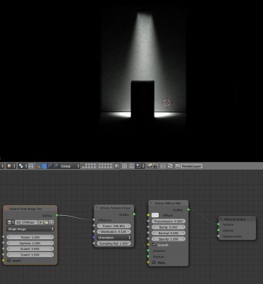

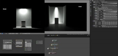

Hello,
I'am a new user with Octane Standalone and the Blender plugin.
I don't understand how to setup the nodes in Blender for IES lights.
The correct result is on the right side (Octane Standalone)
Is IES lights supported in blender plugin?

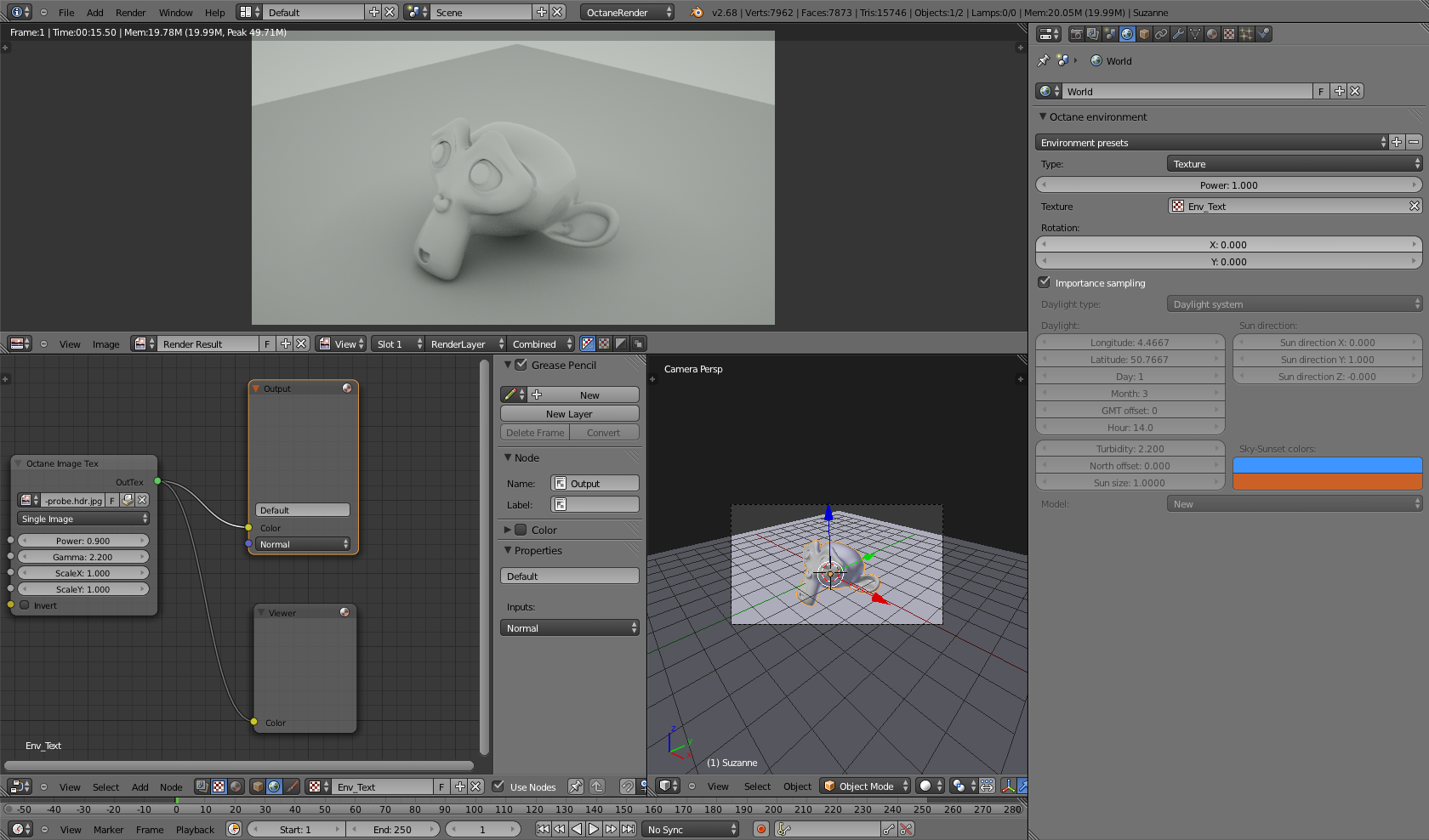

Thank you MIB.
Not working for me ... i tryed images, movies, patterns ... but cant see it in render!
Also the previews in the nodes doesn´t show anything. Would be good to have a working viewer to control settings.

Thank you MIB.
Here is a screenshot of what your file is looking on my computer.
I added a VIEWER in the node, just to check up if you image is packed ... i dont know :D ??
WIN7 64bit • 32GB DDR5 RAM • Intel i7 6x4GHz • GeForce GTX780 • Blender

dafassi
Posts: 110
Joined: Wed May 01, 2013 7:04 pm
Location: germany
ITS WORKING
I didn´t unpack the file.
With unpacking its okay - sorry :D!
Two issues:
1st - now, rendering an animation stops at frame 3 because octance server stops (always the same time). Using the normal sky-background its okay!
2nd - The preview in nodes does not work.

JimStar wrote:Ide
Thank you for report, I will check it.
@JimStar
My mistake. It works. A good manual would be nice.
You have done a very nice job with the plugin. The most confusing thing for me is the right way to setup materials.
I have some improvement suggestions.
1. Material export from Octane Standalone version to Blender. The preview system in Standalone is very nice. Blender lacks a good material preview.
2. Viewport color for objects would be nice. (hard to see if the objects are all the same color)
3. A Blend material file for exploring how to setup different material with nodes in Blender.
