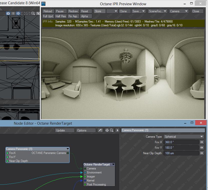

juanjgon
Posts: 8867
Location: Spain
New feature for the next release: the new panoramic camera, with spherical and cylindrical projections.
-Juanjo
