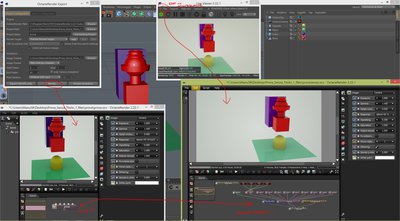

Hi Abstrax,
I have used odler export plugin 1.2b for several time and I have appreciated the possibility to update in real-time the scene in Standalone. I can work on C4D and use "Export obj/mtl only" when needed and update then the scene immediately on Standalone, with the two application opened. As you can see it works on R16 and OCR 2.22.1
Another interesting point is the semplicity of node graph, only one node... less node mean less confused area, expecially when there are very high number of different objects. You can add new objects, and than update the scene on OC Standalone.
I think the older Export plugin can be a valid alternative to C4D plugin developed by Aoktar, simple, but effective to change on the fly the scene. Rethink...
There are two problems to solve, a material will lose the texture when exported and also change from Glossy to Diffuse. The texture will be transformed on RGB color similar to the texture.
Please observe also that it seems that it use a different space color, may be srgb and not linear (see all windows on the picture)
augdalmo,
do you see the "mesh" on right image? It's samething as like that "prova" on left image. Collected geometry. Others are in special structure for real time interactions. You can delete rest of them.
