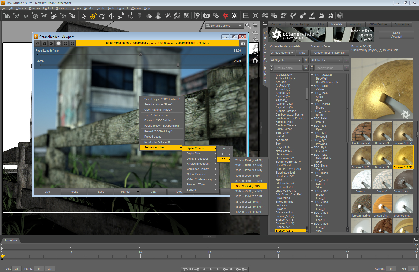

It's been awhile since anyone has posted any images. Got any teasers to wet our appetites? :)
Win8/64, I7-4770K (3.5Ghz) 24GB, GTX-980ti (6GB) / GTX-TITAN (6GB)
t_3
Posts: 2871
Sighman wrote:It's been awhile since anyone has posted any images. Got any teasers to wet our appetites? :)
if an ui screenshot would do, here is one:
what can be seen:
  • octane viewport pickers/tools; left of the progress bar, from left to right:
    - select object (plus filter materials in the corresponding plugin tab)
    - select surface/material (like in the standalone)
    - directly open the picked material in the nodegraph editor
    - focus (to the picked point - like in the standalone)
    - focus follow (lets the camera focus follow the picked object until another focus mode is set)
    - reload the picked object (useful if the live geometry mode is turned off; while tweaking poses/morphs)
    - picking into an empty area deselects elements (if any) and clears the materials filters
  • viewport context menu:
    - basically all the picker functions (plus affected objects/sufaces/mats labels)
    - back to autofocus & full scene reload (same as the buttons on the bottom)
    - switch between scale-to-viewport or current fixed render size
    - select a fixed render size from a list (as also found in the resolution node in the standalone)
  • camera controls:
    since fov and dof control is notably more important when using octane, it can get tedious to always open the parameters tab, select the camera, and open the parameter group, to finally tweak those settings, so there is a quick access to them (for the currently active camera) by clicking the camera tool button in the top-right corner (overlaying the viewport until hidden).
    note: the f/stop parameter from the daz camera is translated into the octane aperture value and vice versa.
also supported is the clay rendering mode from the standalone, and reduced size rendering (to speed up the viewport, called "subsampling" in the standalone)...
