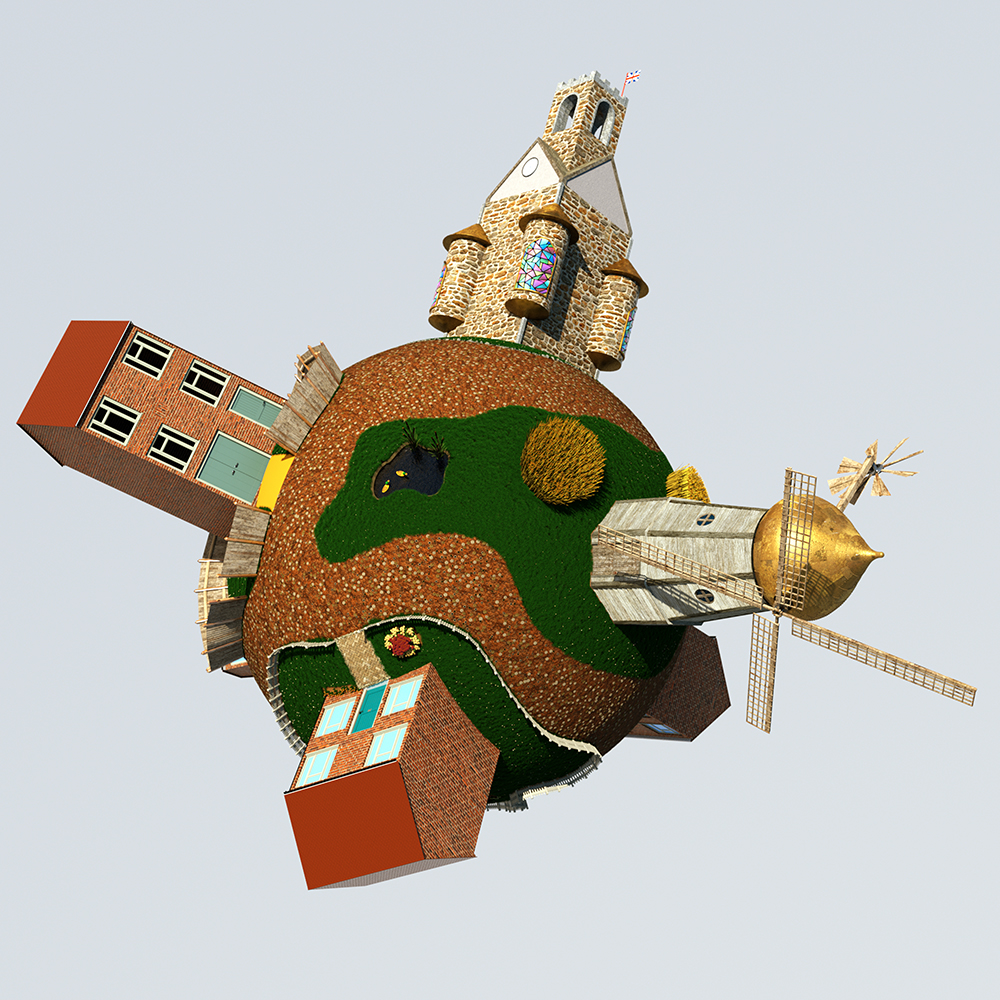

Just in case anyone was curious, this is what I am working on.

Nice, I'm glad it works :)
