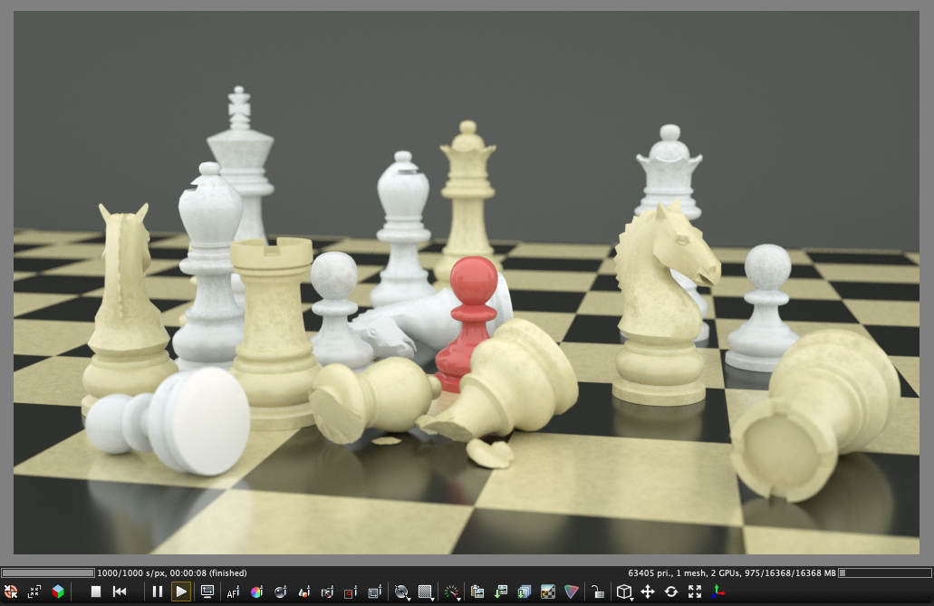

Hi again,
I just managed to add the Radeon PRO WX9100, chess scene has gone down to 8 secs. So I now have both the Radeon RX 6800XT (slot2) and Radeon PRO WX 9100 (slot1) This is the only physical placement option i have due to my motherboard size and PCIe layout.
The scene giving me errors doesn´t seem to crash the software or the computer so far, but it still giving render errors both in the log window and in the console.

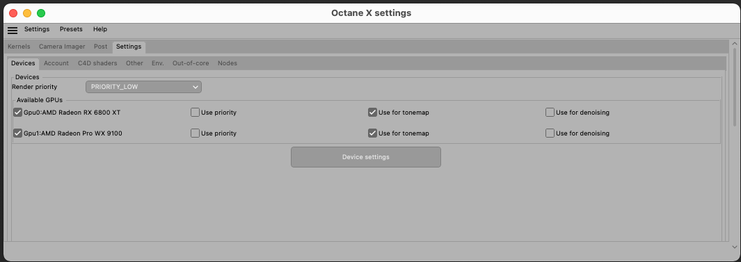

Are my prefs settings correct or is there something I should change regarding priority etc.?
ñgo
macOS 12.7.6 (21H1320)
AMD RX6800 XT + Radeon Pro XW 9100
Posts: 10446
about Devices panel, please enable the Priority option for the GPU connected to monitor.
Please also make sure to have upgraded macOs to 11.6.
From your screenshot, it seems that you are working with C4D R20 :roll:
If yes, please try with a newer version of C4D, like R21 or greater.
ciao Beppe

Actually I am on R21.
Priority low enabled now for the GPU connected to monitor.
