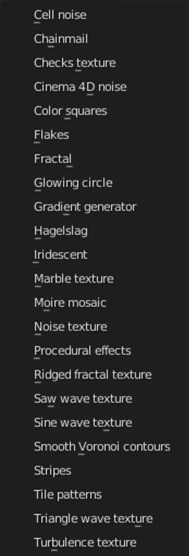

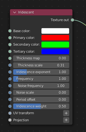

Hello, can you enable pins for iridicent texture as well as all new color textures?
I am talking about the base color pins to input textures
like this
for all these textures in octane 2022 as well as 2021

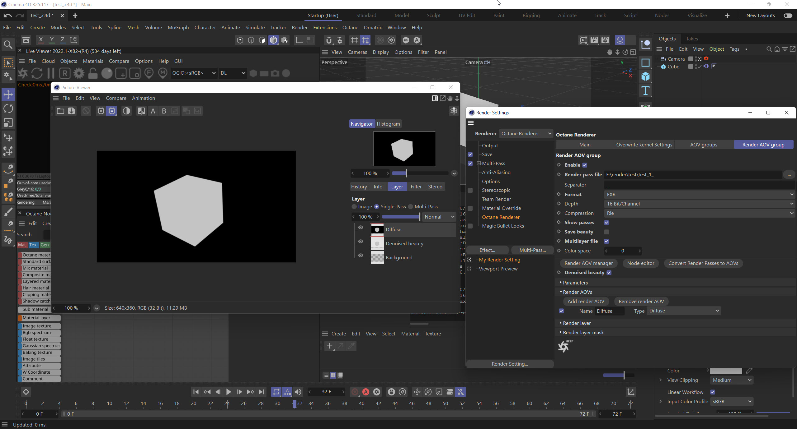

Same issue, can't save renders.
Tried switching to png, turning off multilayer file, turning off ACES, turning on/off denoiser, enabling beauty pass, changing save directorie - Nothing saves.
Basic setup attached.
test_.rar
(56.78 KiB) Downloaded 203 times

protokol wrote:Same issue, can't save renders.

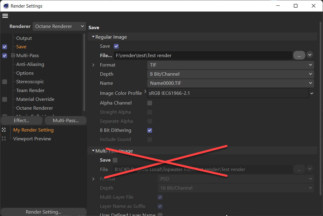

Same with who? Could you explain more what are trying to save? Main buffer or some render AOVs? You have "denoised beauty" selected but your saving selections are messed up.
Do not use C4D's render pass savings. Prefer to use Octane-EXR for Octane AOVs. I can save the main buffer by disabling C4D renderpasses saving section.

841131100 wrote:When I Enable Render AOV group,Image cannot be saved.
I'm trying to render out the main denoised buffer. What is messed up with my saving selections out of interest? When I open that same file with Octane 2021.1.5 (R5) it works normally and saves the render. When I switch to 2022 XB3 it won't save.

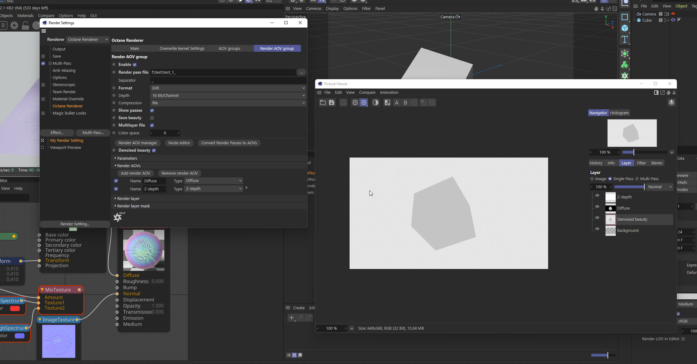

It's saving main render and also render AOVs if needs. See what I do

Thanks. Could you do me a favour and check the actual output directory to see if the EXR files are actually saving?
I can get files to render in picture viewer (and I have disabled cinema 4d saves, and disabled c4d multi-pass image etc etc) but it will not save the actual exr files to disk from the octane Render AOV Group tab. When I open the exact same file with 2021 it does save the EXR files.
I hope that is clearer.

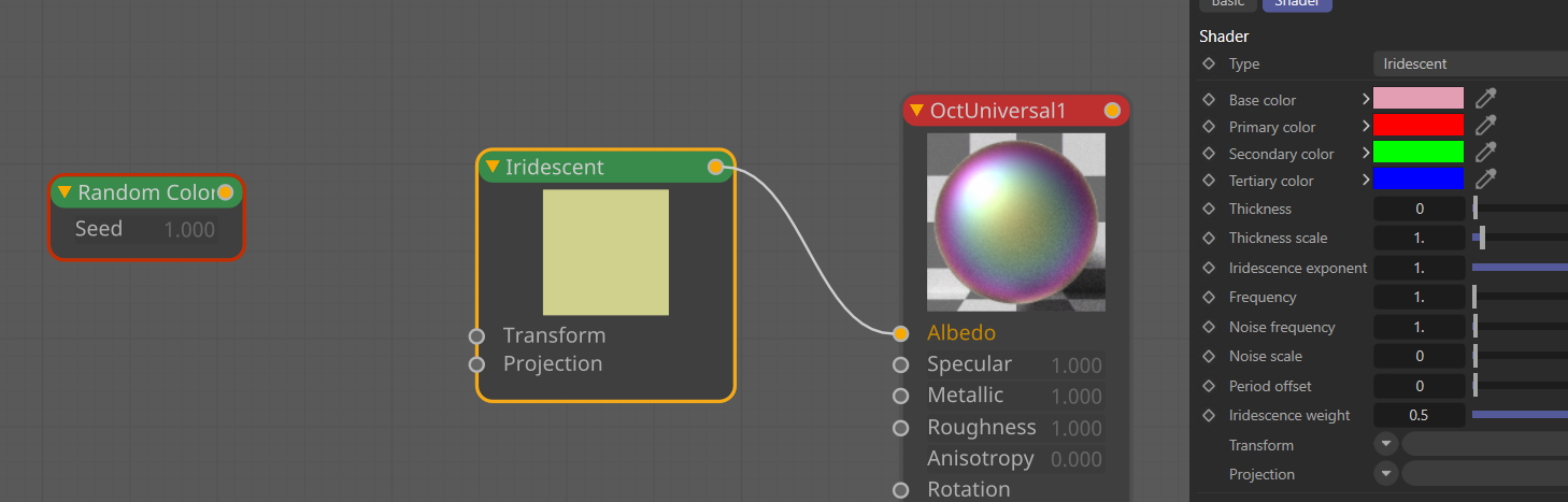

I want to add random color to the base color of the iridescent texture, currently it is not possible.
Would it be possible to implement this in the next update?
I'm checking for missing inputs for this texture and others.
Posts: 16068
Location: Türkiye
protokol wrote:Thanks. Could you do me a favour and check the actual output directory to see if the EXR files are actually saving?
It's working as you can see. I've imported the save files to Picture Viewer to check it.
