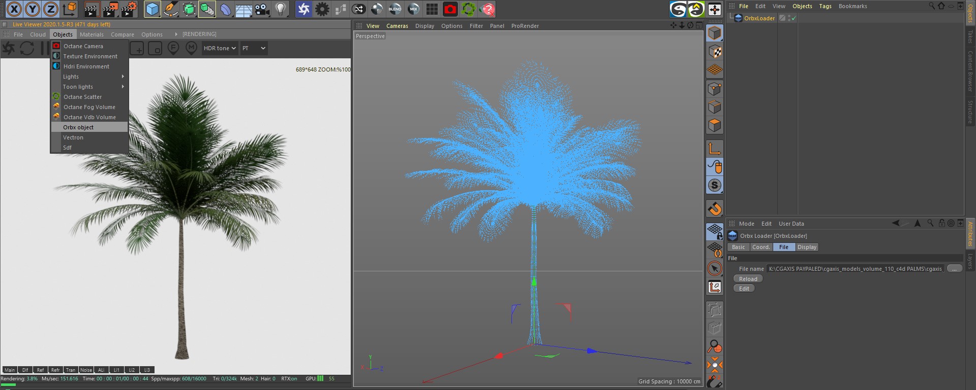

i remember one video with something like a proxy object sometime ago.
Is there anything like this in c4d? I m trying to import some heavy alembic/particles from houdini and looking for a solution where viewport wont crash.
Any ideas? thanks

Do you mean this .orbx object? Works very well, haven't tried any animated one though...thanulee wrote:i remember one video with something like a proxy object sometime ago.
Any ideas? thanks

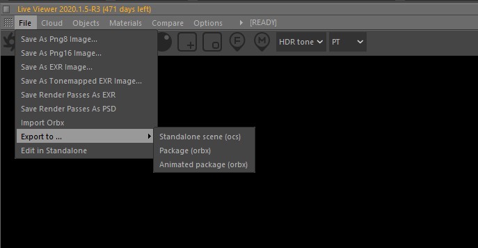

Thanks, any tut on how I use this?Kalua wrote:Do you mean this .orbx object? Works very well, haven't tried any animated one though...thanulee wrote:i remember one video with something like a proxy object sometime ago.

Nothing complicated: create your model with correct shaders, animate it with necessary. Then export it as .orbx package or animated package. Finally reimport the generated file using the .orbx proxy object... Need more details? Search youtube or the help documentation. That is all experience I have with it.thanulee wrote:Thanks, any tut on how I use this?Kalua wrote:Do you mean this .orbx object? Works very well, haven't tried any animated one though...thanulee wrote:i remember one video with something like a proxy object sometime ago.

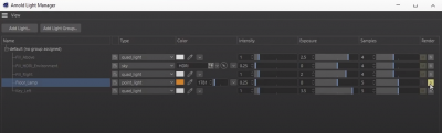

There are plans for multi-light in octane for C4d?divasoft wrote:Hi Ahmet, Before doing multi-light for future releases, please take a look at how it is done in arnold. Something like this would be very convenient for end users.

WHat do you mean? Of course: it is in 2020.2 XB2+ feature list. Why wouldn't it be at plugin's side?lukas8410 wrote:There are plans for multi-light in octane for C4d?divasoft wrote:Hi Ahmet, Before doing multi-light for future releases, please take a look at how it is done in arnold. Something like this would be very convenient for end users.
