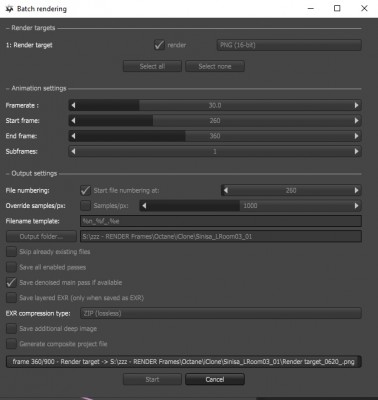

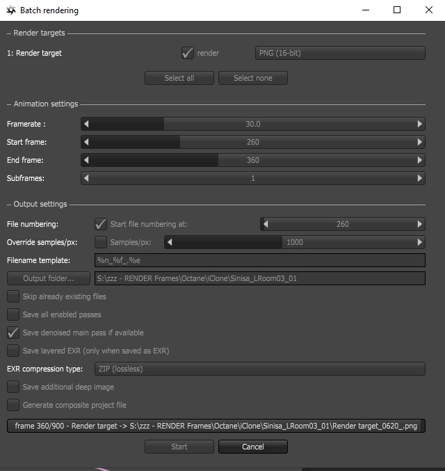

I rendered frames 1-900, and I wanted to re-do 260-360. So I did the following, thinking it would only render the 100 frames, but number them starting at 260, as opposed to 0:
But, so what does it then do!!!!?....it added my start frame of 260 to the file number start of 260...
260+260 = 520...
So it started at timeline-frame 260 and overwrote file number 520, and ended with timeline-frame 360 and overwrote file number 620.
You can see I screen captured right as it rendered the last frame as 620, but it was 260 to 360 on the frame timeline.
It overwrote completely the wrong 100 frames!
Shouldn't it start at 260, because that's where I told it to start at?

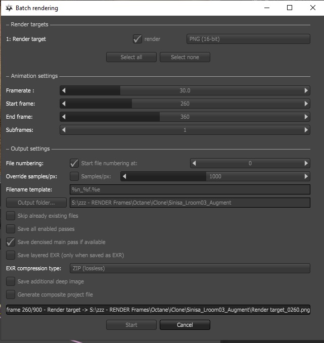

This is definitely a bug-
If I render starting at frame 260 and set file number of "0", it starts the file numbering at 260.
So, how then would I run timeline frames 260-360 with a file number start of "0" then...
Right!!!? you can't then
It should be that file number overrides frame number in file name.

Notiusweb wrote:This is definitely a bug-
If I understand correctly the file numbering field is interpreted for the whole animation. As an offset to the whole, in case you want to start numbering at 1 for example. So unless you have a very specific need it should always be set to 0 (or 1) and never touched after that. In your case just leave it at 0, tell the script to redo 260-360 and it should just work. In other words, don't touch that field after you set it initially, it describes the numbering scheme of the whole sequence.
Thanks jobigoud,
I re-ran the test that I did with a simple animation and the output frame numbers were not overridden with the new sequence. All I did was set the start frame to 20 and the end frame to 40, then I selected the "Start file numbering at:" and left the File numbering at 0. When I started the render the output file numbering started at 20, and looking at the code, it looks like the File numbering is ignored. So I was wrong in my initial thoughts, it does look like a bug. :?
Jason
