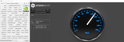

Is there a certain driver version I need to be using to get RTX enabled in the benchmark? I have 4x2080ti and am on the very latest version but benchmark isn't showing any cards as RTX. It's doing this on all three new 2080ti builds I've done that I'm trying to benchmark
Posts: 10507
you need a Nvidia driver greater than 435.80 under Windows.
Which driver have you installed?
Please, download and run GPU-Z:
https://www.techpowerup.com/gpuz/
And share a screenshot from the Graphics Card tab, for all the available Nvidia GPUs, thanks:
ciao Beppe

hey @bepe4d. Here is a screenshot of GPU-Z as well as octanebench showing no RTX option. I'm on driver 451.77. I"m running 2 2080ti in this specific machine (same exact cards and GPU-Z screen is identical for both) Is there a newer version of octanebench I should be downloading (this one says RTX at startup)? I remember having this same problem at the end of last year but can't recall what the issue was.

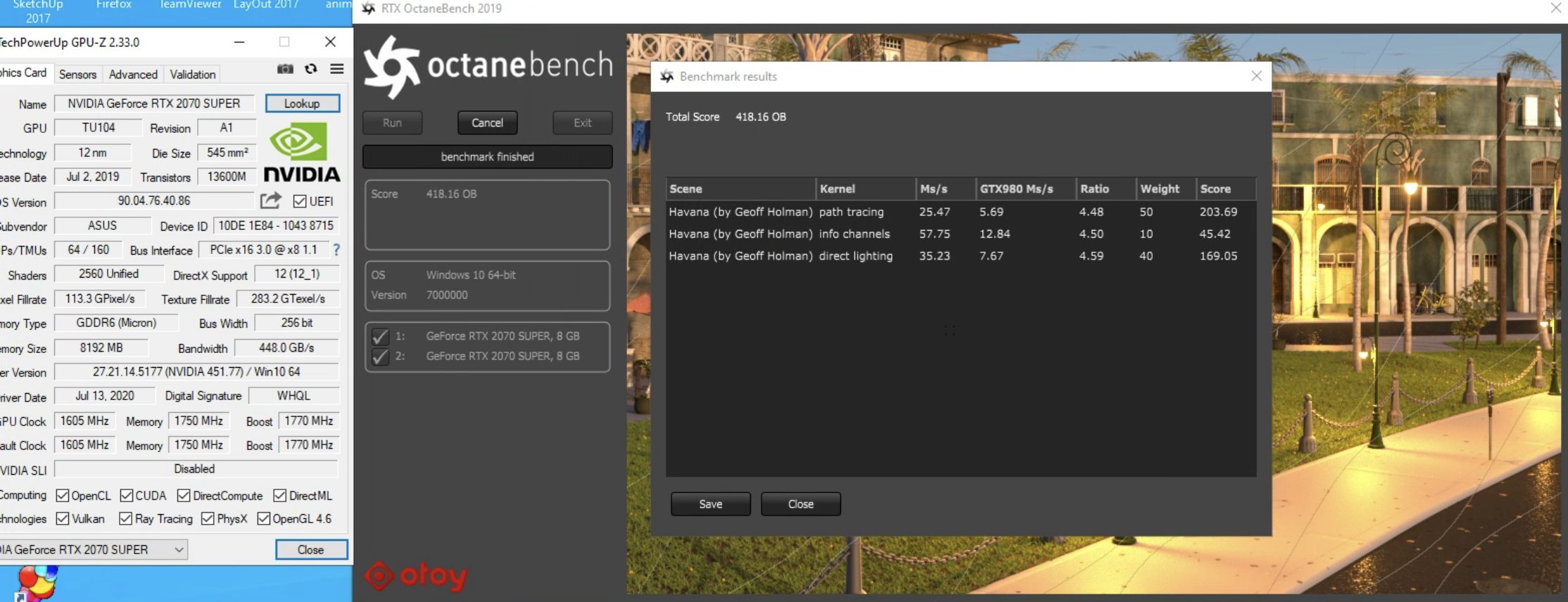

Posts: 10507
I have just tried, and it seems that OctaneBench RTX 2019 is not working anymore with recent Nvidia driver:
A lot of things have changed during this time, so we definitely need an updated version of Octanebench, but RTX acceleration is working correctly in 2020.1.4.

itsallgoode9
Posts: 896
Joined: Thu Apr 03, 2014 9:04 am
Location: New York City
well that would make sense why I couldn't get it to work in benchmark :lol: Hopefully OctaneBench will get updated soon. And yeah, RTX seems to work fine in the renderer itself
