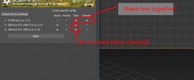

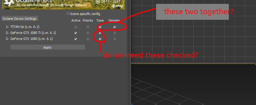

coilbook wrote:please fix gpu count for 3ds max RC4 it still shows too many GPUs even though I have 20
Also I have 1 card just for denoising. Do you count it as 1 of 20. If you do then it is not fair. We cannot use actual rendering card for denoising because vram is full and it always says that it doesn't have enough memory to denoise. There should be 20 cards for rendering and 1 more for denoising with free vram /.
If you've got a device that is only being used for denoising it is still being counted. So what exactly is your setup, how many GPUs are used on the slaves and the master for rendering and how many GPUs are used on the master for denoising?

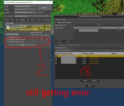

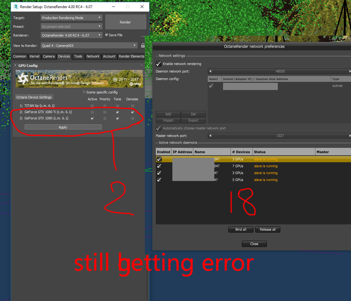

Hi
Even when I use total 20 GPUs where one of them is for denoising still getting an error too many GPUs. I attached the image. Thanks

Hi coilbook,
There is an issue in 3dsmax, for gpu settings common for all max scenes (when 'Scene specific config' is disabled).
The settings are not sent to Octane, unless you press 'Apply'. (you can check the actual status used by Octane with the button 'Octane Device Settings')
The work around is to enable 'Scene specific config'.
This will be fixed in the next release.

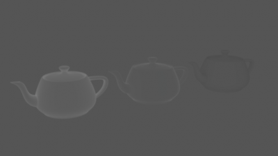

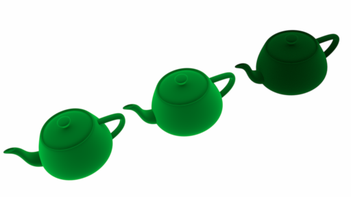

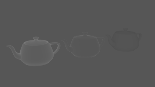

Sheen is a lot darker on the universal material compared to metallic and glossy materials

funk wrote:Sheen is a lot darker on the universal material compared to metallic and glossy materials
The attachment universal_dark_sheen.png is no longer available
Universal material is actually correct here as it has been renormalized to avoid energy gain, this will be fixed on both glossy and metallic material to match universal material in next version.
Cheers,
Wallace
left = glossy, middle = metallic, right = universal
So all my glossy mterials will look different in old scenes? :shock:
Not all, only when sheen is involved.

i have titan xp just for denoising and i am getting this denoiserThread2 : Not enough free memory to run the denoiser. Required memory 475501728.00 MB Why? it is 1080p image Thais is 475501 GB
UPDATE: This error happens when denoiser is checked by itself. For some reason tome mapping must be checked too. can otoy tell us if we need tone mapping checked on all cards or not? Thanks
abstrax
Posts: 5516
coilbook wrote:i have titan xp just for denoising and i am getting this denoiserThread2 : Not enough free memory to run the denoiser. Required memory 475501728.00 MB Why? it is 1080p image Thais is 475501 GB
That's probably a bug that will be fixed with the next release: When the denoiser gets enabled/disabled on a device, it leaks a whole bunch of resources.
Yes, usually you always want to enable tone-mapping. You may only want to disable it for GPUs that are attached via some PCIe extender - as long as you have at least 1 GPU enabled that is not connected via the PCIe bus. I.e. there needs to be at least one GPU that is enabled for tone-mapping.
