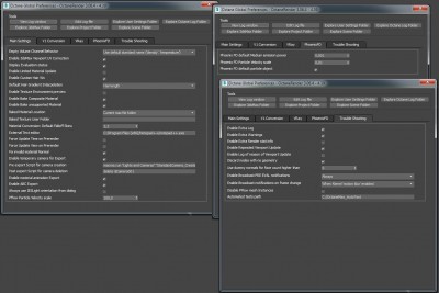

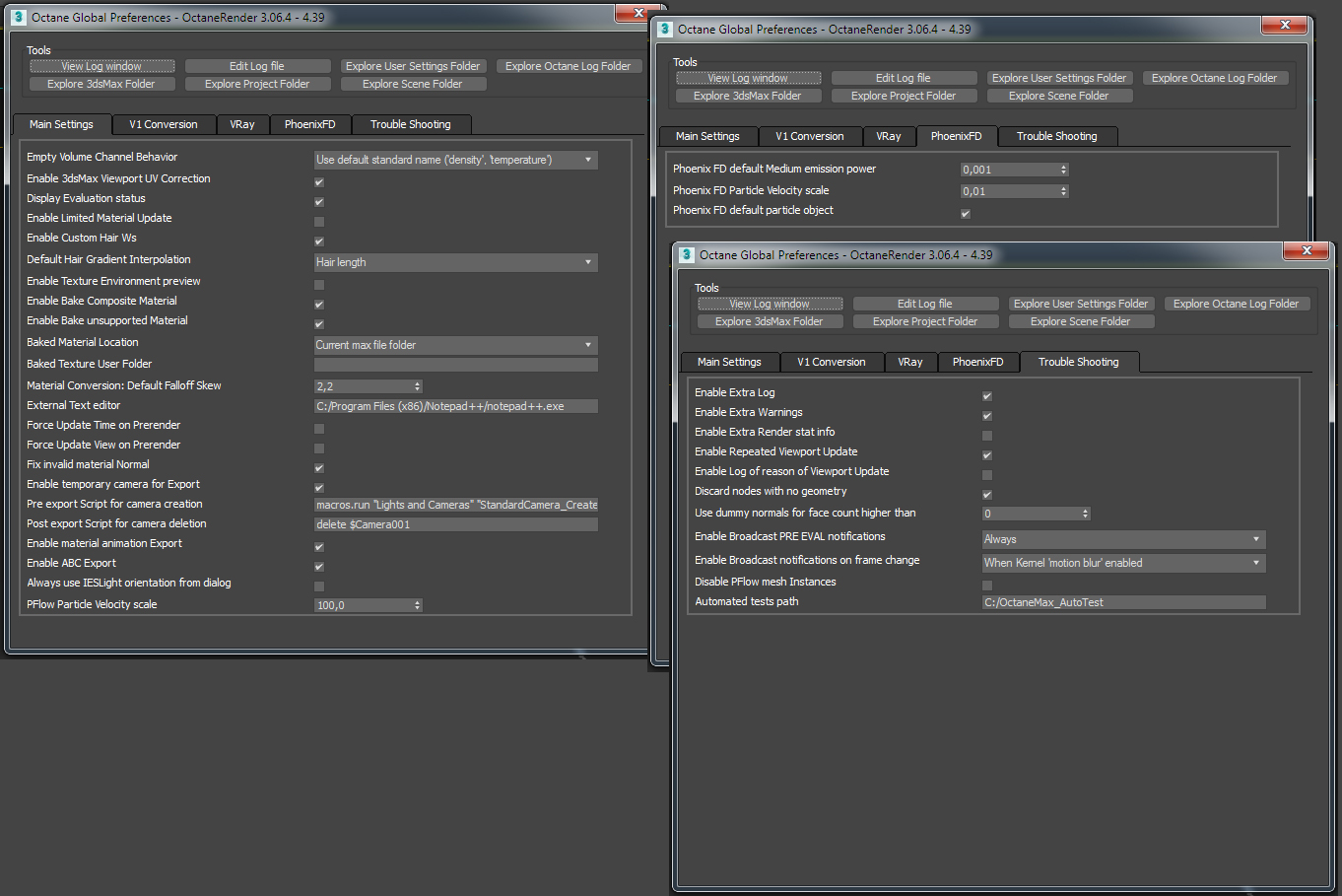

Could you kindly use the setting as in the screenshot?
Do you still have the issue?
Regards
Paride
