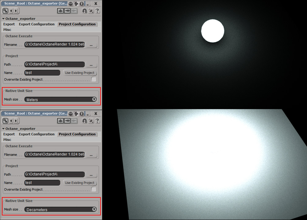

roeland wrote:
face wrote:Use an other import scaling so that the emitted meshes are bigger.
Edit:
If the mesh is bigger in its measurement, then it produce more emissions and the ilumination is brighter
This has changed in beta 2.45, the power settings now control the total amount of illumination coming from an emitter, independent from its size. To get a brighter image you can export the scene in a smaller size.
Thats not what i mean.
With mesh i mean the imported obj-file, also the whole scene.
Say the scene have 8x8meters and i export in meters, the scene is darker as i export the scene in decameters.
Thats the ex/import scaling.

grimm wrote:
face wrote: Use an other import scaling so that the emitted meshes are bigger.
Edit:
face
I guess where I getting confused is that it shouldn't matter how big the emitter is, and according to Marcus and Roeland emitter strength is no longer tied to mesh size. I should be able to make a ball the size of the sun, and make it emit as bright as the sun or brighter. Or make a 1cm size cube and have it as bright as the sun too. :?:
Thats what i mean...
