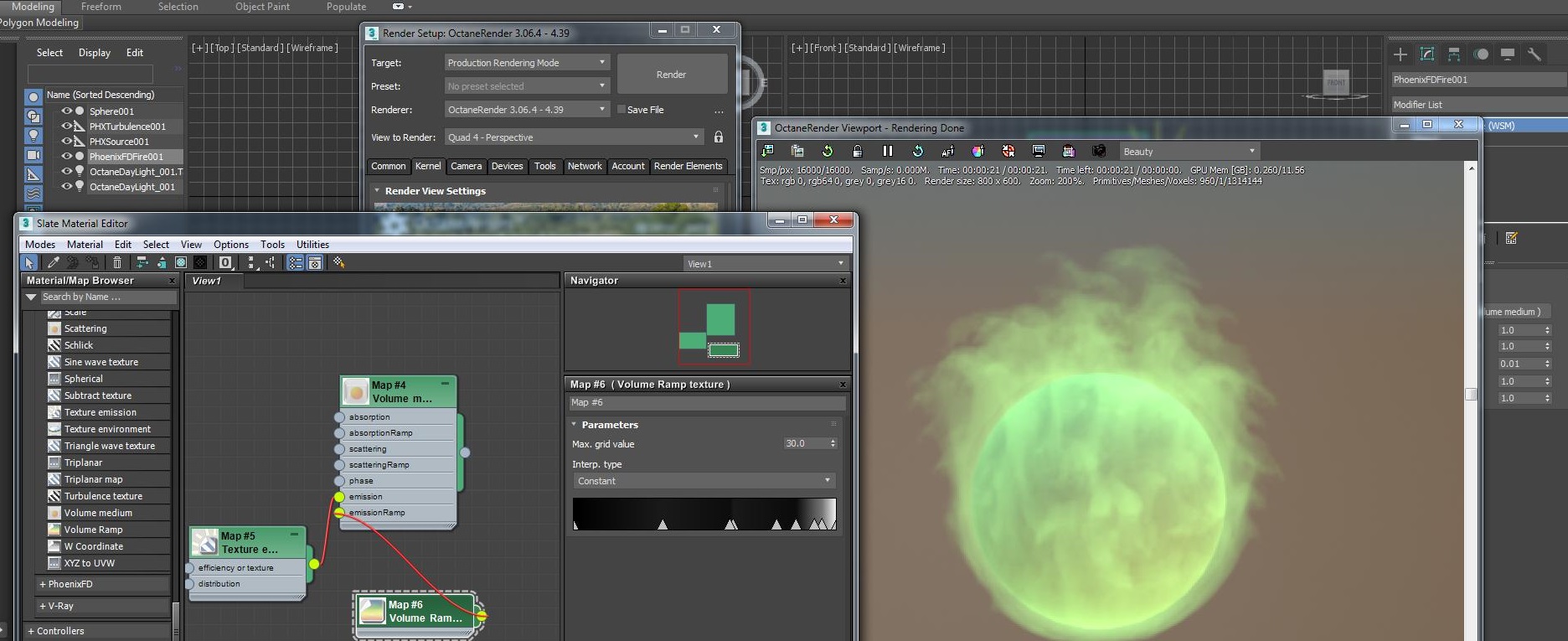

Coilbook, you did it!
That post referred to 'Max Grid Value', and that is the parameter you tweak and you see a difference.
Then when you move the little triangles on the ramp bar itself you can set thresholds for the flame vs the volume container's emission/visibility!....
To anyone new*, you have to:
-Assign a Volume Medium Map to the Octane Volume (WSM)
-access that Volume Medium (instance, ie 1, 2, 3, 4, etc.) in the Material editor in Max
-Double click on that to get the parameters for Emission and Emission Ramp. Set Emission as an Octane Texture Emission (for example), set Emission Ramp as an Octane Volume Ramp
-Look at Coilbook's post before this to see the other thread where they show the pic of the multicolored flame thing, and look at the settings outlined there. Special attention to the Max Grid Value and Volume Ramp
* I only add this because if you work in Daz, Sketchup, or C4D, you likely have no idea what you are doing in those plugins 50% the time. If Lightwave and Houdini, you have no idea 85% of the time...
But coming into this, where Max is usually pretty straight forward, you will have -0 (negative zero) % chance of knowing what the F$%* is going on with this Volume-Medium-Ramp-Grid-Emission-Scale stuff!...
Now I have to see how to ramp da colors...YES!

Now see that volume container/bounding box in scene can ultimately be adjusted in Standalone as well with further modification to Max Grid Value.
But, Coilbook, I actually wish there were MORE settings to mess with for fire!
Well, maybe saying I want more is obnoxious of me to say...
I'll try in future not to be so obviously obnoxious...
