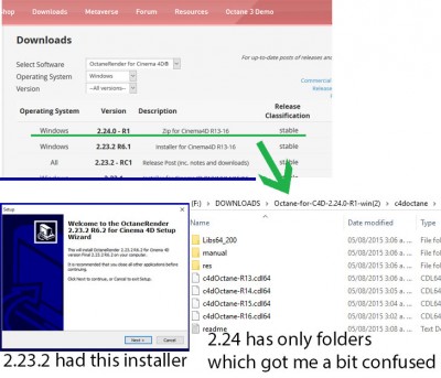

:( HI, I got confused with this latest download. I remember getting an installer before, but this time there is no installer in the zip file. Just 3 folders (res, manual, libs64) and 4 .cdl64 files for R-13-16.
How do you intall this on R17?
Also, the README says: "First remove all octane related stuff from plugins and main folder of Cinema4D."
But I think it should state what Octane files are in the Cinema4D main folder. An accidental delete there could render the app unusable.

rafaelvamp wrote::( HI, I got confused with this latest download. I remember getting an installer before, but this time there is no installer in the zip file. Just 3 folders (res, manual, libs64) and 4 .cdl64 files for R-13-16.
Which download is it that are you mentioning? From this topic? I never put an installer in release topics else of official releases in Otoy's download sections.
Yes, I´m talking about the one in downloads section. Maybe this image explains my confusion a bit better :)
Posts: 16066
Location: Türkiye
rafaelvamp wrote: Yes, I´m talking about the one in downloads section. Maybe this image explains my confusion a bit better :)
Ok. I don't setup this part. Shall be a mistake. But manually you can delete old c4dOctane directory and put this content to same place. That's simple. And remove unnecessary versions of plugin as described in "readme.txt".
I'm working for a official R17 version, atm you can try R16 version. I'm not sure how stable.
Ok, will do. Many thanks!
