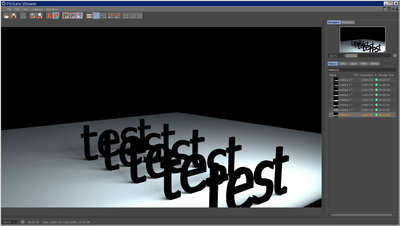

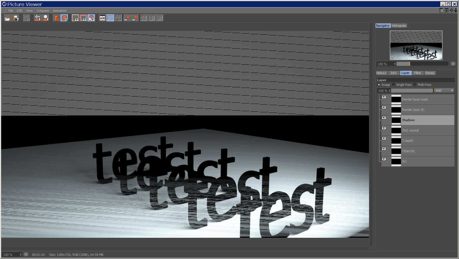

same problem here with and without render farm.
with the render farm
without
abstrax
Posts: 5516
eightvfx wrote:same problem here with and without render farm.
without
Again, what's the configuration on your master and especially on your slaves? I.e. OS and GPUs? Could you please send me the scene? Thanks.
