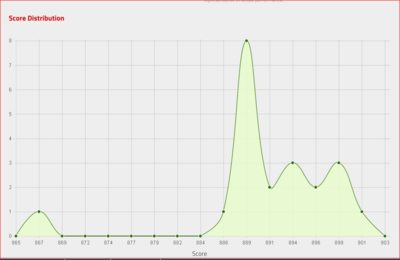

It's two, two, two tools in one: an excellent benchmarking tool and an excellent assist tool for goal oriented GPU tweaking. Just as the best tool to assist in tweaking CPUs to handle Cinema4d CPU rendering speedily is Cinebench, the best tool to assist in tweaking GPUs to handle Octane GPU rendering speedily is now OctaneBench. Octanebench will help my system to peak again further to the right and simultaneously help me to establish overclock presets for various rendering tasks. Compare this - live in development - [ https://render.otoy.com/octanebench/sum ... GTX+780+Ti ] with Score Distribution pic, below - first large hump is where my system's performance had stalled before I had realized that there could be other uses to OctaneBench; lower humps to right is where OctaneBench's assistance came into play during tweaking of this air-cooled GPU system. Now, my ultimate goal is to get an OctaneBench score of, at least, 960 (or about 120 pts per 780 Ti ACX SC OC) on this system, while keeping all GPU temperatures below 85 degrees (C); my interim goal is to get a score of, at least, 912 (or about 114 per GPU).
Because I have 180+ GPU processers in 16 tweaked/multiOS systems - Character limit prevents detailed stats.

Tutor,
The results you've posted are indeed impressive, especially these are air-cooled cards. According my calculations 8x780Ti may score around 1060 (watercooled) on stock bios. My GTX 780 6GB which has 2304 cores - scores 106 (1340 Mhz on core and 7000 MHz on memory). Hence a 780 Ti with 2880 cores has 25% more of computing power giving 1.25*106=132.5. Such results require overclock over 1300mhz and I am not sure how well the stock fan would cope up with heat dissipation. Hope to see you breaking 1000 score limit. Good luck ;)
BTW I managed to get 0.044375 score per core on a 9600 cored system (0.046 for a single 780).
