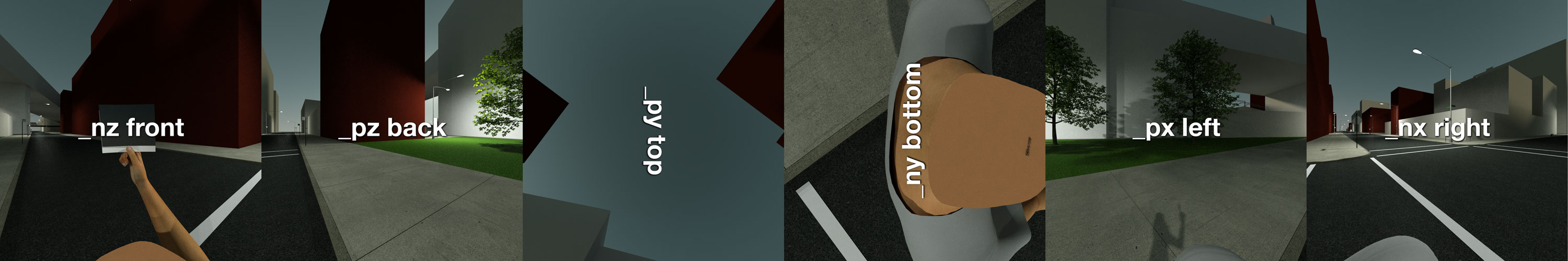

The Otoy GearVR app will be the way to go, but until then this may work:
for each eye
cut the octane cube-map into 6 cubes
rotate the top -90
and bottom 90
rename, see attached horizontal strip cube map with labels
dump into the GearVR image viewer
so you should end up with 6 or 12 (stereo) image files
it's quite easy to have script to automate the process.

for each eye
rotate the top -90
and bottom 90
