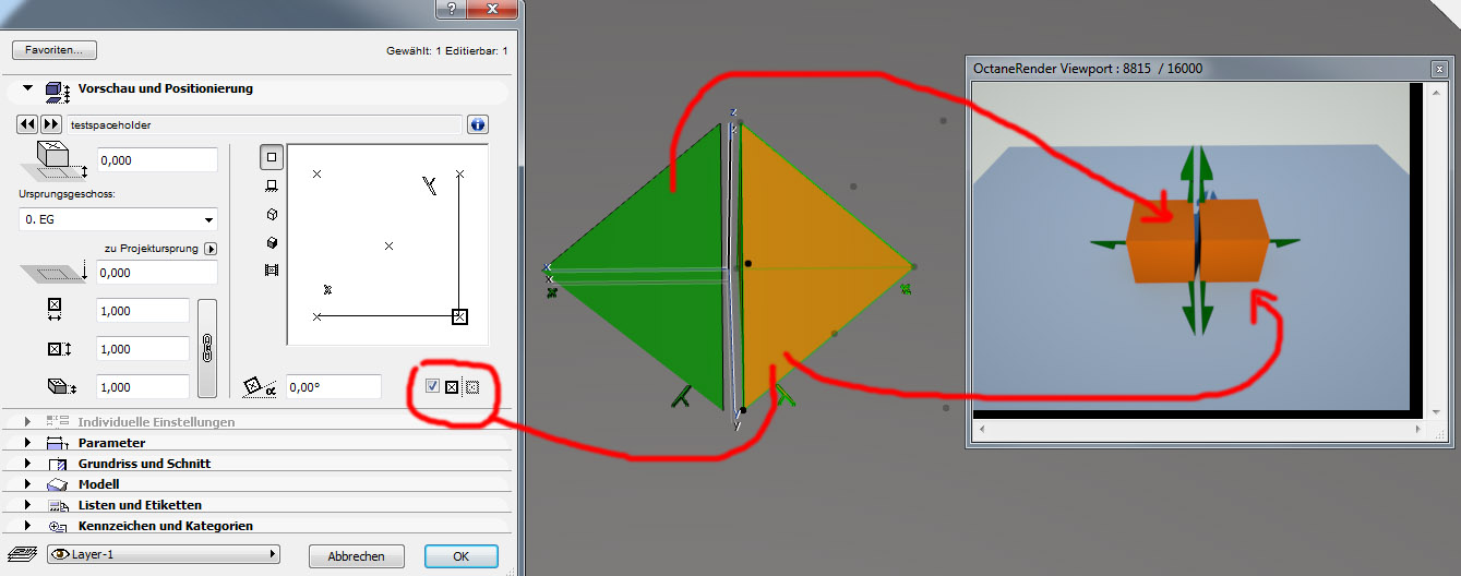

The Proxies can follow all of the transportation-operations in AC. You can rotate, and you can lift them. The only thing doesn´t work is the mirroring.
Look at this:

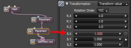

The orange AC-Object is the mirroring of the green one. I should set two different OCS/OBRX to get the same result in Octane (with different placement, see the next pic).
Perhaps there is a solution to get rid of duplicated files and libraries:

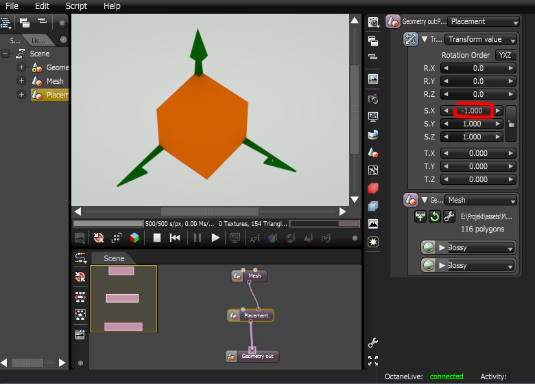

- The Plugin checks if the SYMB_MIRRORED value true or false.
- If it´s false, than the sun is shining.
- If it´s true, than set a placement with S.X: -1.000. If a placement exists, than it should be an additional placement. I have checked, the AC didn´t have any problems with that.
Is it possible? Than you have solved all positioning issues in AC.
I will see if this can be added in the next release.

I have refreshed the installers at the top of this thread with:
2.23.2.49
- Various changes to the "Missing File" search dialog. The title of the Folder Selection dialog displays the missing filename
- Proxy host Objects with "Mirror Library Part" ticked will now be flipped in the X axis (ie. the X Scale will be multipled by -1)
