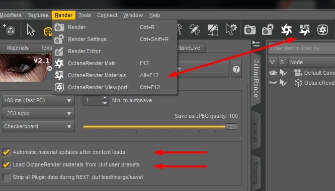

Is the checkbox under preferences for auto converting mats checked? There should also be an Octane icon somewhere in your main toolbar with either "man," "duf," or "auto" above it. Clicking this icon alternates between these three modes. if you want auto conversion, this needs to read auto. This icon selects these options in the preferences tab, so if you don't have the icon, manually check those boxes.

Thanks! yeah apparently they were uncheck somehow.

Zenrel wrote:While I was working on a scene, my nodegraph editor got stuck on top of the screen somehow where I cant even grab the taskbar of it anymore. When I close it down, it gave me a fatal error. Even if I restart Daz Studio it's still stuck, so I disabled and enabled the plugin to get rid of it and it worked and the fatal error stopped. And now a major issue, now everything I put on the scene doesn't auto material now so I have to manually do it. I even reinstall the plugin and still hasn't fixed the problem. Anyone knows what's going on?
you should take a look at these:
probably the saved settings got messed up when the crash occured.
(clicking the icon cycles three states of the two checkboxes: both checked, both unchecked or .duf loading checked)
