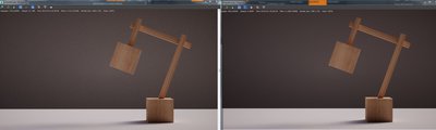

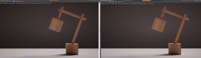

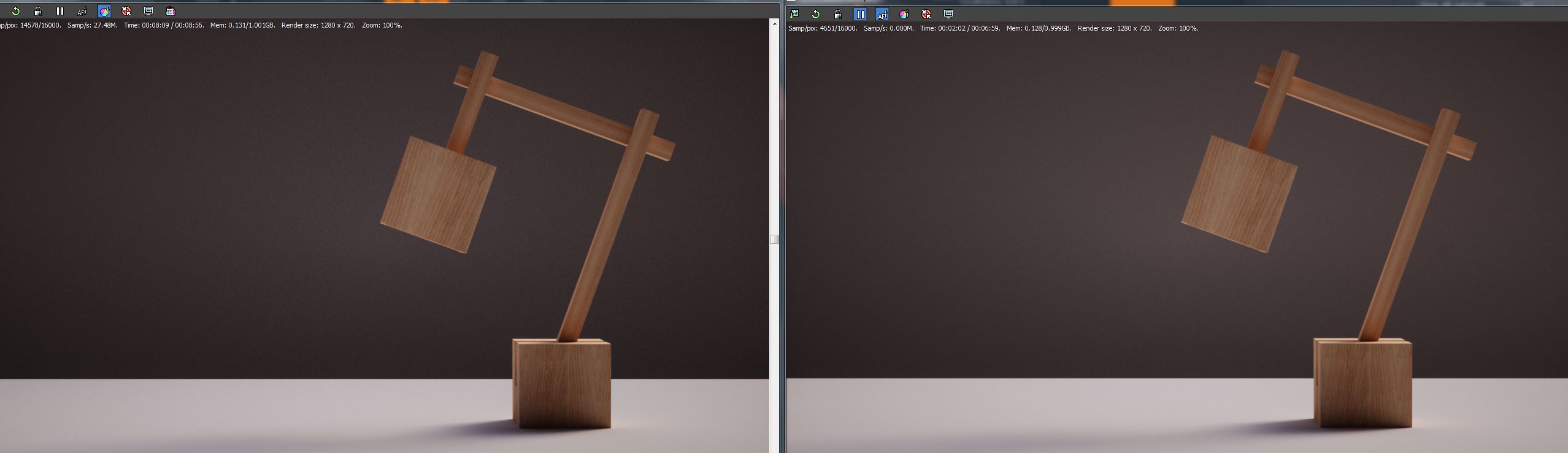

V2.04 vs V1.18
the one on the right is V1.18 after 2 minutes rendering - v1.18 99% clean, v.204 half way
after about 9 minutes v2.04 it comes close to v1.18 - and HDRi moved for some reason.. well OK - I manualy rotated it to place.. everything was at 0..
- in this case - v2.04 is almost 400% slower ..
- OK I understand a slight increase, 20% wouldn't be noticable, this is rediculus.. I'm going back to the old kernel I guess, unless I really really need the new features
- what the..
- now I would only wish, the old kernel to work in max 2015
- also either octane 2.04 or max 2015 is very unstable! - a lot of crashes, sometimes silent crashes - on simple scenes - not sure what is the problem there - but it is almost unusable
EIDT- bugs definetely related to octane rendering - definitely check it out in max 2015

Lighting doesn't look the same. So the scene is not the same. You can't compare.acc24ex wrote:V2.04 vs V1.18
- what the..
- crashes whenever octane is rendering and this:disabling/enabling a gpu, addind/removing a modifier in an object that is also a movable proxy
2.x is about 15-20% slower, not 400.
But to be sure, please send me a scene (with hdr image)
Regarding stability - I will release a new version 2.05 today, there I have fixed several crashes.
