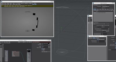

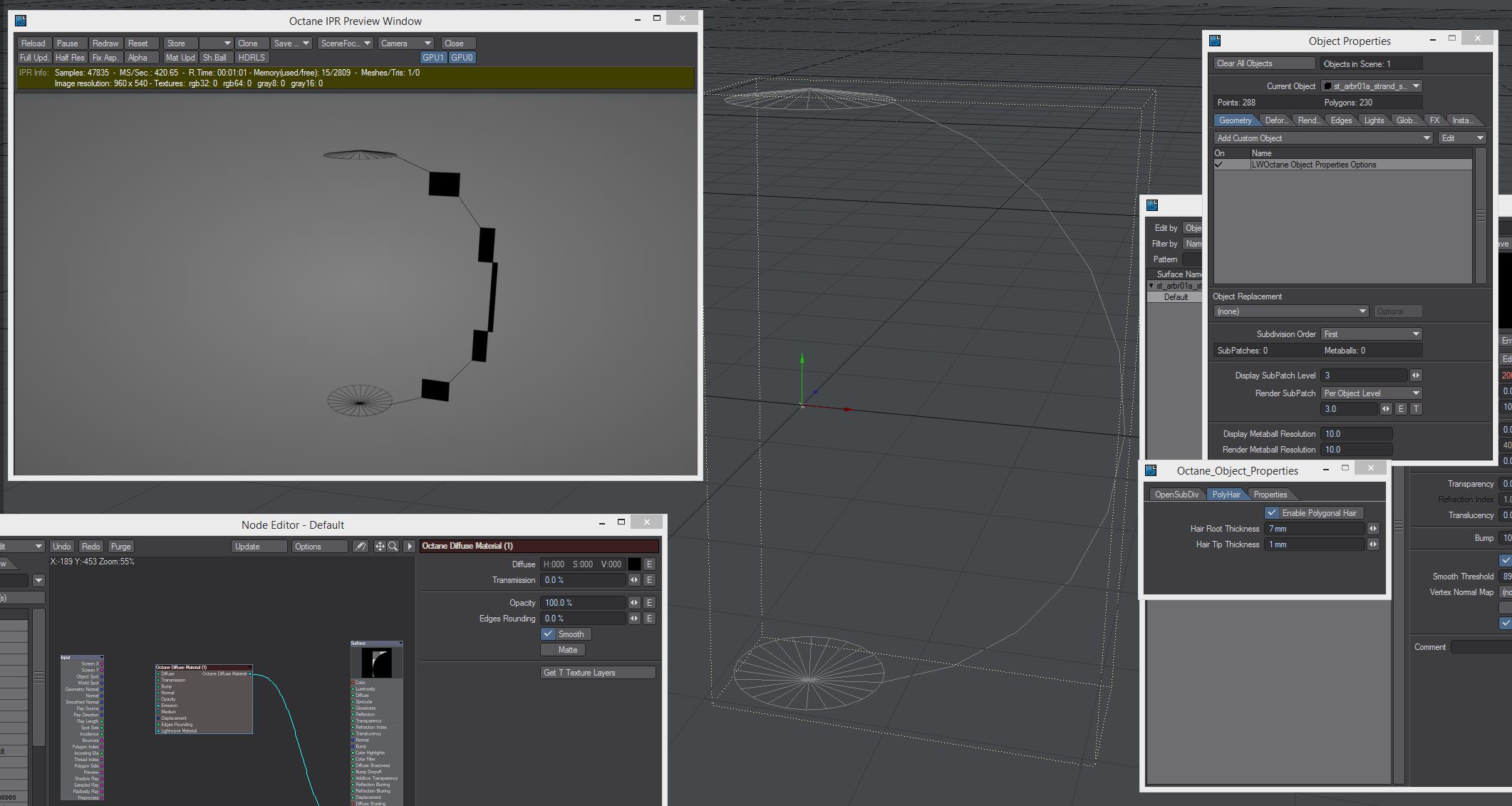

I encounter a problem when using the very nice 2-point-polys rendering feature for wire-mesh rendering.
On the attached scene, the poly objects was transformed in 2-point-polys object with strand maker: it generates these dark spots when rendering with octane ( version DAYLY 04/07 )...
note that normally, this process doesn't generate any problem... perhaps the cause is the geometry structure ? but i cant see why
bug_wire.zip
(8.2 KiB) Downloaded 240 times
BorisGoreta
Posts: 1424
Joined: Fri Dec 07, 2012 6:45 pm
I had this black squares too, they are caused by 0 length fibers so make sure you don't generate those.
Or if it is not that then check the angles between adjacent 2 point polygons, they should close an angle greater then 90 degrees, otherwise the render cylinder brakes.
vipvip
Posts: 726
Joined: Fri Apr 22, 2011 9:28 am
ok thanks Boris
**EDIT**: and Juanjo !

juanjgon
Posts: 8867
Location: Spain
Yes, you have a lot of duplicated vertex ... try to merge them and remove the one point polygons.
-Juanjo

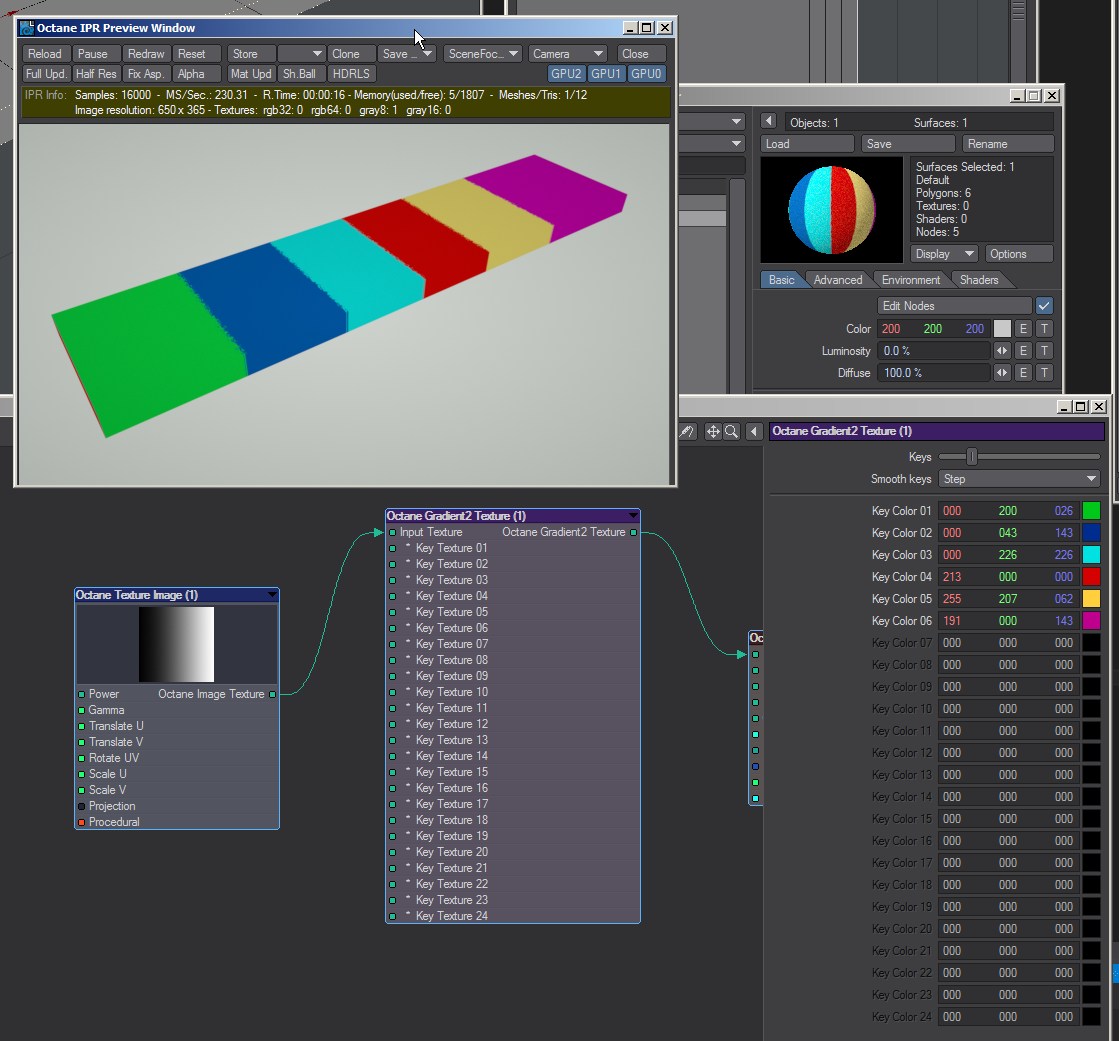

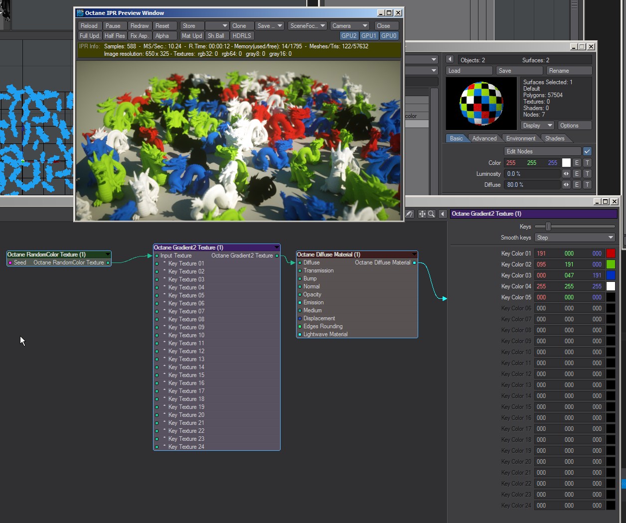

How can we have stepped transitions in Octane Gradient Texture node ? I would like to have 3 specific colors distributed over instances but not the colors in between.
juanjgon
Posts: 8867
Location: Spain
BorisGoreta wrote:How can we have stepped transitions in Octane Gradient Texture node ? I would like to have 3 specific colors distributed over instances but not the colors in between.
Yes, in the next plugin release, in few days ;)
-Juanjo
