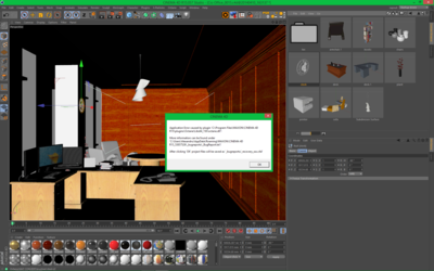

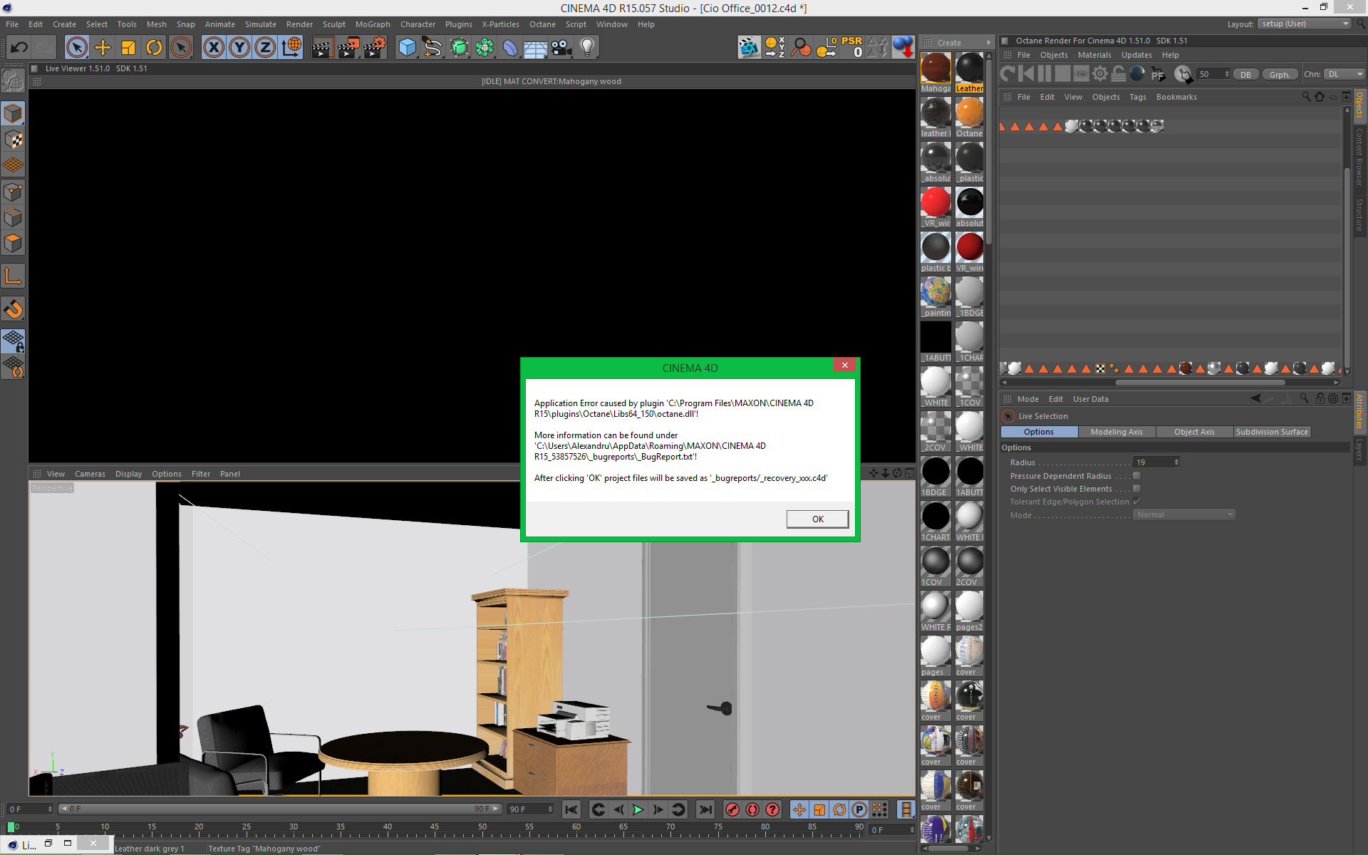

Hello aoktar, it keeps crashing and i am getting the same error when doing random stuff, like copy/pasting objects or textures, or sometimes just navigating the viewport. It doesn't seem to happen when i do something in particular. It's not a texture or objects, because after i reload the scene, i use the same objects and textures and this time it doesn't crash. Does anyone else get these errors, or is it just me?
Cheers,
Alex
Cheers,
Alex
i7 4770k, GTX780, 16gb ddr

Hi Pavel,
i think you get soo much crashes, it's not normal. Can you post some additional info? this is not usefull. I need some bugreport.zip when you get it. If you get crash go and get bugreport.zip, and pls send me a few different bugreport.zip. Also pls attach a few words when you get it.
Btw, did you installed standalone with installer exe?
