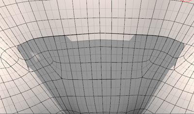

Looks like in the attached file (hope it's modest enoughtt_3 wrote:with "even in the viewport" you mean the daz viewport? that would be pretty strange, as of course the plugin only reads information from daz elements and doesn't alter them (apart a few places like aspect ratio settings)...
*EDIT*
Did a complete reinstall of DAZ+plugin, and it works again. Chalk this one up to me pressing a wrong button somewhere or DAZ being weird
