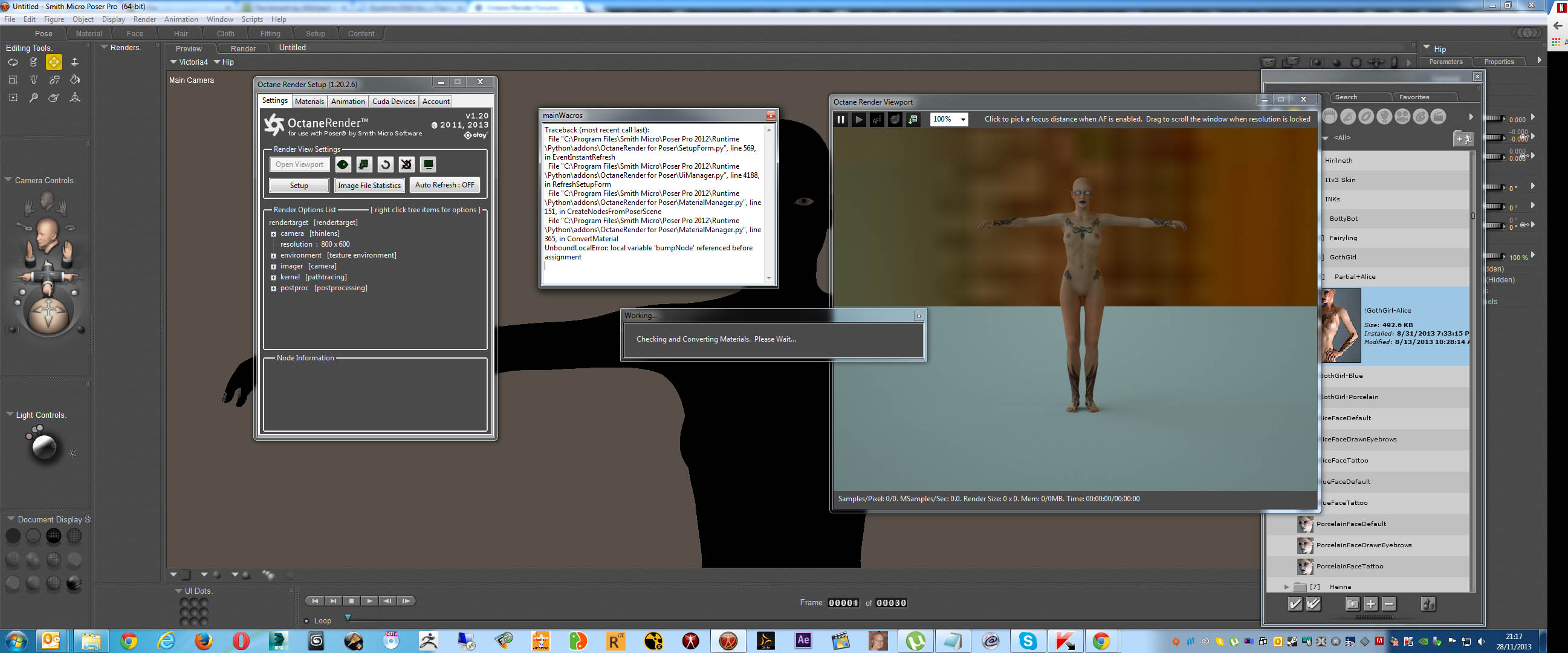

getting this error message after i upgraded to sp3 on poser pro 2014 and running 120.6 version octaine render
Traceback (most recent call last):
File "C:\Program Files\Smith Micro\Poser Pro 2012\Runtime\Python\addons\OctaneRender for Poser\__init__.py", line 73, in Render
File "C:\Program Files\Smith Micro\Poser Pro 2012\Runtime\Python\addons\OctaneRender for Poser\UiManager.py", line 4036, in ShowSetupForm
File "C:\Program Files\Smith Micro\Poser Pro 2012\Runtime\Python\addons\OctaneRender for Poser\MaterialManager.py", line 151, in CreateNodesFromPoserScene
File "C:\Program Files\Smith Micro\Poser Pro 2012\Runtime\Python\addons\OctaneRender for Poser\MaterialManager.py", line 365, in ConvertMaterial
UnboundLocalError: local variable 'bumpNode' referenced before assignment
W7 64 bit |I7-3970X | GTX 780 X2(6GB) GTX 780TI X2 | 64 GB DDR3 RAM
The latest version rectifies this error (1.20.2.7).
