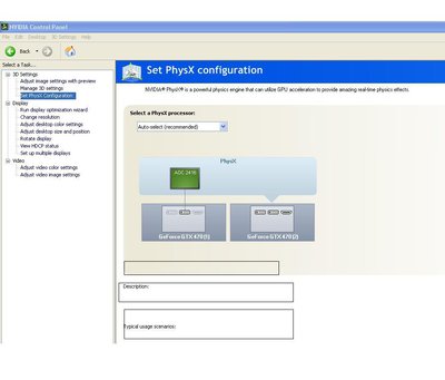

merid888 wrote:hi karba, i cannot open the viewport octanerender into 3ds max, i have driver installed 310.90, using right now 2 gtx470, windows xp64 bits, add image and file .rar, 3ds max 2013 x64 and octanerender for max 1.02, standalone 1.03
Please check your licence activation.

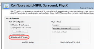

What is your multiple GPU nvidia setting? multi-GPU mode should be disable.

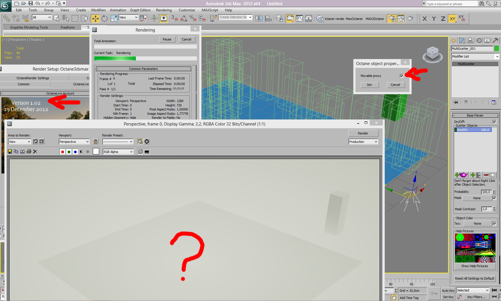

marcio_max wrote:Multiscatter is no working!!! Fix this, please! :o
It works :roll:

second point, multiple GPU nvidia setting? where is this option in panel control nvidia ?

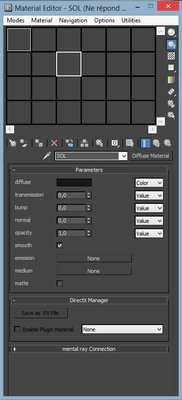

I have a big problem with this version... when i open the material editor, the materials dont appear... and i have to restart max because it crash...
I use max 2012, i'm on windows 8 pro 64 bits, i have a gforce 580 gtx (1.5Go) and i have installed the latest version of the nvidia drivers (310.90).
Same problem with the 1.01.
With the 1.0 RC3, no problem.
Do you have a solution ?

For me not works!!!
I'm using Windows 8 Pro x64
*** Problem solved! Just upgraded to the version of Multiscatter 1.1.09D and now everything works!

hi karba, thank you, my control panel is different, i use driver to windows xp64 bits
i'll explore my control panel and i'll try to find that option

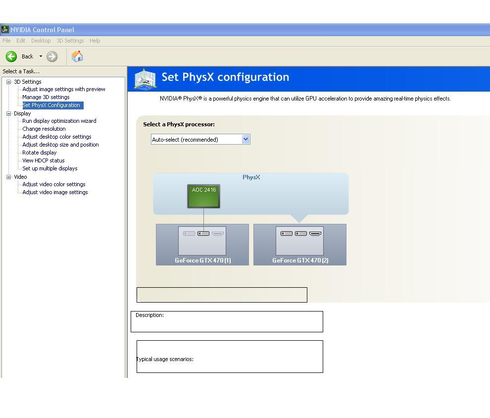

add image, none option like your image desable sli, why ? is the last driver 310.90
