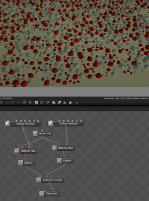

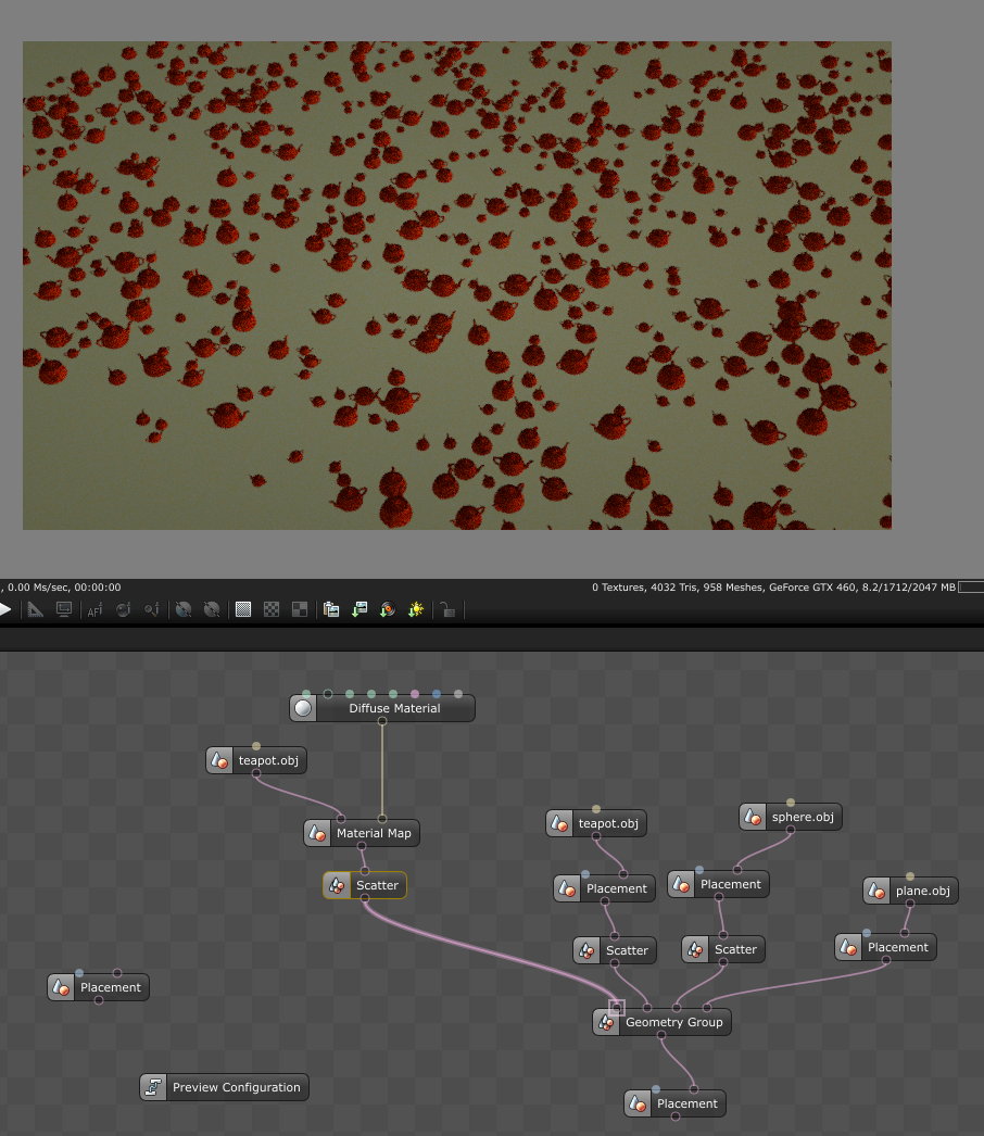

RayTracey wrote: [*]Material mapping node: creates an instance of a mesh with some materials replaced.[/list]
How does this work? If I put a material map node as in the below screenshot (scatter example file), the whole scatter group gets the material replaced, ie. the same as if I would plug the material in the "teapot.obj" node. Is there a way to replace the material to some of the instances in the scatter group, or am I misunderstanding this?
Also, the scatter example file crashes (Octane stays open and functional, but it wont restart rendering) a lot on my system with output like this:
Code: Select all
CUDA device 0: KERNEL FAILED!!!
CUDA device 0: Not enough memory to allocate buffer of 193536 bytes for texture 5
CUDA device 0: Not enough memory to allocate buffer of 136 bytes for texture 19
There are no textures involved and as you can see in the above screenshot, there is plenty of GPU memory left.

matej wrote:Is there a way to replace the material to some of the instances in the scatter group, or am I misunderstanding this?
I don't believe so. My understanding is that if you want to use the same mesh with two separate materials, then you will need to create two scatter nodes and give each node a different material.
That is exactly what is happening in the scatter example file that is provided. You will notice that in your screenshot, there are two nodes that use the teapot.obj mesh file. One of the teapot mesh nodes uses one material and the other teapot mesh node uses another material.
