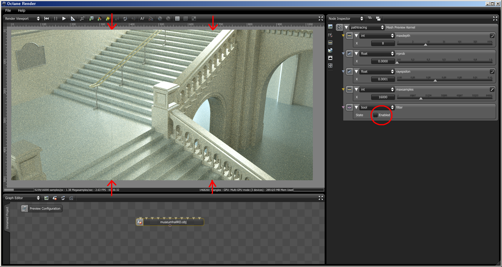

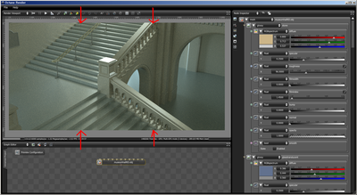

well may as well post some feedback.
1.sometimes on loading a mesh I'm getting vertical bars over the entire viewport of the image and black 50/50 about 3mm wide - *usually* goes away if I change to pathtracing and back.
if I use an hdr for background with pathtracing it produces the bars all the time but only on the actual model. directlighting is fine but is showing subtle triangular faceting of smoothed faces not present in other combinations.
