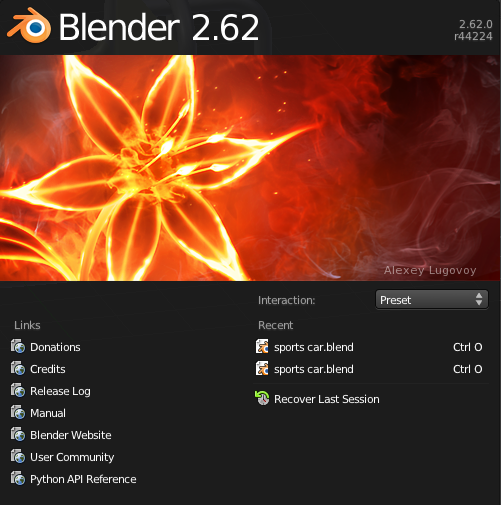

Hello, I have chosen a Blender file of a vehicle that I am currently modelling, and I have compared the Unsuported Blender plugin v1.12 with the Wavefront exporter built in Blender 2.62.
With the same settings and the unofficial plugin set to not create OCS file, I have to say that the official Wavefront exporter is still faster :
24.22 s versus 33.22 s with v1.12.

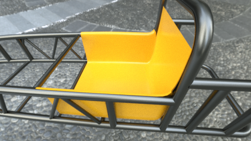

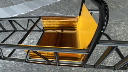

The issue is a bit more complex than I initially thought and seems related to normals being wrongly exported now... I also notice that my exporter outputs much more geometry than the wavefront one and that's also pretty strange to me.
I'm on both issue but pretty busy with my job while also preparing to move into a new house. In the meantime you can disable the 'Rotate X90' in 'Octane Export settings' sub-panel, it should do the job until I can cleanup the script.

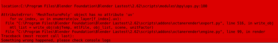

My Blender with BMesh breaks exporting (v. 1.13) with error (see attached file).
I Just haven't noticed the moment when is started... Scene created in previous versions was rendering normally in my r44308.
I added some mesh objects to my complex scene and now this message appears.
But if I open this changed file with Blender 2.62 official build (r44136) exporting works just fine with no errors.
I just thought that this iformation can be useful.

This is because of bmesh... old mesh objects are still using the old mesh code, new objects are using the new bmesh code...
Right now, there is limited python api for bmesh objects... if your wanting octane support, stay with the official build of blender and wait until yoyoz says its supported to the trunk...

I just discovered that the built-in wavefront exporter has same issue: if you select 'export normals' you'll get same result as octane plugin.
Even worse, I got some scenes I cannot export anymore with both plugins... I've to report this to Campbell. In the meantime, you can disable export of normals in my plugin and cross fingers so you don't get hit by the geometry bug.
