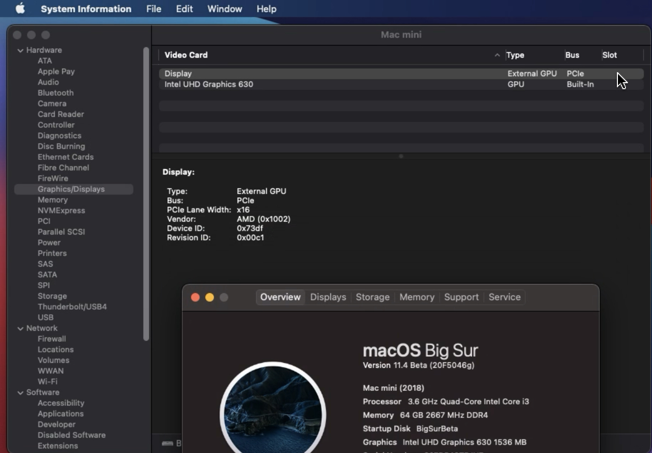

macOS 11.4 beta 1 finally brings the 6800/6800XT/6900XT drivers that Beppe promised us were coming :)
So happy! And thank you Beppe for keeping our faith alive with your remarks. Hope you didn't get into trouble with Apple..

cjadams wrote:do tests!!!!!
I'd love to, but Octane Bench doesn't yet support it unfortunately :( "No supported GPU found" is what Octane Bench 2020.2.3 reports.
I'm not a 3D artist or regular Octane X user (yet) and haven't installed any plugins for it, so I'm not sure if I can bench in the main app.
I can give you Geekbench 5 results - a Metal score of 183k, three times my Vega 64 8GB. The OpenCL score is 122k, so there's quite a gap between OpenCL and Metal. Fortunately the software I use is all Metal compatible now (mostly DaVinci Resolve, hopefully Octane X in the future.)

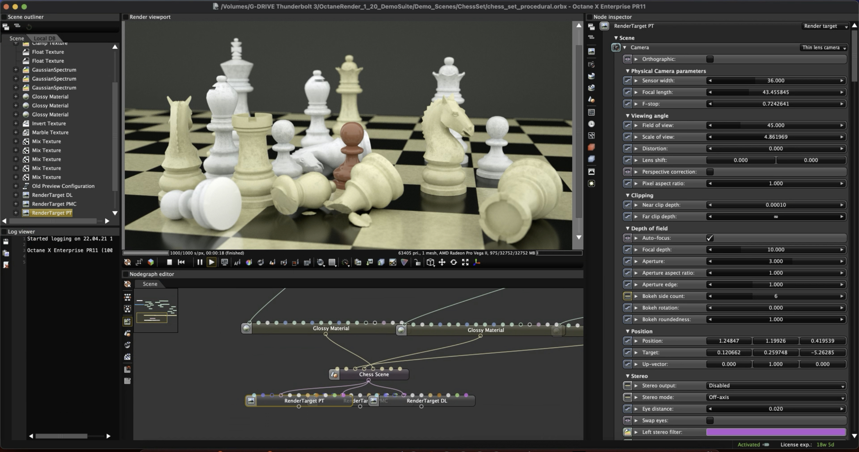

To have an idea of the performance, please download and install Standalone PR11, or OctaneX from Apple Store.
Then download the following .orbx scene, open it with Standalone, select the Render Target PT node to start rendering, and at the end, please share a complete screenshot of the result:
chess_set_procedural.orbx
(3.4 MiB) Downloaded 526 times

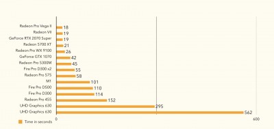

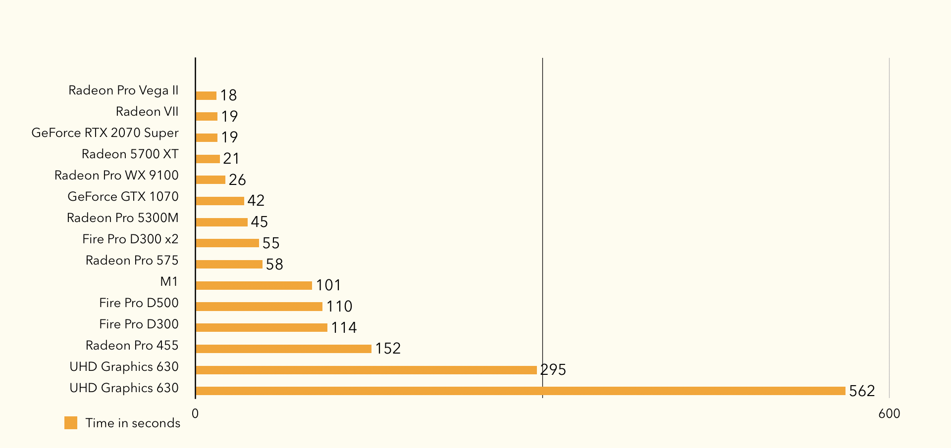

I will add it in this graph for a comparison:
Happy Mac GPU rendering,
ciao Beppe
