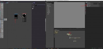

Deleting Material from Material Layer removes nodes that were connected to it too even if they are not connected already :
deleting material layer.zip
(22.97 KiB) Downloaded 170 times

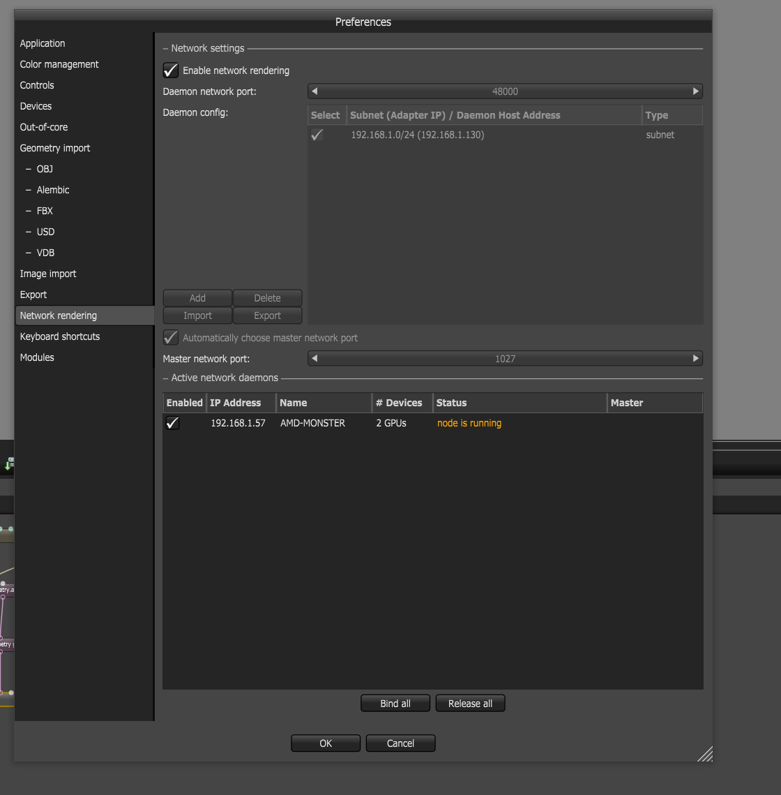

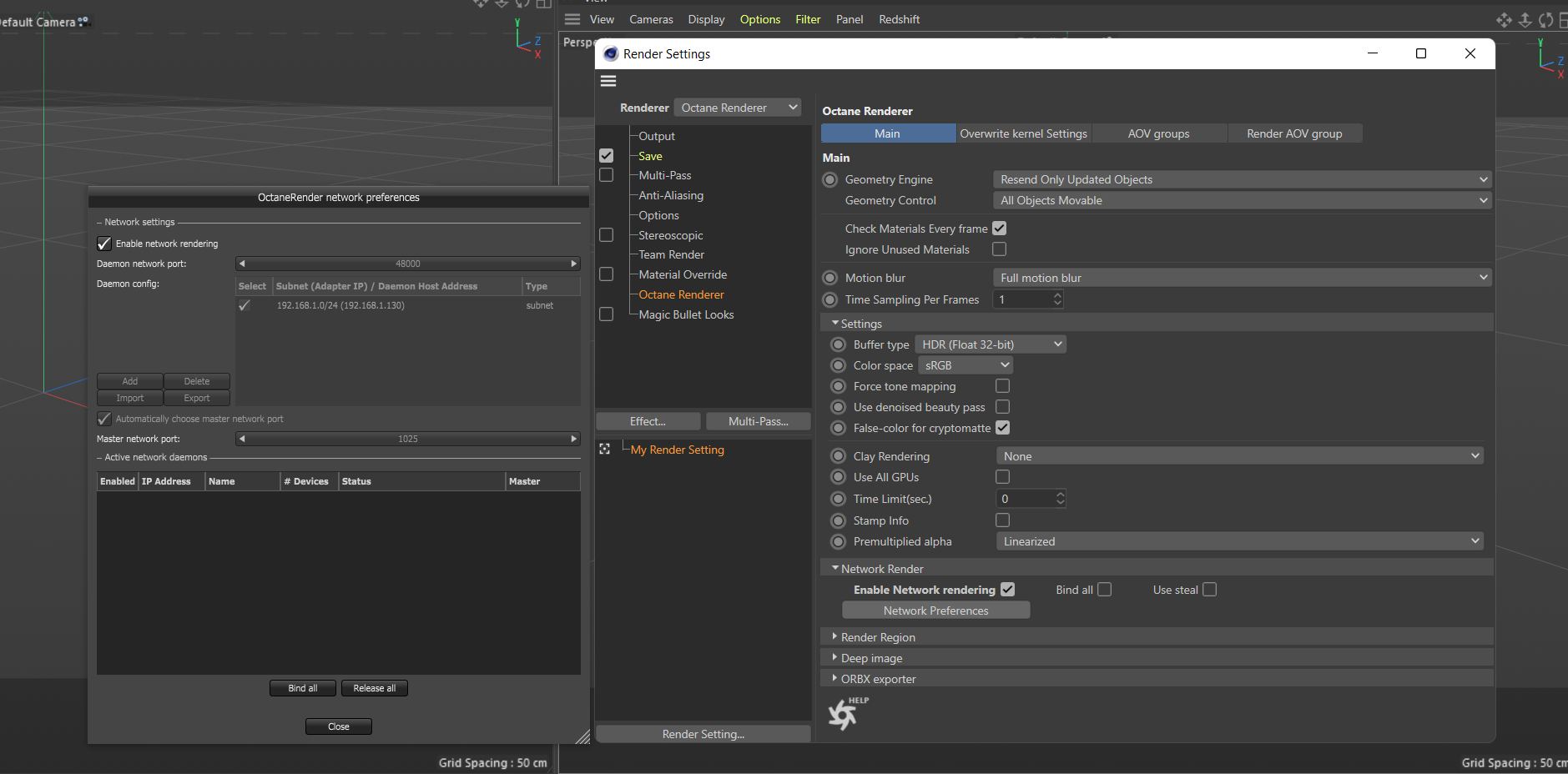

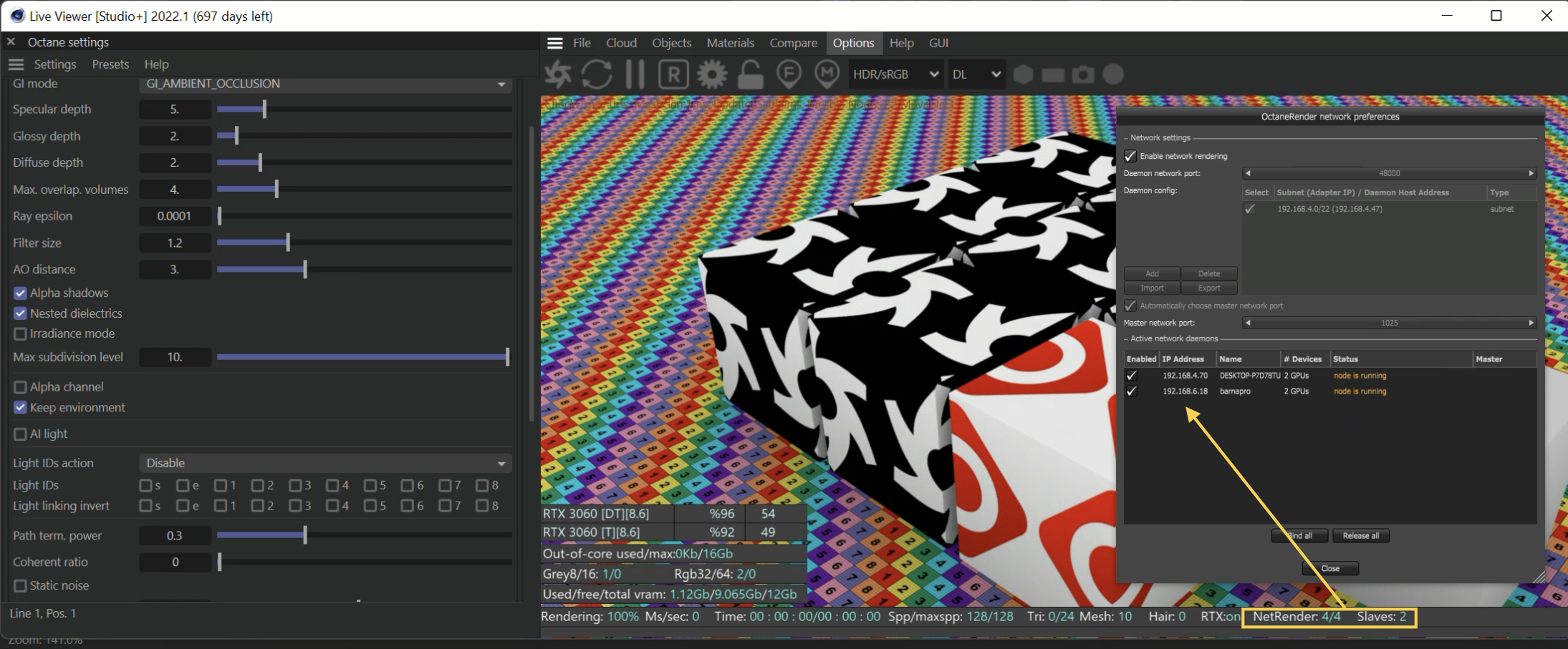

Hello, is the network renderer not working in this iteration of the plugin right now? Because everything works in the standalone.

akvahouse wrote:Hello, is the network renderer not working in this iteration of the plugin right now? Because everything works in the standalone.
Cinema 4d
The attachment Network_render.png is no longer available
Standalone
The attachment Network_render_standalone.png is no longer available

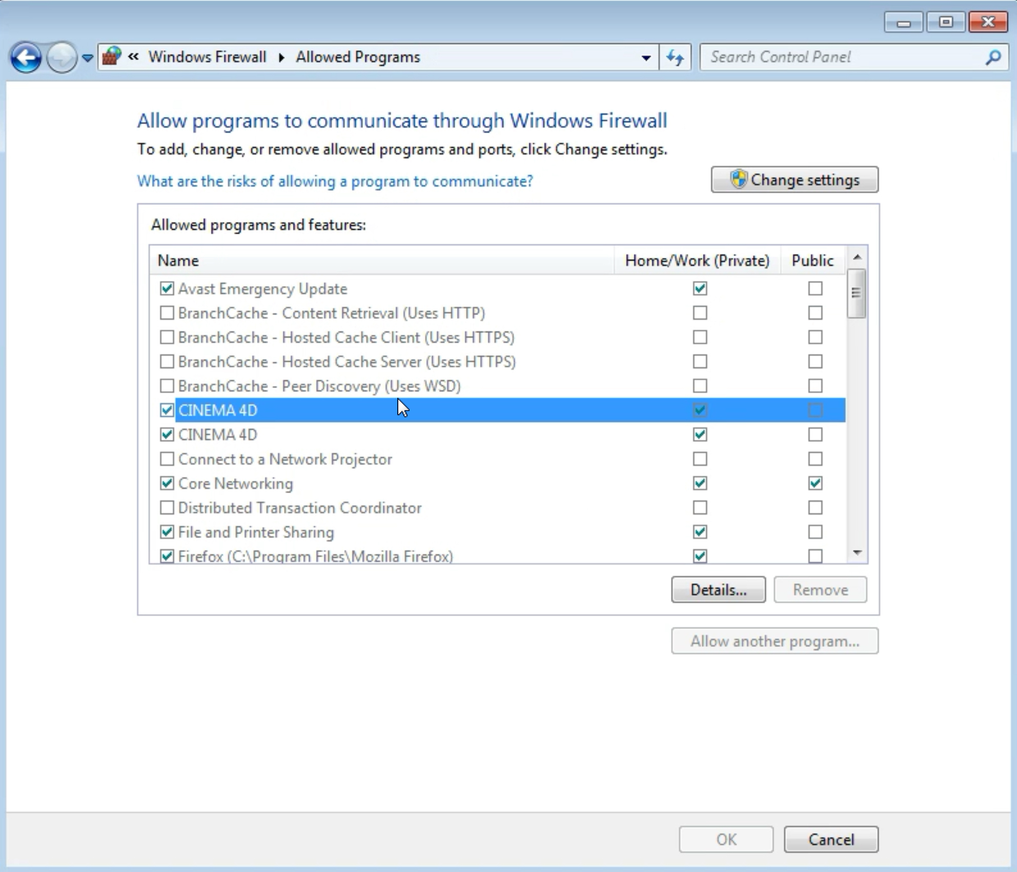

Network Render works great in c4doctane 2022.1:
Please, make sure to have enabled both Private and Public Connections in Windows Firewall, for C4D, and report back, thanks:

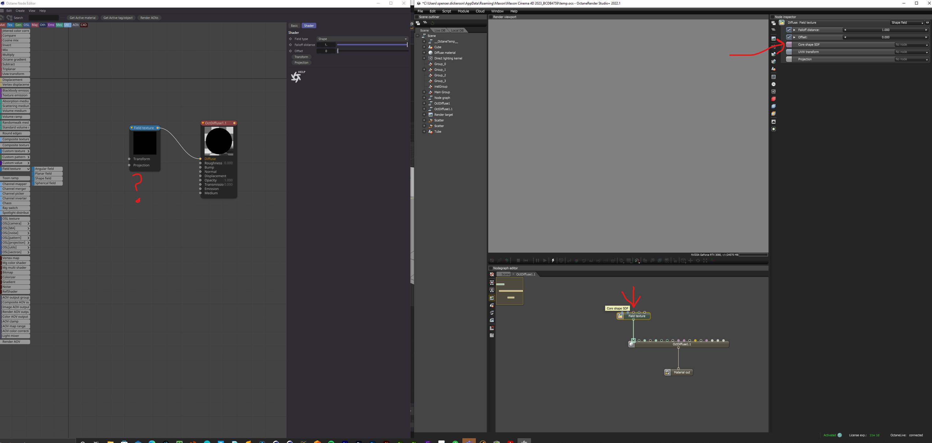

Hadn't received a response so I'll include a screen grab - Shape Field no input option for c4d
2022.1 stable c4d 2022.1 stable SA
