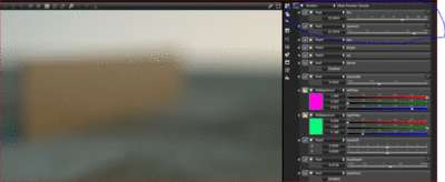

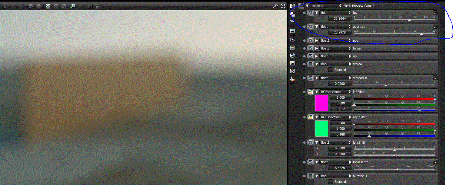

Editing and saving the settings in frame 0 has carried forward to the remaining frames except for the Camera settings.These did not save.I kept loosing the focus / depth of field settings.They kept returning to their previous settings.See the image capture below for details.

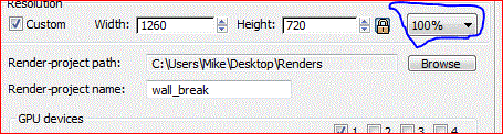

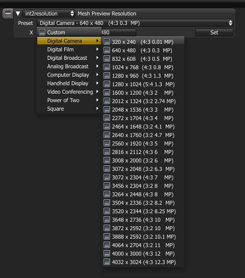

how about changing the % drop down pre-set in the exporter for one that reflects the various camera pre-sets available from within octane.See attachments.
What do you think ?

Jaberwocky wrote:Editing and saving the settings in frame 0 has carried forward to the remaining frames except for the Camera settings.These did not save.I kept loosing the focus / depth of field settings.They kept returning to their previous settings.See the image capture below for details.
This is not a bug, this is a conceptual thing: we should decide, get camera tunings from 3ds Max scene frames, or tune it in Octane, and do NOT export it from Max. At the time - EACH frame is imported from Max with camera tunings that exist in THAT frame in Max... I think this is the right thing - if you create animation sequence, it is strange to create one half (e.g. geometry) in one place and another (camera motion, FOV, depth...) in another place...
But if it the right thing from the point of view of 3D-experts - I'll fix all things to that behavior, to import in Octane geometry and Sun direction only, and do NOT import camera in each frame...

Jaberwocky wrote:I have also had another thought.
What do you think ?
Yes, I can add this if it is more convenient...

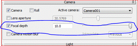

Actually ignore the last comments I just switched on the depth of field in the exporter and with a bit of trial and error , adjusting this I got it close to being in focus.It seems better.Its still slightly out of focus.The depth of field could be deeper.but it's much better.I have it set all the way up to 10.
