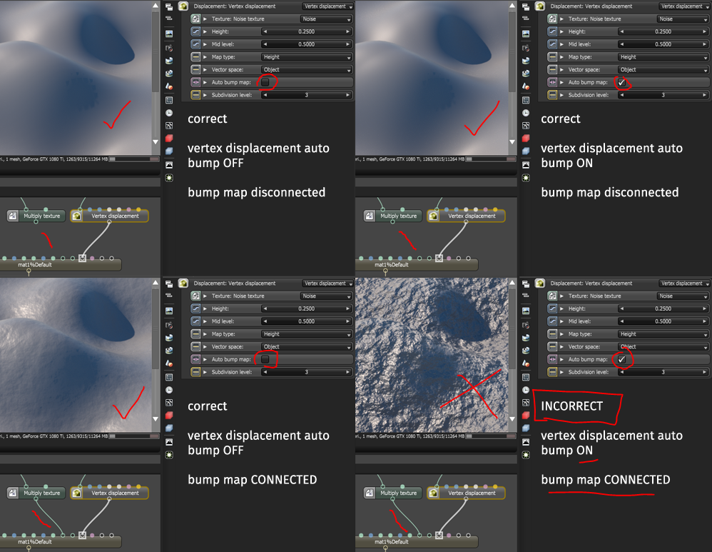

BUG: bump map plugged into bump pin is incorrectly affected by displacement autobump
When you have a bump plugged into the bump pin of a material, AND also have a vertex displacement map, turning on auto bump changes the strength of the bump map in the bump pin. This is incorrect.
1. Load the orbx and click the render target to start rendering
2. Double click the the mat1%default nodegraph. The vertex displacement node has autobump off and you can see the "bump pin" bump map looks correct over the displacement.
3. Enable auto bump.
The bump map now looks much stronger. This is incorrect. The look should hardly change.
The displacement map has no fine bump detail. You can confirm this by unplugging the multiply texture from the bump pin to see displacement on its own

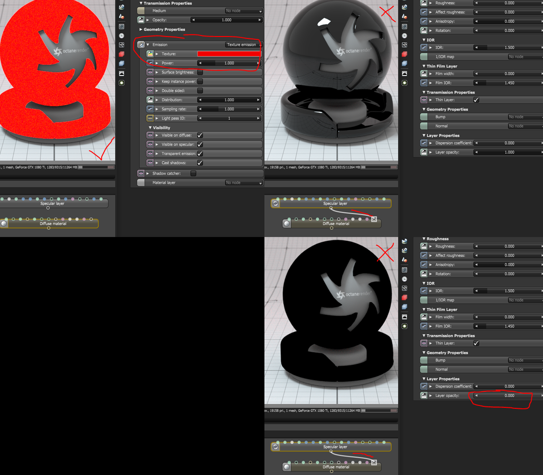

BUG: Diffuse material emission with a specular material layer not working as expected.
If you have a diffuse material with emission, adding a specular material layer (thin layer), stops the emission color from showing, even when the layer has opacity.
1. Load the ocs and right click > render the diffuse material
2. Unplug/plug in the specular layer a few times to see the difference
3. Plug the specular layer in, and set layer opacity to 0.
When the specular layer is disconnected, the material looks red from the emission.
When the specular layer is connect the material looks dark. I would just expect the material to look red, with a clearcoat on top.
If you drag the layer opacity from 1 to 0, I would expect more of the red to start showing up, instead the material is black.
NOTE: It works as expected using a universal material with built in coating.
EDIT: After playing around with this more, I found it works if you set the diffuse material transmission to white. You dont need to do this with the universal material + coating though, so I still think this may be a bug (especially with layer opacity set to 0).

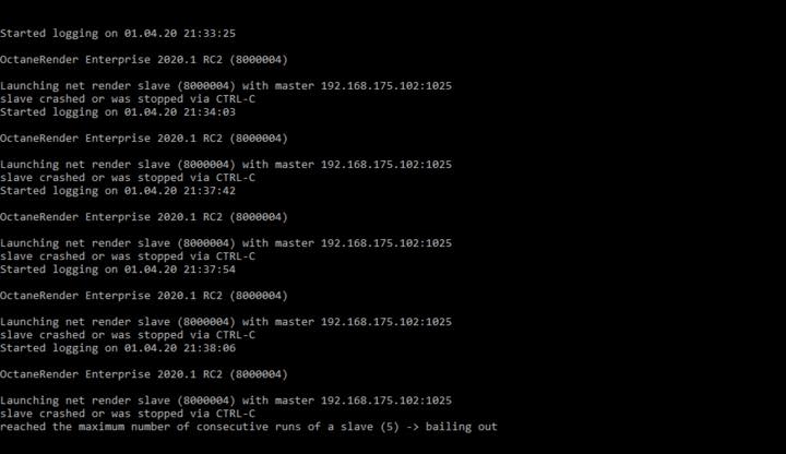

Bug:
Slave machine fails when Z-Depth is selected in render passes.
Tried a few different scenes, tried every sample mode and image format. Disabled all other passes one at a time. It was narrowed down to the Z-Depth causing the issue.
Not sure how to get a more elaborate view of what is failing on the slave, please let me know and I can provide that as well.
