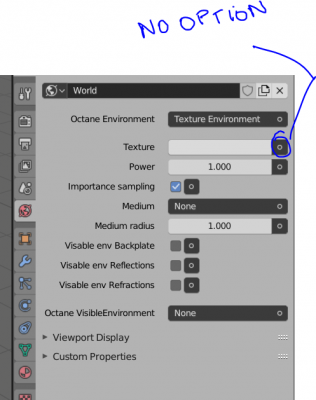

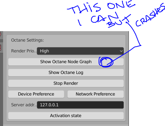

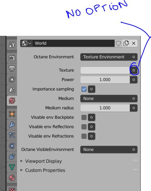

Also, how do you use an hdr image for the environment?
- Could you please try to connect a texture node to the texture env
cheers[/quote]
Thanks for the answers. Where are you asking me to do that? In the Octane node graph or in the world tab?
No option on the texture tab but I can add a texture (rgb image) to the texture environment node but crashes.

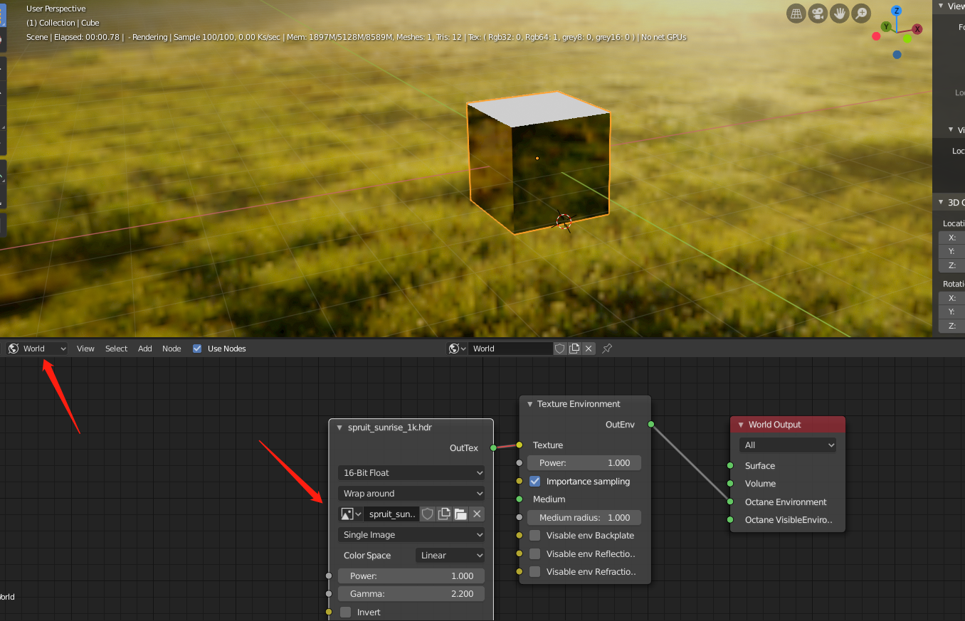

cheers
No option on the texture tab but I can add a texture (rgb image) to the texture environment node but crashes.[/quote]
Hi VISUAL360,
thank you for the post.
Please try these steps for now.
Shader Editor>World type> then Add an Octane Image texture from the Add menu.
Cheers
