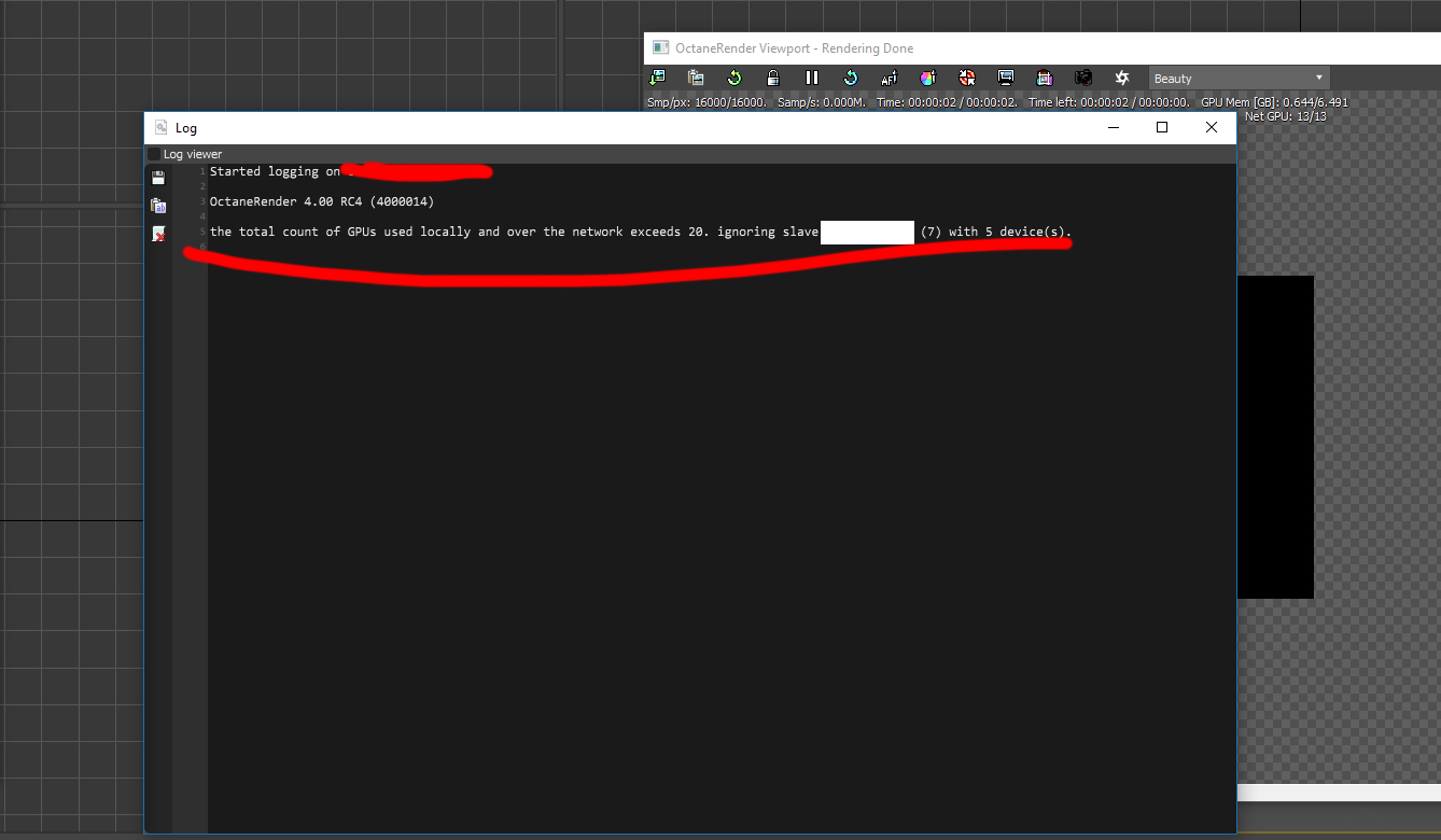

coilbook
Posts: 3179
please fix gpu count for 3ds max RC4 it still shows too many GPUs even though I have 20
Also I have 1 card just for denoising. Do you count it as 1 of 20. If you do then it is not fair. We cannot use actual rendering card for denoising because vram is full and it always says that it doesn't have enough memory to denoise. There should be 20 cards for rendering and 1 more for denoising with free vram /.

coilbook wrote:please fix gpu count for 3ds max RC4 it still shows too many GPUs even though I have 20
If you've got a device that is only being used for denoising it is still being counted. So what exactly is your setup, how many GPUs are used on the slaves and the master for rendering and how many GPUs are used on the master for denoising?
