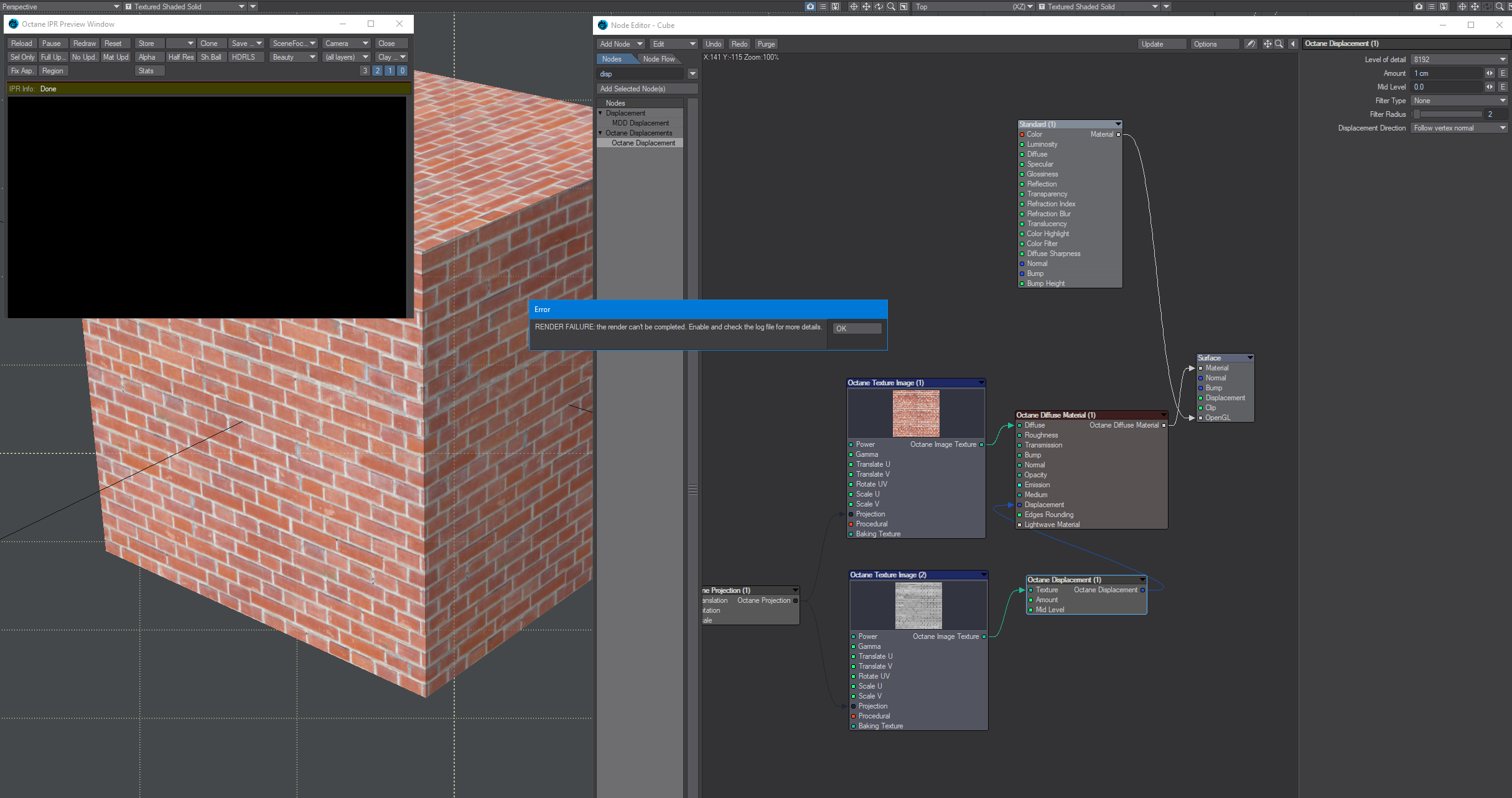

Hmm, so you say that now octane projection node works with displacements ? It didn't work in 3.07 and before but it worked with UVMap node set on T channel.
When i try tha ti get this error message (attached) and my Layout is freezes/crashed. It don't allow me to clock OK or anything, just stays that way freezed on screen
P.S. Is there any way to make Get T function start working in 2018? Any way you could ask NT to get you SDK function exposed maybe ?

Nope sorry, this was a typo. The Octane projection nodes can't be used for displacement yet. The displacement only works in objects with a valid UV map.
Thanks,
-Juanjo

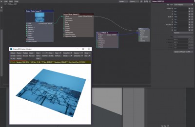

I already have the texture set up on a standard material, and placed it by eye using coordinates and positions on the T texture layer. Now I need to replicate this mapping on Octane but I don't know how to do it. Cubic mapping doesn't work and I think creating an UV map is not posible, because the geometry is very dense (about 5 million polys) and it's not square, so aligning the UV map would be a pain.
Is there a way to use the UVMAP node? I've attached a screen of what I've tried, but no luck…
Thanks!!!

The UVMAP node works in LW2018 like in LW2015, linked to the normal input. The only limitation is that the "T" texture mode doesn't work. I'm not sure if you could copy the projection from the LW T layer into the Octane node, but in any case I suppose that the best workflow is to work with an UV map, even if the object is too complex.
Thanks,
-Juanjo
