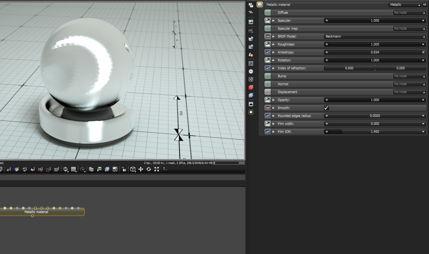

funk wrote:Shouldn't a "metallic material" with n = 1.5, k = 0, look the same as a glossy material with IOR = 1.5?
The metallic material is shinier. Is this a case of using the wrong fresnel formula again? You've done this in the past and had to switch to non polarised
EDIT: Setting n = 0, and specular = 0.04 (4% = IOR 1.5), is getting much closer to the glossy material (although fresnel is a bit different due to schlick's approximation). So something is wrong with your n/k formula
Yes we are using a simplified form for the Fresnel equations for complex IOR, which works best for metals but which is not accurate for the usual IORs for dielectric materials.
The Schlick approximation is only used on metallic materials when you set the IOR to 0, in that case the metallic color is assumed to be the reflectance at normal incidence.
-Roeland

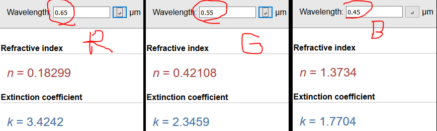

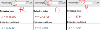

roeland wrote:Yes we are using a simplified form for the Fresnel equations for complex IOR, which works best for metals but which is not accurate for the usual IORs for dielectric materials.
So we basically have a metallic node, with 2 fresnel approximations...
I'm kind of confused how we are meant to use the n/k values along with specular color?
eg If I was going to get n/k for gold, I would visit https://refractiveindex.info/, select gold, then get 3 sets of n/k values for R/G/B (approx wavelengths 0.65, 0.55, 0.45).
With the metallic node, there is no way to enter 3 sets of values. So how are we meant to know what values to enter into n/k and specular color?
I "could" create the specular color by getting the 0 degree reflectance values (shown later down the page), for R,G and B, but entering a value for n/k is still guesswork (how?) and would "scale" this color anyway (according to viewtopic.php?f=33&t=63219 )
