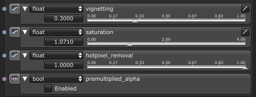

A step backward are this new white bars, which hide the control slider. Either make 'em gray again or make the slider triangle colored, so it will stand out more:

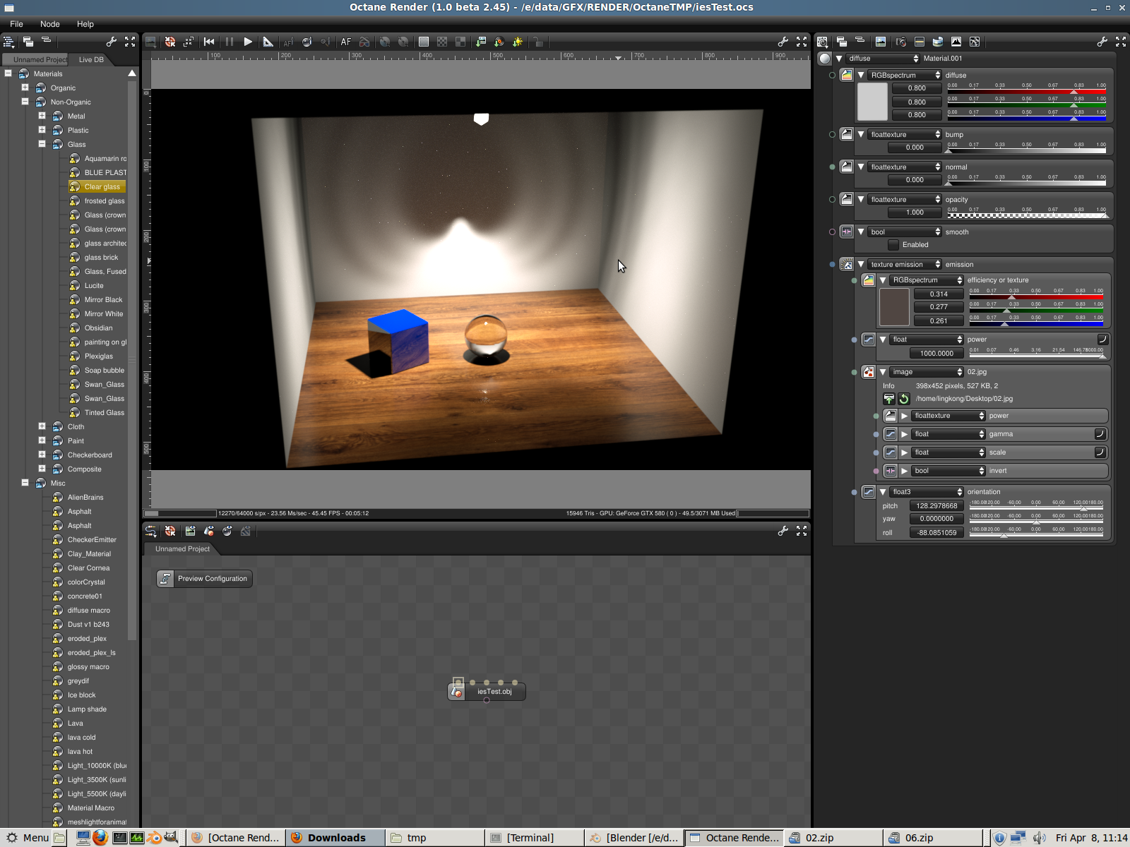

ies:
the new ies tex lighting feature is nice. i made some first test playing with the orientation.
i wonder if anybody would share some sources for those ies tex.
just a few: http://www.rendertextures.com/tag/ies/
edit: btw..there must be some converters out there to convert real ies files to image tex??
thanks for the linux built, seems to work great on mint10:)
