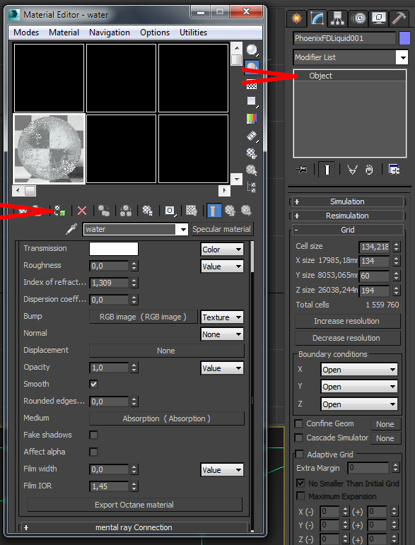

Hi Paride,
Perhaps I didnt explain fully. What you described adds a material to the liquid, fine. However in the dynamics rollout there is an option for 'wetting'. This creates particles where the liquid touches other objects and sticks to it, causing a coating to appear like throwing paint down a wall, it would 'smear' as the paint drips and stains the wall. Is there no way to apply a material to this phoenix feature as octane doesn't seem to render the wetting particles?
right now, the liquid just rolls down the wall which does not look realistic as it does not leave a trail behind it which is what the 'wetting' feature does.

paride4331
Posts: 4001
Hi darkline,
I will ask developers about that.
I will keep you informed
Regards
Paride

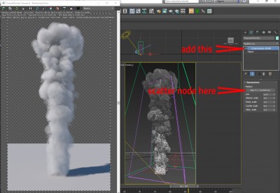

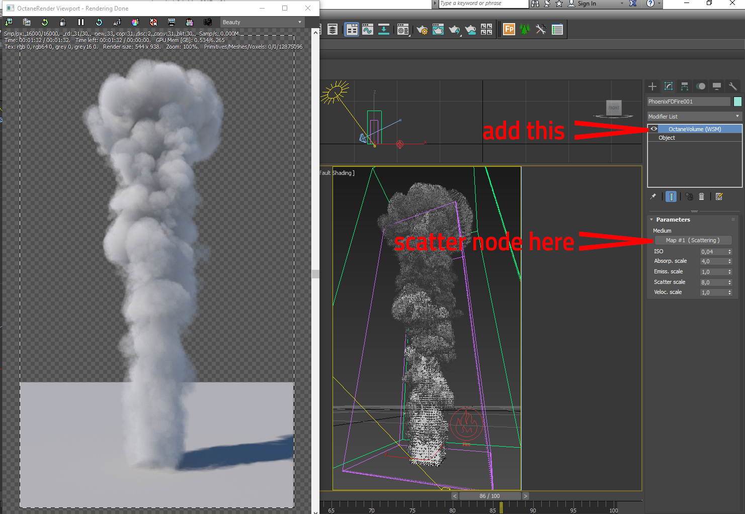

paride4331
Posts: 4001
Hi visionmaster2,
attached a sample file.
There is not a correct adaptable preset to every circumstances, you should set it as well.
https://docs.otoy.com/3DSMaxH/3DSMaxPlu ... ht=scatter
Regards
Paride
01c.zip
(84.44 KiB) Downloaded 267 times
visionmaster2
Posts: 107
Joined: Wed Apr 10, 2013 12:52 pm
Thank you Paride4331 !!
it's working great !
Now, I need to understand what i was doing wrong.
thank you :)
visionmaster2
Posts: 107
ok, found it.... i was using the volume medium. :roll:
thank you.

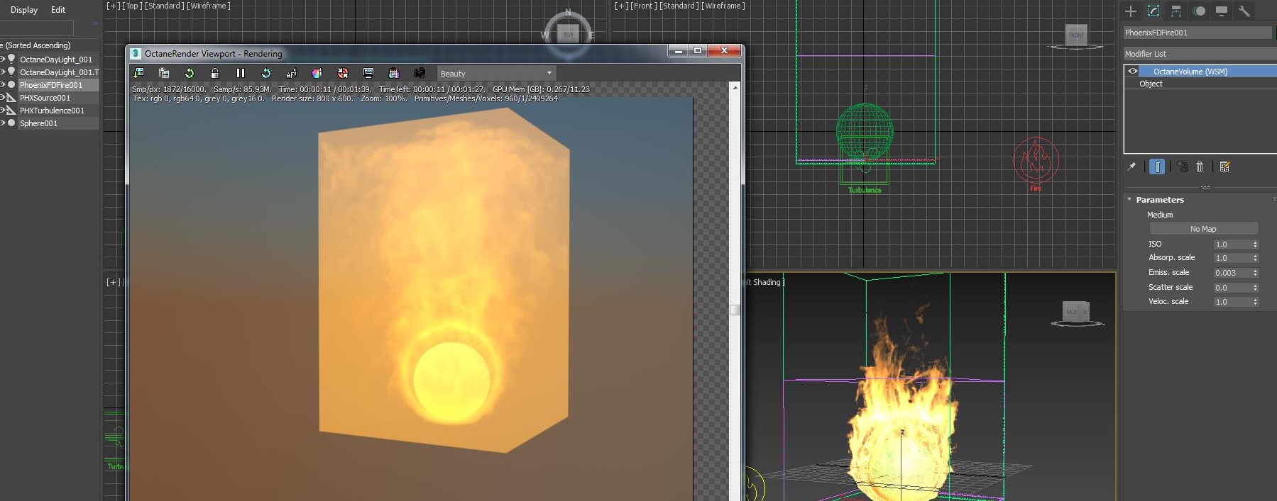

Notiusweb
Posts: 1285
Hello!
I am using Max 2018, latest stable build plugin 3.06.4 - 4.39, latest Phoenix build.
Just asking for some guidance, I am sure I am missing something, like a scatter map or something. (or might it be a bug?...)
In PhoenixFD fire object preset, on the default VRAY max render getting just the ball and fire emission, but on Octane getting the volume radiating/filling the whole container 'box'.
Any thoughts how to reduce that / purposefully create that, tried tweaking different things couldn't get the box to go away without reducing the intensity of the whole thing (primitive sphere and flame).
If I set Emission scale to 1.0, it is just a white volume box, and the more I lower it all uniformly fades to 0. The volume container is always visibly present.
Contrast that to this cloud one, the box isn't filled with a grey haze, just the actual volume shape. It must be a power setting somewhere, but don't know.
Thx and Regards!
-Notiusweb
