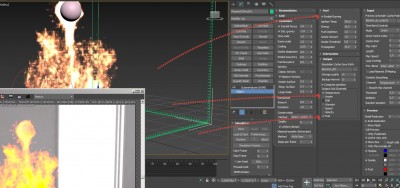

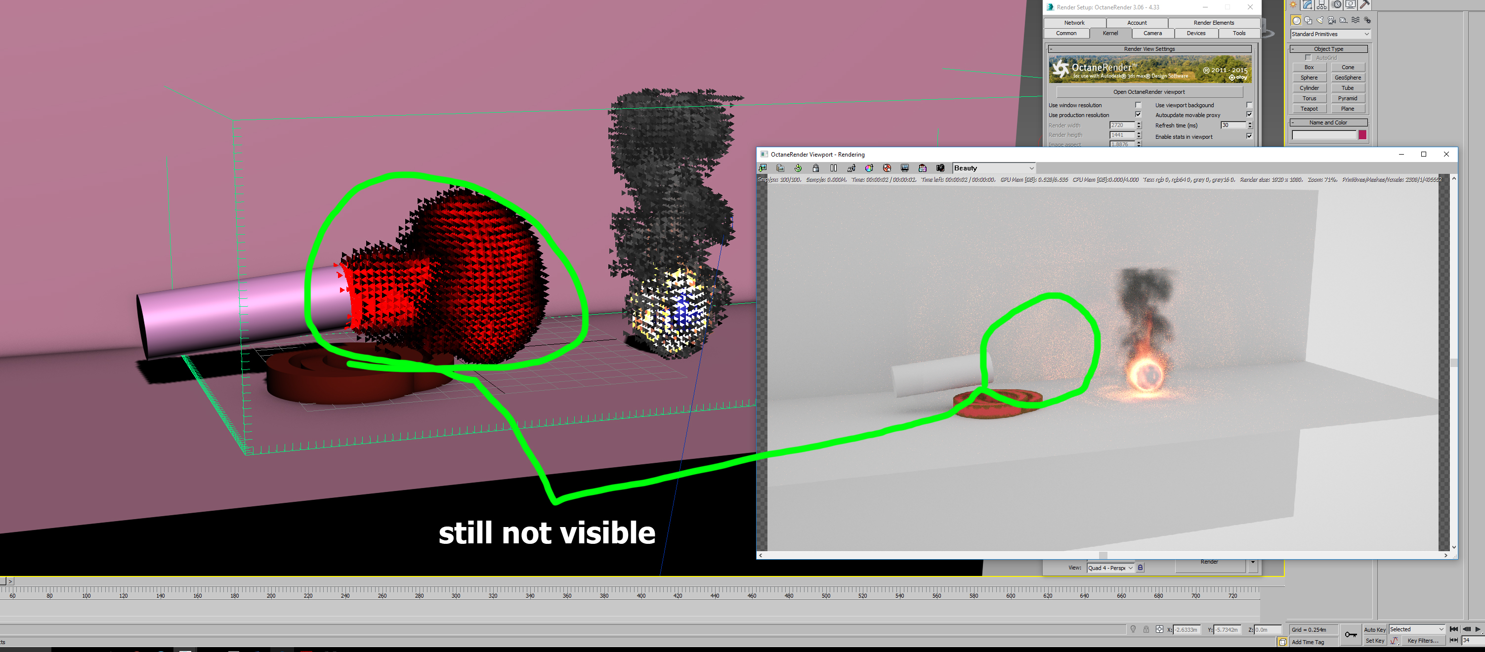

I submitted a bug a while back about OCtane not rendering Phoenix fuel . Can you, guys, fix it where we can add another modifier with volume medium and apply texture to the fuel like you did with particle modifier for mist, wetmaps, foam.
Currently we see only flames and smoke and do not see fuel and we really need to have fuel to be renderable and not just invisible. Thank you!

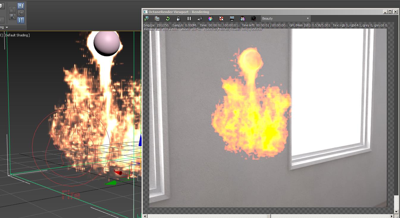

Hi coilbook, I'm testing about fuel,
It seems to works well, I think the issues is with multiple simulation, But I'm still not sure. A screenshot with fuel explosion.
Regards
Paride

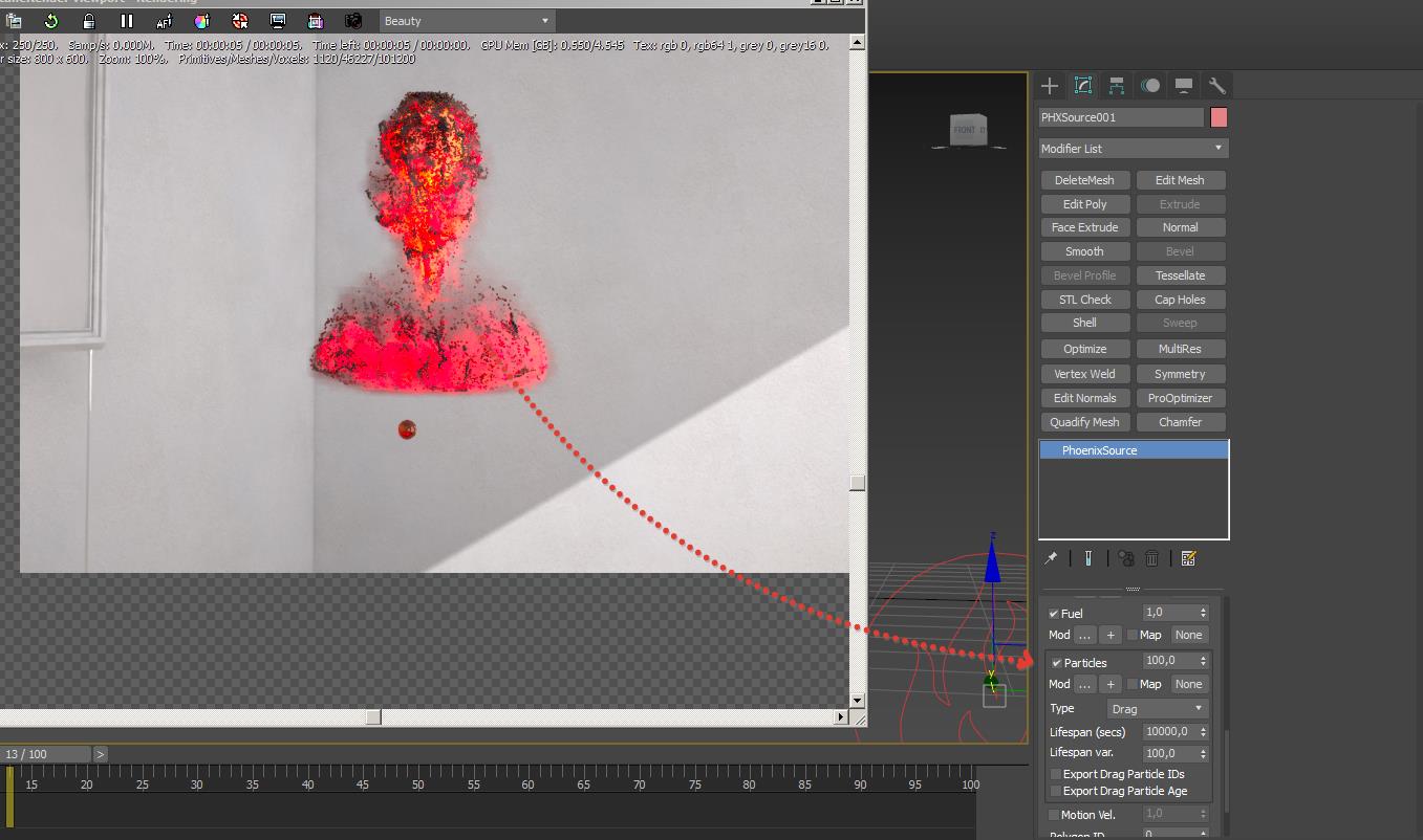

Hi pardie
Could you test my scene I sent you we want fuel to be visible before it is lit like a raptured propane tank where you see white fuel is coming out. Thank you

Goldisart wrote:fuel work !
can you render just pure fuel without fire? Before it is lit?
Goldisart
Posts: 780
Joined: Sat Oct 26, 2013 8:47 am
the only way but there is no effect of the liquid only particle

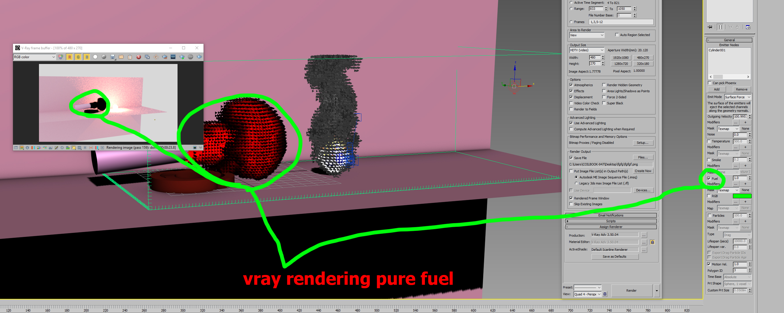

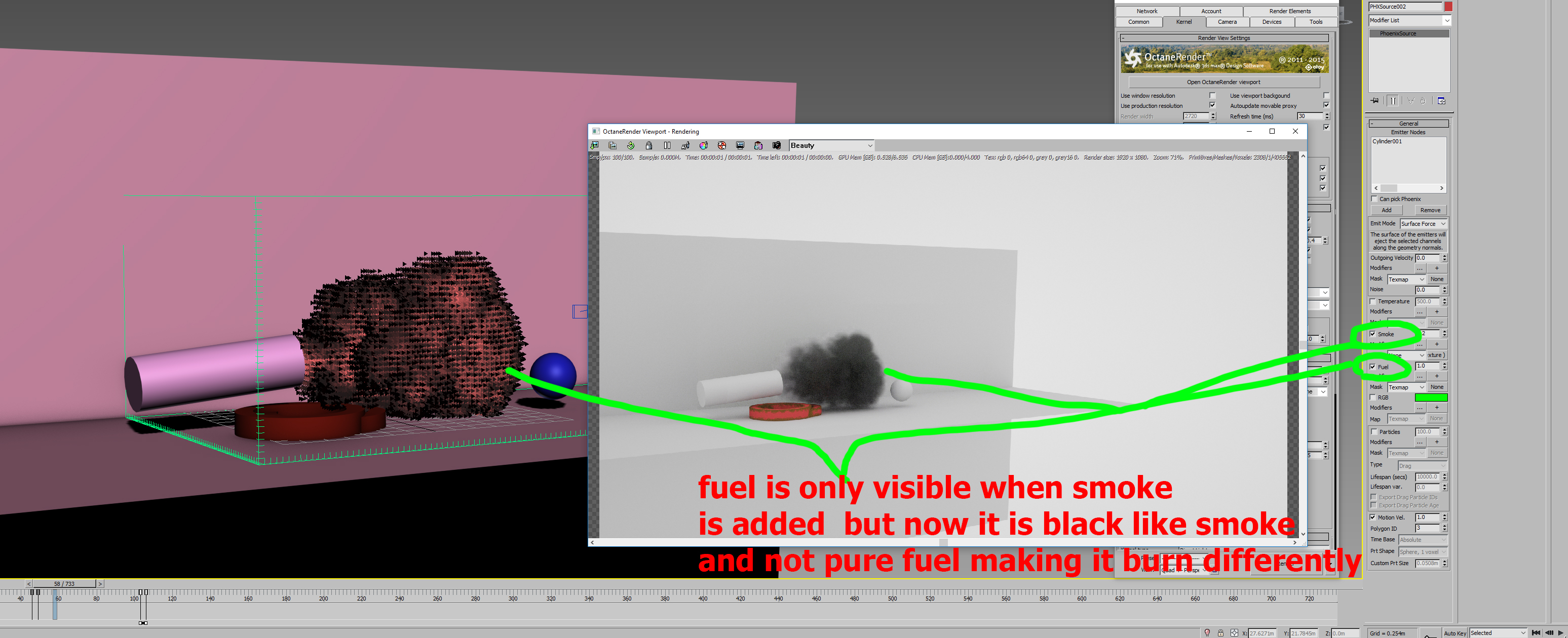

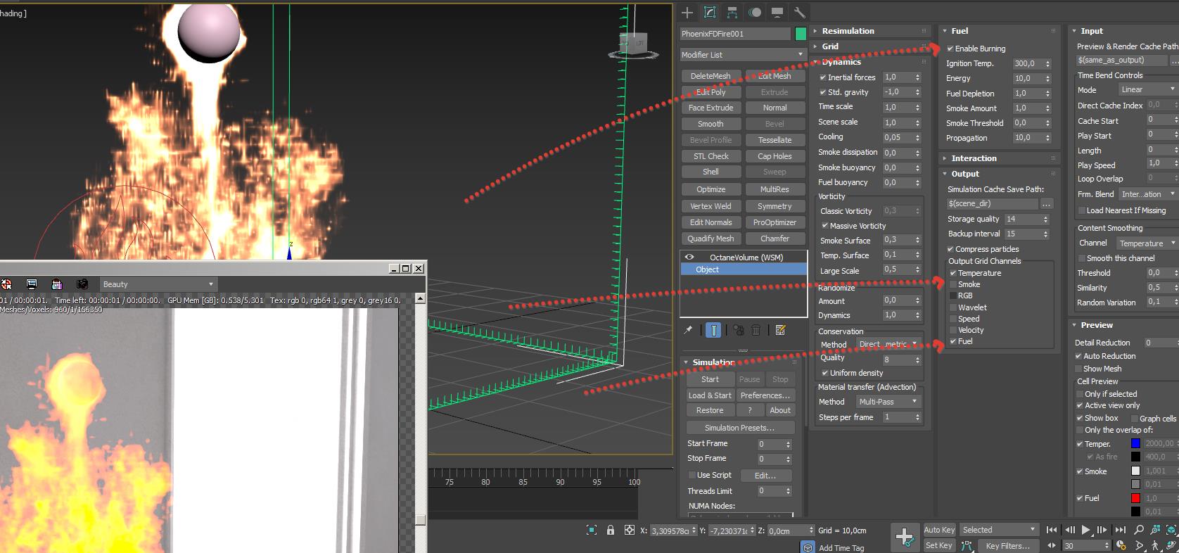

Hi Paride
We talked to chaos and it is possible to render just pure fuel with whatever color you want using vray or default renderer. We can make it visible by adding a bit of a smoke but now fuel is black like smoke and burns differently so it is not a pure fuel. Hopefully this can be fixed by being able to add second modifier for fuel. Because even if we have to add smoke it is black not white so it does not even look like fuel.
I think manual just talks about how fuel burns and what needs to be done for it to burn .
Here is our conversation: https://forums.chaosgroup.com/showthrea ... oenix+fuel
"By default Fuel is not rendered indeed - you need to map it to either the fire emission or the opacity, like by default the Temperature is mapped to the emission and the Smoke channel is mapped to the opacity. Check the 'based on' dropdown in the Volumetric rendering settings."
Here you can see fuel as white before it is ignited https://youtu.be/Lr15rPHEmeQ?t=1m25s
I think if you guys can develop layered modifiers like you did for foam and particles we can use fuel to have its own color, we can use RGB channel to have different color smokes mixing in one simulation box.

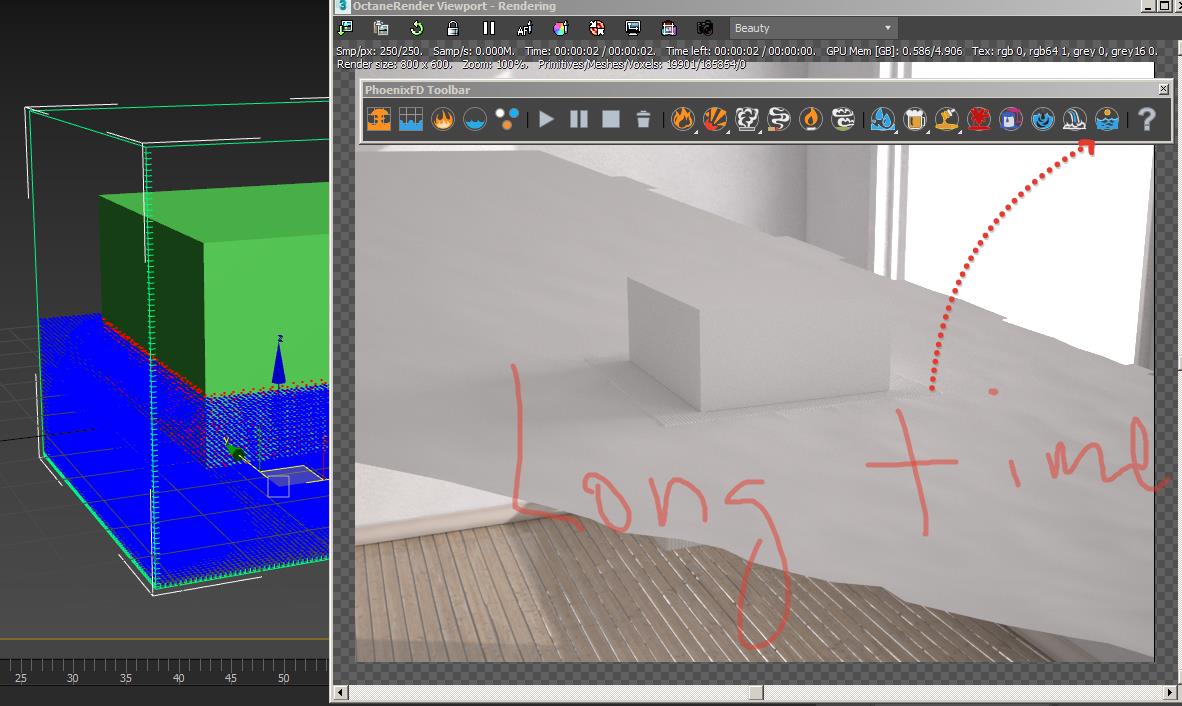

when I do a large number of voxels 100 million memory used 3-4 GB and is late to work no longer possible ... what options can you offer ?

+ sequence digwadih the clouds - oceananimation - so long loaded in the video card

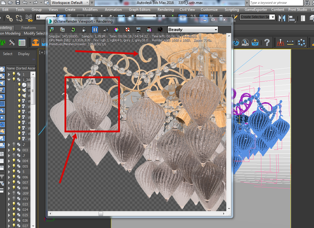

Does not convert materials (Vray)
scene
