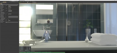

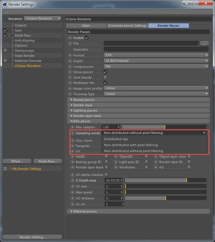

Sorry aoktar if someone has mentioned this already - Newest version 3.06 on C4D R18
DOF not showing when rendering Z-pass to live viewer (i.e. Rendering a Z-pass as the main output.) Haven't seen if there's DOF when rendering as a secondary info pass yet. It also doesn't look sampled, as in there isn't that natural 'anti-aliasing' that you expect from Octane, differences between pixels and depth are sharp and choppy. Screenshot of what I'm talking about here - http://prntscr.com/f1bj2h
i7 6950x | 7 x Titan XP 3 x GTX980 | 128GB RAM youtube.com/nikkyyhd
Posts: 16068
Location: Türkiye
NikkyyHD wrote:Sorry aoktar if someone has mentioned this already - Newest version 3.06 on C4D R18
Pls check these options.

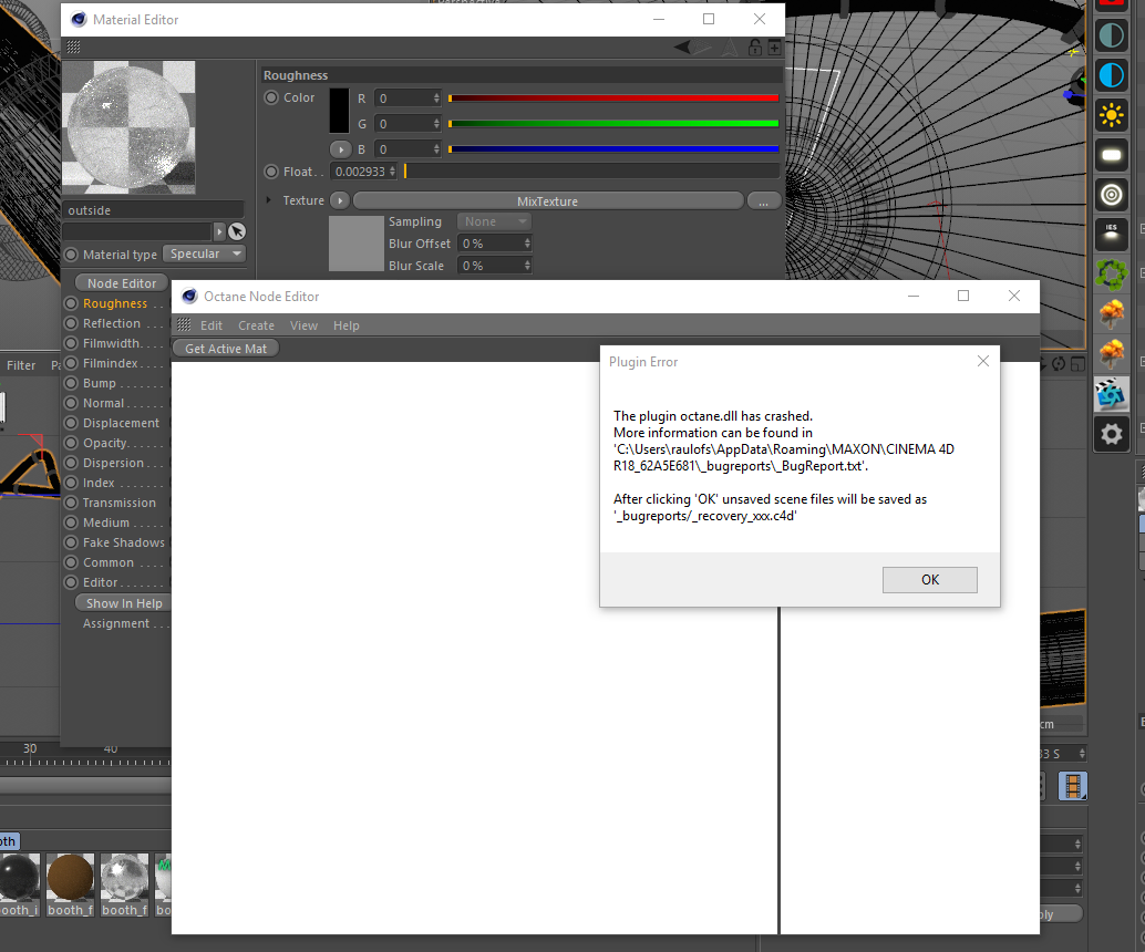

"Hi, it's me again.
When I open the node editor sometimes, it does not allow connecting one node to another and it make to freeze it, also randomly crash the plugin when I open other materials in the node editor
I thought the problem was gone with the new update but now that I'm using the plugin on a bigger scene I keep getting the random freezes and crashes.

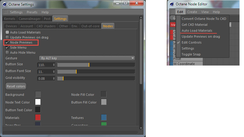

raulofs wrote:"Hi, it's me again.
I use two machines, this are the specs:
Office: Windows 8.1 X64 GPU Titan X Maxwell 12GB (Nvidia updated)
Home: Windows 10 x64 GPU GTX 980 TI 6GB (Nvidia updated)
As you can see in the video I get this random freezes from time to time and it doesn't let me work, I appreciate if you can look into this problem.
NE Button problem is fixed now. That was a wrong place for code line. But i cannot reproduce your crash issue. It maybe spesific to your scene and some other parameters. Can i get your scene(with textures) to test it with that?
Also can you try with different options? Disable "Node Previews" and Enable "Auto Load Materials".
