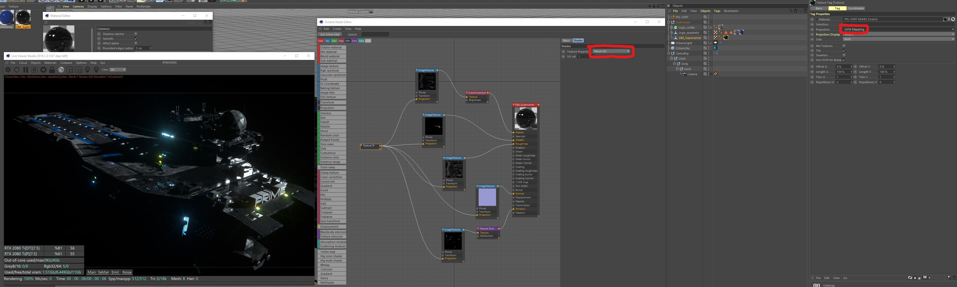

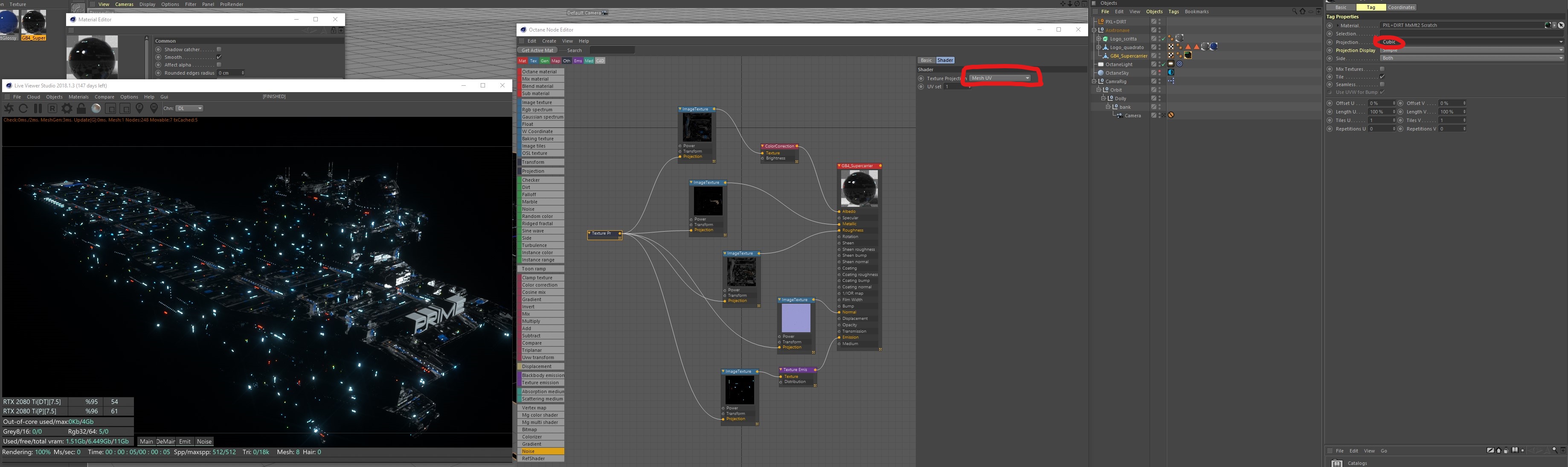

Thank you, but does not seem to work, maybe I mess something up:
I set cubic map on mix material tag and set a UV texture to my clean material, see the attached screenshots pls:

alexlomarco wrote:Thank you, but does not seem to work, maybe I mess something up:
Indeed, we can not act on the projection node of the clean material only if UVW projection is selected on the texture tag of the object manager.
So in your case it will not work ,sorry.
