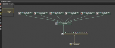

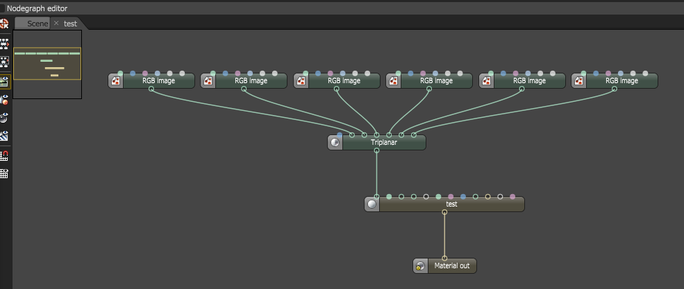

pegot wrote:Yes I do have 3.06 test version - even had to update CUDA for it. And I seem to have all the other great new features. But I can't find the triplaner nodes. And the below screen shot is what it looks like for me when I open your file:
I'm on a Mac, by the way.
It looks like a bug in the mac build. There should already be a triplanar texture in there connecting the 6 images to the test material.
I just re-downloaded and double checked the scenes.

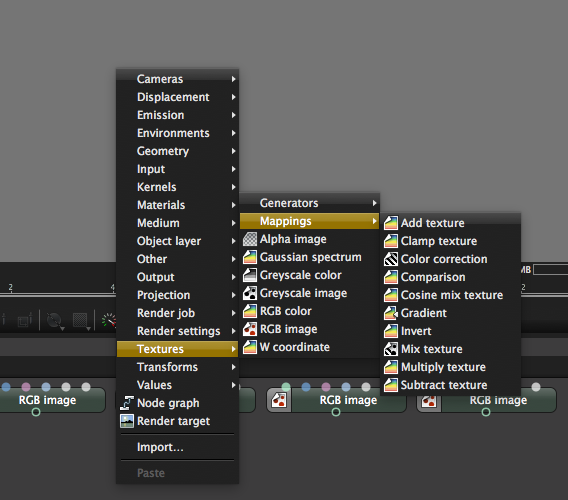

I think this might indeed be a bug in the Mac build. I'm showing the three other new texture nodes (Add, Subtract, and Compare) but not Triplaner. Can any one confirm this works on the Mac version?

Yes it should be at the bottom of the mappings sub menu.
I guess the mac build is broken

Have fixed the mac/linux builds not having a triplanar node.

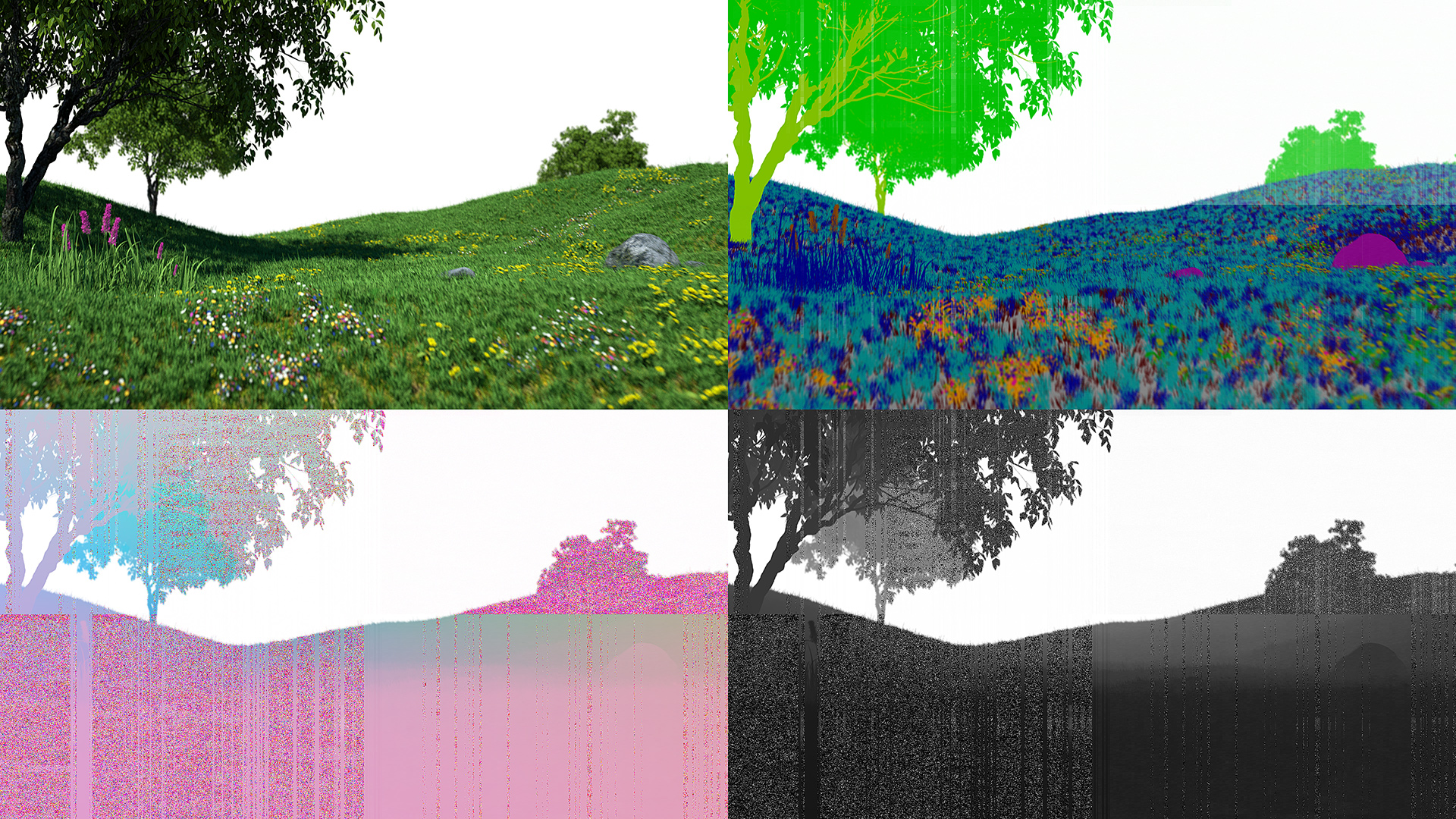

aLeXXtoR wrote:Got a very strange result of rendering the animation sequence (rendered with passes, saved as separate PNG sequences, AS enabled). I'll try to figure out what was going on and give more detaied description.
Well, I get this when I render with AS and render passes enabled... If I disable AS all passes are rendered fine. Does anybode has the same, or I am the one lucky here? )
