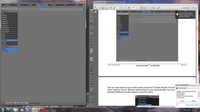

Hi Lionel
I just tried to install your plugin to blender but for some reason, it stopped at this point; the box at the the render point in the installation was not available to be checked.
I have attached a screenshot.
Could you, at your convenience, tell me why this is happening and any suggestions you might have?
