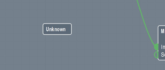

Hi Paul,
Just noticed that when I try to use a Saw Wave procedural, either by dragging or by changing an existing procedural in the node editor, it changes to "unknown" with no editable attributes.
Running version 3.3.4.26 that you provided to make the Polygon Side procedural available.
Thanks. This will be fixed in the next release.

I have updated the installer at the top of this thread with:
3.4.0.26
- Compiled with Octane 3.04
- Swapped Sine and Saw Wave procedurals - as they were referring to each other

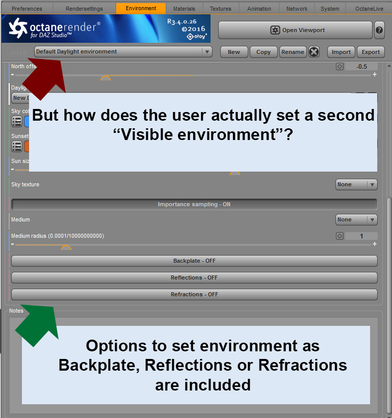

face_off wrote:I have updated the installer at the top of this thread with:
3.4.0.26
Thank you for keeping this plugin up to date.

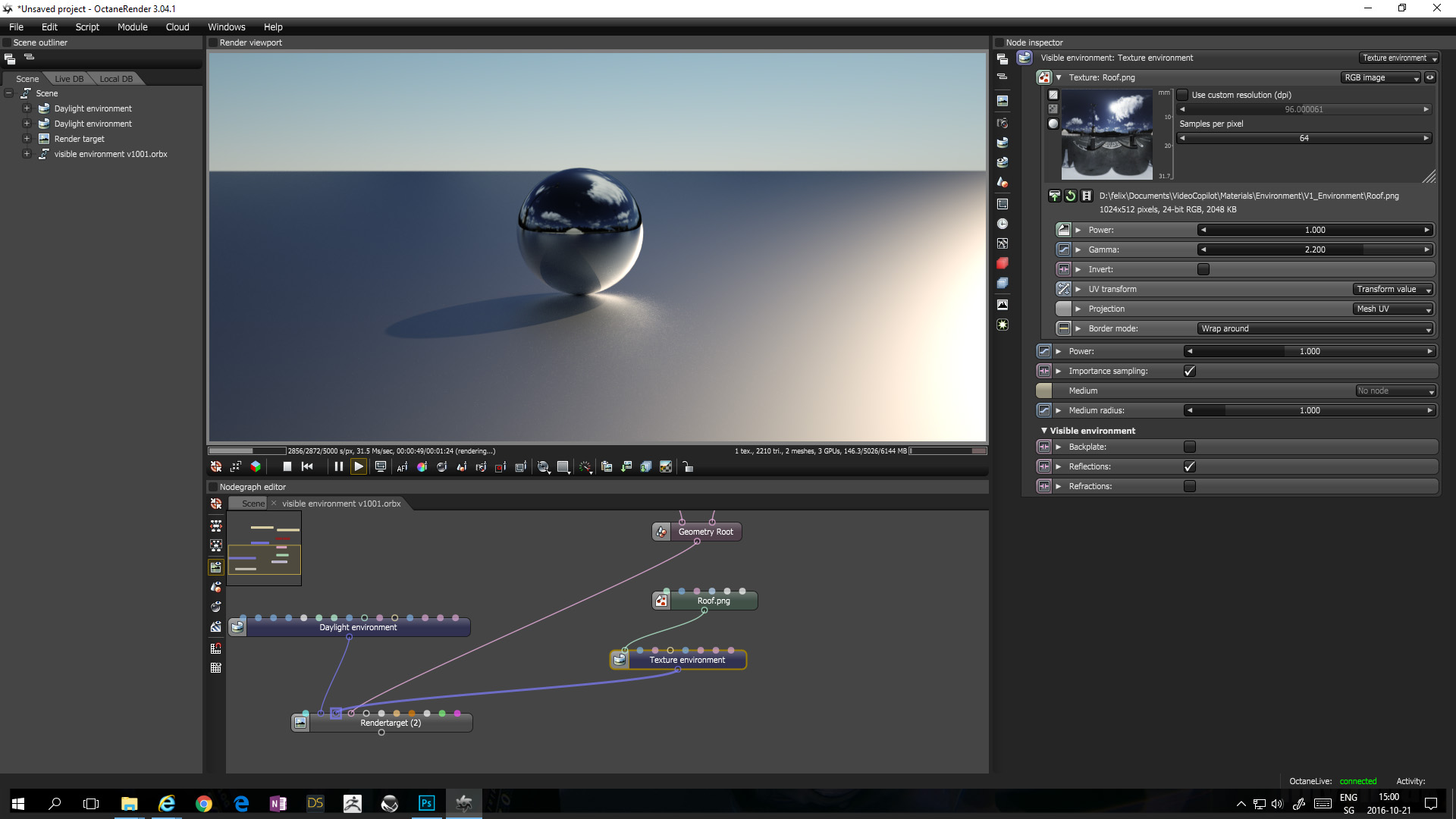

Since its original 3.0 release the standalone version has seen some changes to the "Visible environment" options.
The idea of this feature is that users can set two different environment settings.
- one for the actual light situation
- one for the "visible environment" that shows up only in
Backplate, Reflections or Refractions.
pin 1: Daylight environment<br />pin 2: Visible environment with texture environment set as &quot;Reflections&quot; only
pin 2: Visible environment with texture environment set as "Reflections" only
In OR standalone this feature is activated by connecting an environment node to the additional visible environment pin next to the default environment on the render target node.
It seems in 3.4.0.26 the pins for Backplate, Reflections or Refractions are there both in the Daylight environment and Texture environment.
I imagined in OcDS there would be a second pull down menu below the default environment settings for the secondary "Visible environment".
Is that feature implemented in a different way in OcDS or is it not yet finished?
The current architecture of the DAZStudio plugin does not make this easy to do. And even if it were possible - there would be a lot of added complications to how New/Copy/Rename/Import/Export work (would they do just the Environment, or either the Environment or Visible Environment, or both?). The DAZStudio plugin might handle have both an Environment and Visible Environment panel in the Environment tab, but would potentially not handle having the Visible Environment disconnected (ie. no visible environment). So in summary, it's probably possible to implement, but a lot of work. I will investigate further in the next week or two.
Yes, in both Standalone and the DAZStudio plugin these pins do nothing on the Environment node attached to the Rendertarget Environment pin. They only work on the Visible Environment.
Paul
