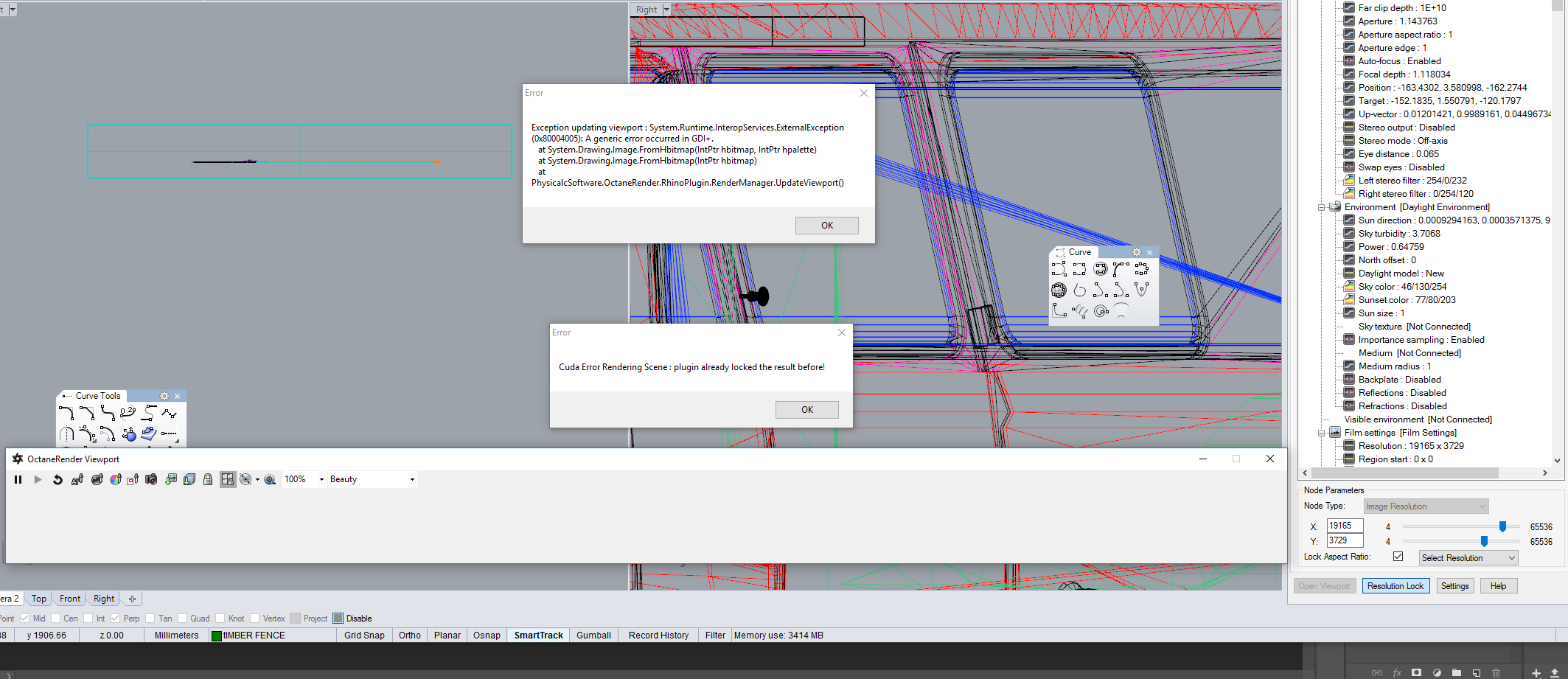

Can anyone tell me what this CUDA error means. It happens when I try to increase the file size of the rendering. Am I running out of Vram.
I have the latest version of Rhino and the plugin.
Ive got a GTX690
32gig ram
6700k
Hi - if you go to the Devices tab, click Octane Log and you can see any Cuda errors. However, I suspect Rhino is running out of display memory. How much VRAM does your graphics card have?

Thanks Paul,
mine is only 3g. Does the overall dimensions affect the VRAm. I thought it was only the number of objects.
Looks like I might need a 980ti or 1070.

Hi Tim - you should also open up the Windows Task Manager and check your RAM. What resolution are you trying to render at? Large resolutions take huge amount of RAM.

Hey Tim - if you are short on vram then optimise your scene - the best thing to start would be to use blocks.
