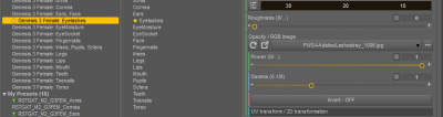

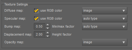

sixb0nes wrote:This is my assumption as well. I can't seem to reproduce what TR is saying. I tried a bunch of different G3F characters and they all came across with Grey Image each time - which confirms what you outlined in your post above.
I may have found out "how" ...
Under texture settings on preferences, if you choose "image" under "Opacity Map", you get an RGB Image result for the Eyelashes conversion. Perhaps? By default mine was "auto type".

As in regard to the Eyelashes not carrying over the opacity map - I'm sure this must be a material conversion issue, as the templating node is set up correctly and should carry it over that way. It works well with the 3Delight materials, so it has to be connected to the Iray materials.
I'll investigate the opacity map problem with DAZ Studio - I've been using version 4.8.0.59.
*EDIT*: Changing the conversion method of opacity maps in the OctaneRender menus preferences tab to "floatimage" positively fixes the "RGB image" problem, but still doesn't carry over the actual opacity map, in the shader set-up.

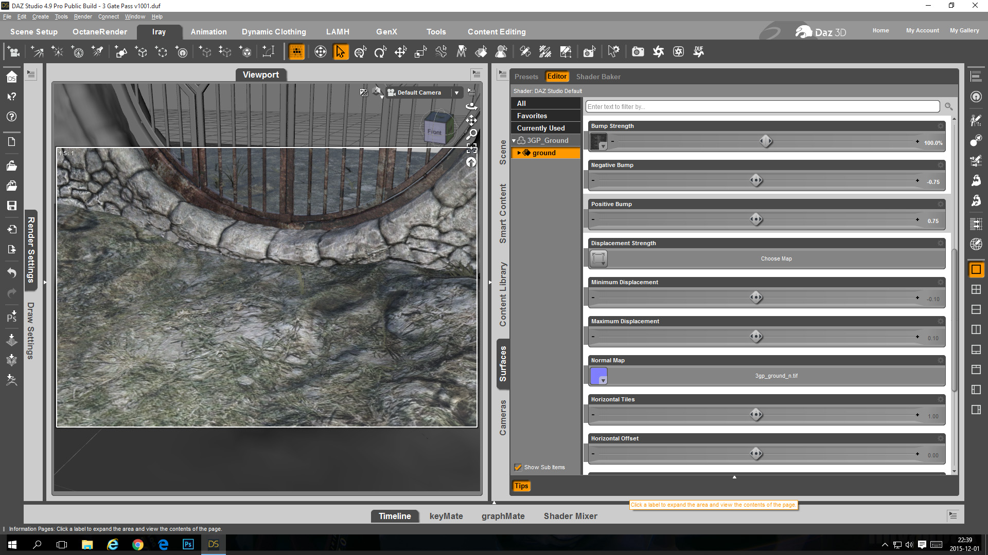

By default this product uses both Bump and Normal maps.
001 3 Gate Pass - Iray Auto Conversion

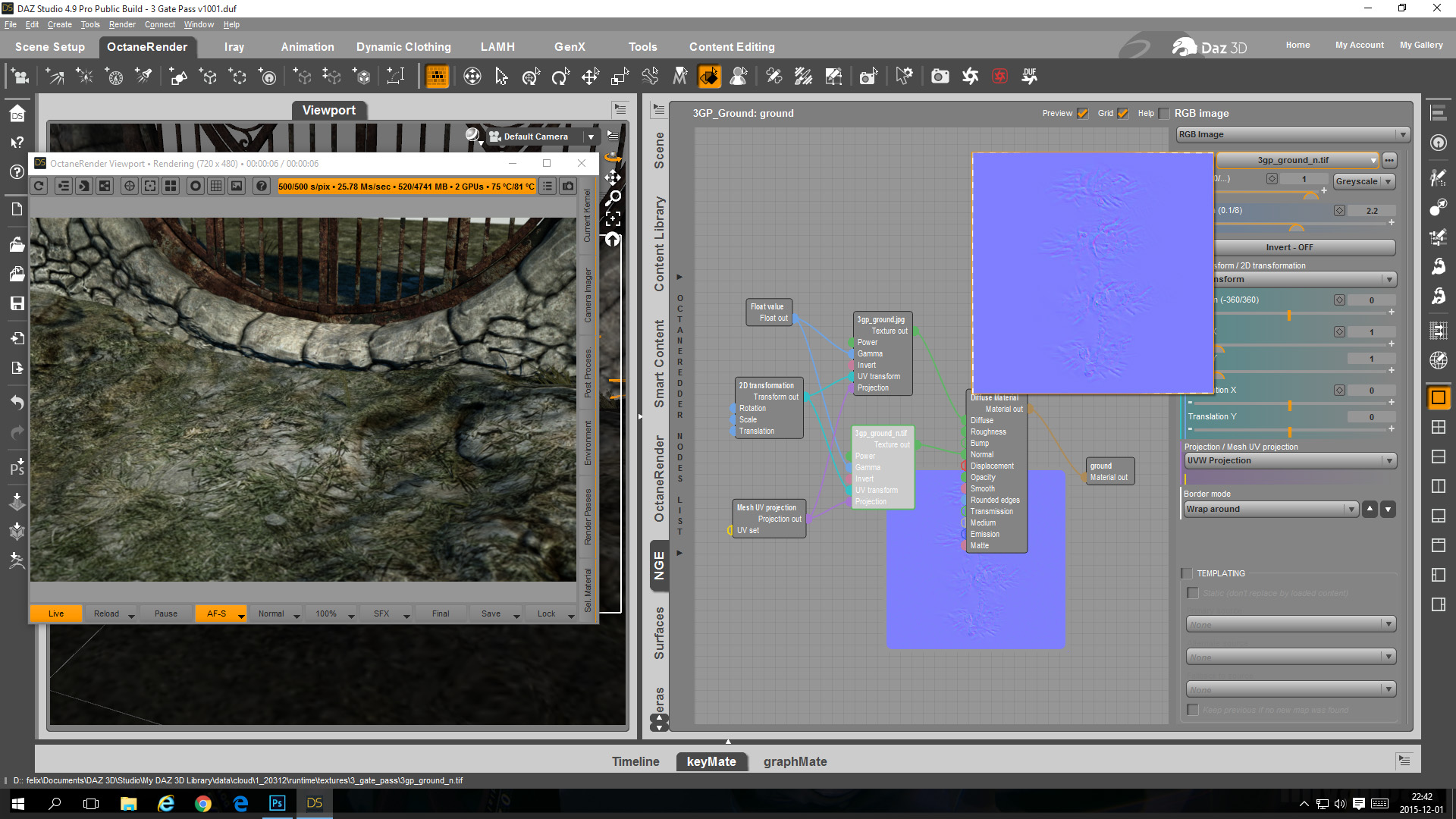

What the new 2.24.2.4 auto conversion rule does is:
- it only takes the normal map and does not anymore create a node for the bump map when both map types are available
- a mix material is not anymore created
- only when there is no normal map a bump map is used as replacement
3 Gate Pass - OR Auto Conversion - Normal Map Priority
002 3 Gate Pass - OR Auto Conversion - Normal Map Priority

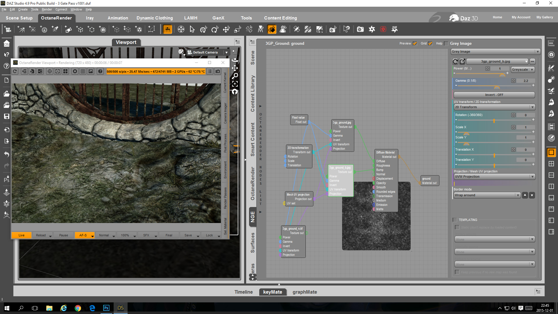

To better see what kind of detail the normal map added I used a white image node in the diffuse slot in this version:
002 3 Gate Pass - OR Auto Conversion - Normal Map Priority - White Diffuse.jpg
3 Gate Pass - Bump Map Priority
Now how would this image look like if instead of the "Normal Map Priority" a "Bump Map Priority" auto conversion rule would be used?

As you can observe this is not a trivial change.
The image does look quite different with only the bump map details than with the normal map details.

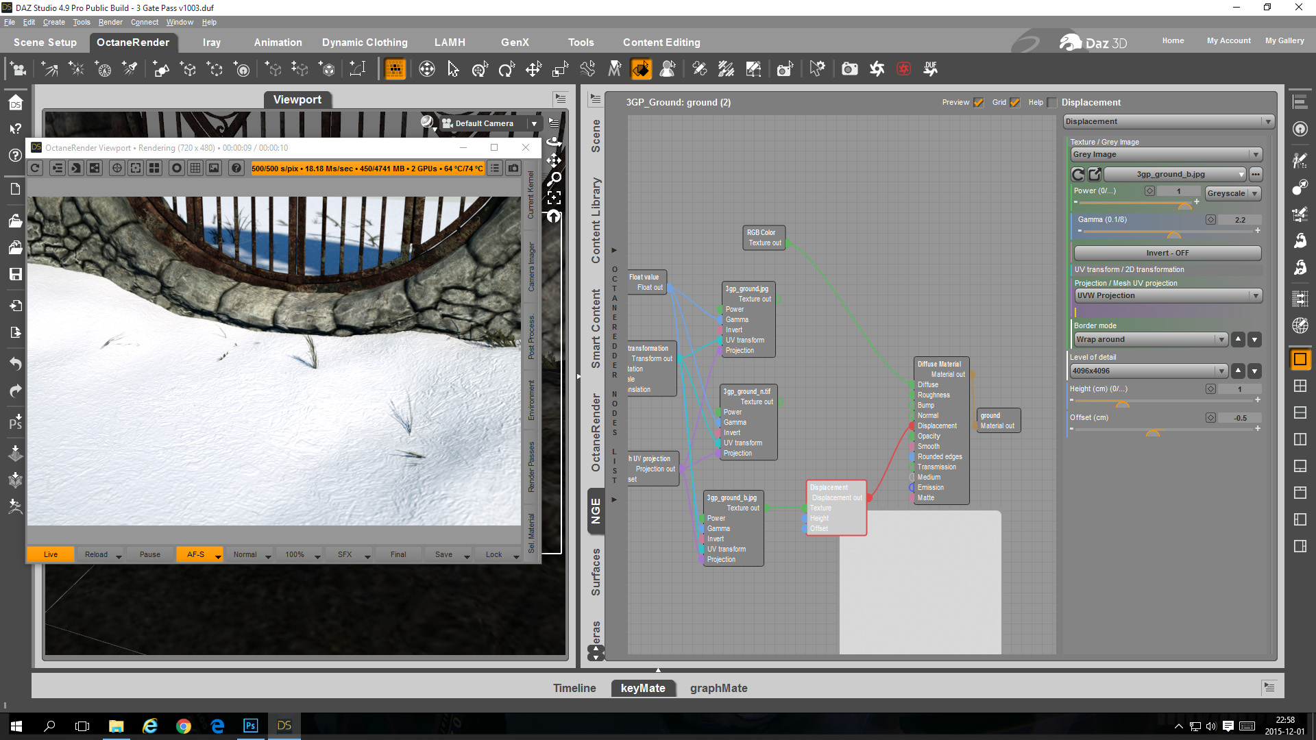

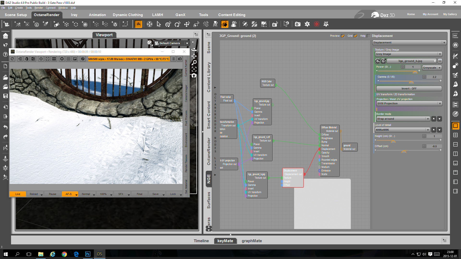

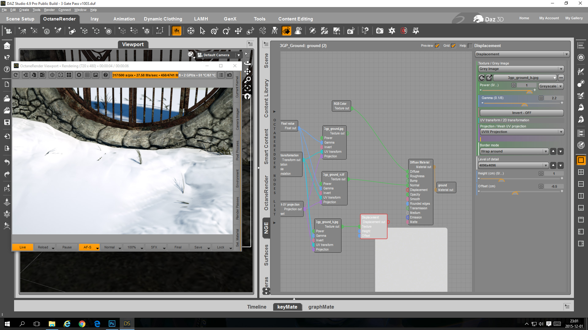

Bump map used in the displacement slot
One benefit of bump maps is that they can be used in displacement slots.
Sometimes you can achieve interesting effects without the need to use photoshop to even edit the maps.
004 3 Gate Pass - OR Bump maps manually used in displacement slot - White Diffuse.jpg

Normal and Displacement mixed together
005 3 Gate Pass - OR auto Normal and manual Displacement

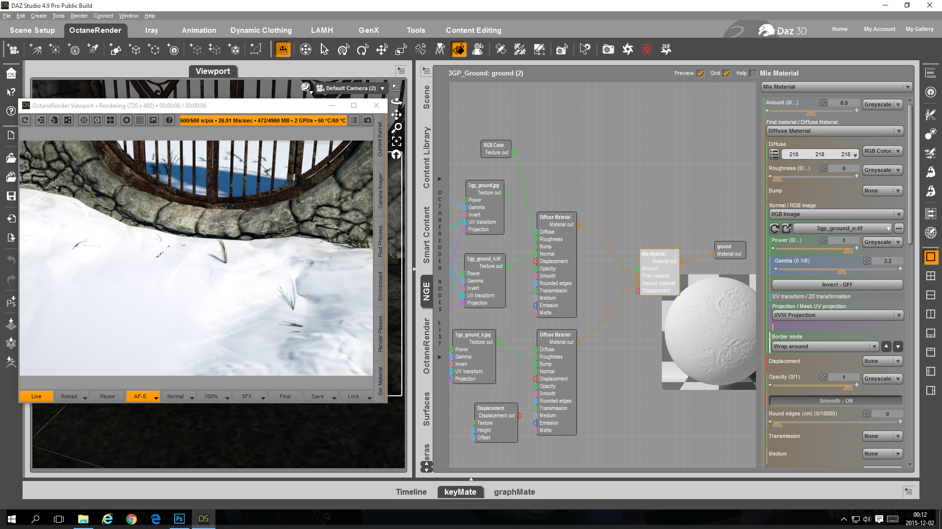

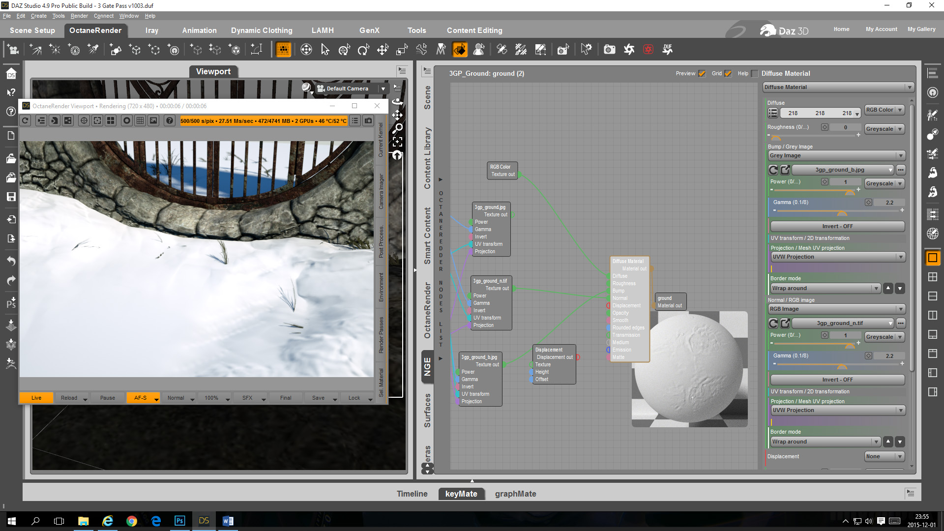

When both bump and normal maps are applied manually on the same surface zone the normal map seems to have priority over the bump map.
006 3 Gate Pass - When bump and normal are applied - normal overwrites bump.jpg
This result stays the same if bump and normal maps are on separate diffuse materials and combined in a mix material.
006 3 Gate Pass - When bump and normal are applied in a mix material- normal overwrites bump.jpg
