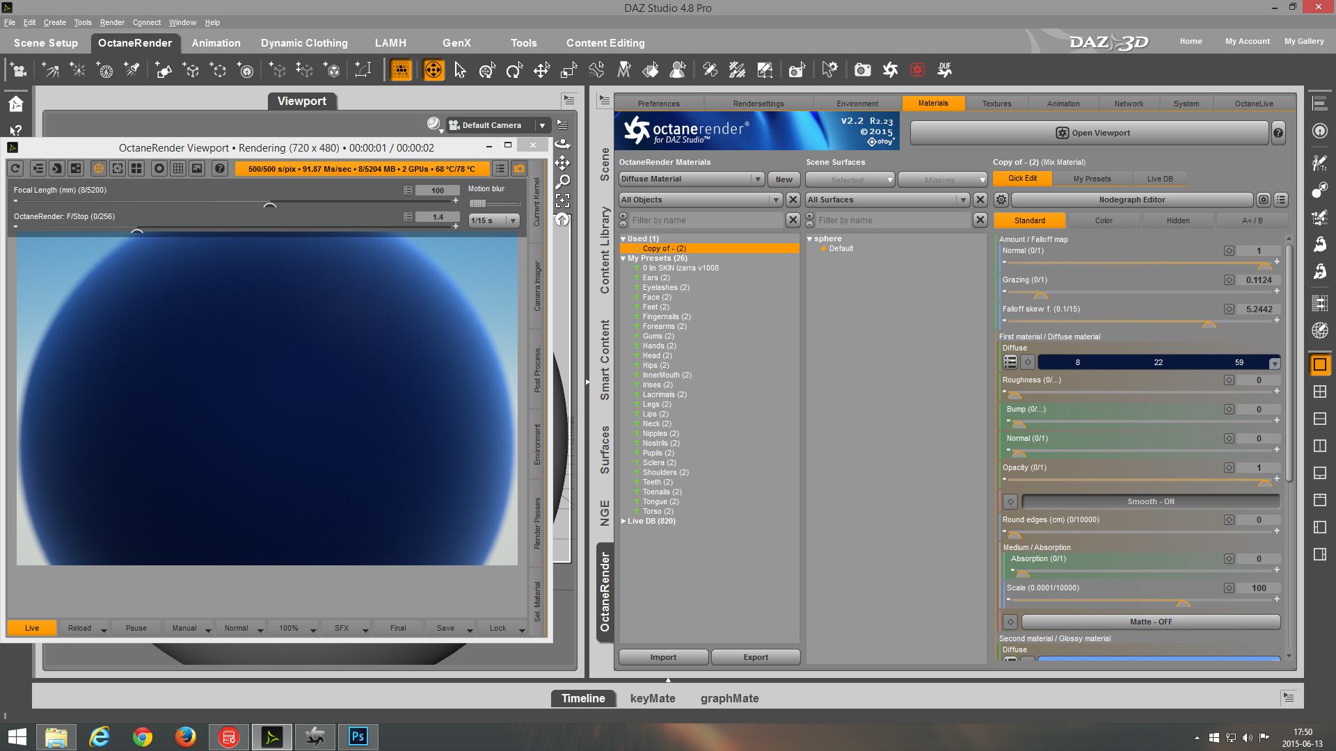

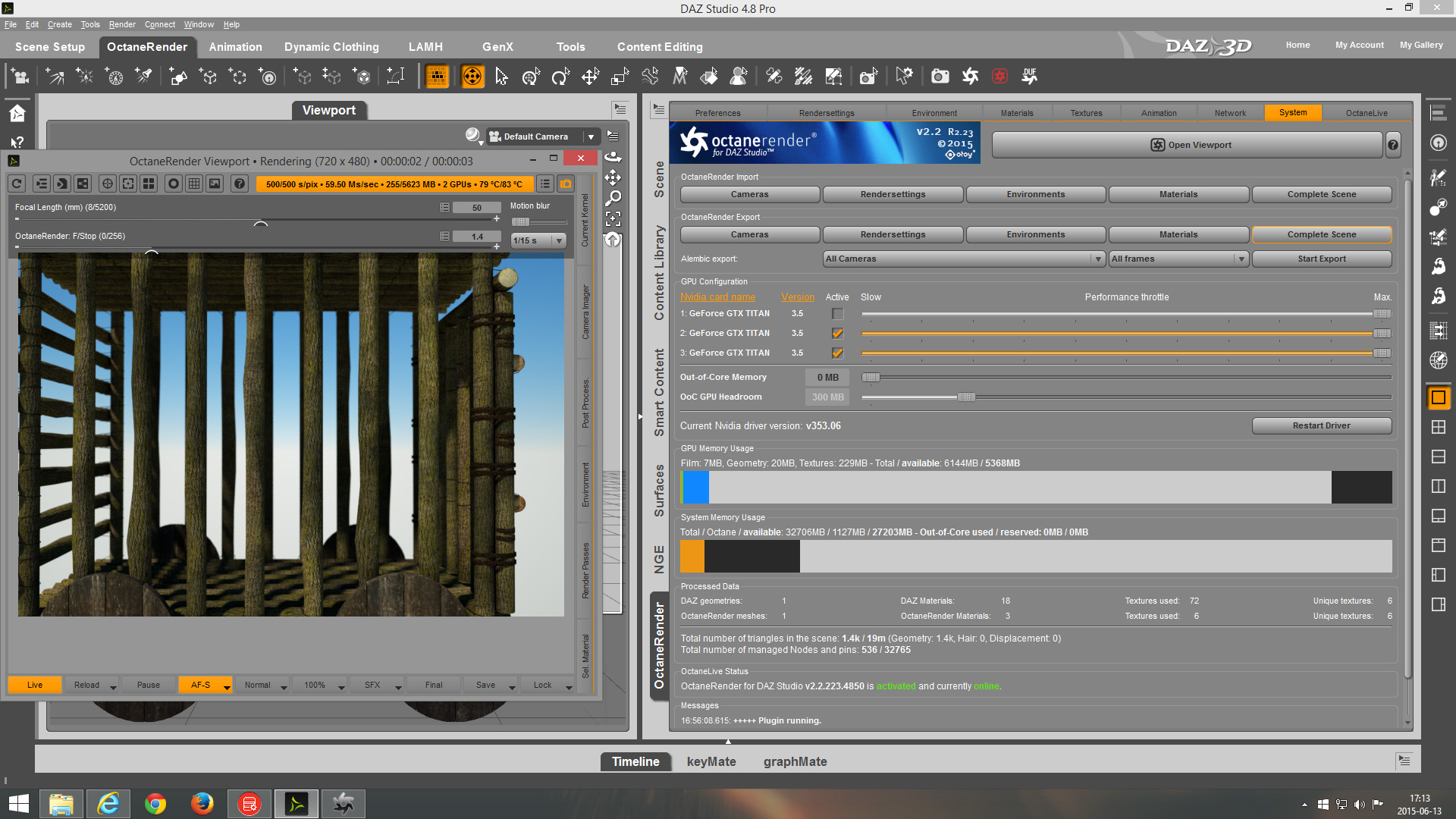

@ Focal Lenght and F stop
Neither the focal lenght nor F stop values match up with a scene exported to the standalone.
The images look exactly identical what may be the most important point.
But the values do not match.
If this confuses you here is some information why that is the case.
Image test example 2:
To make sure I made another test with a scene created from scratch with the v2.2 beta:
Selected in OcDS
50mm
F1.4

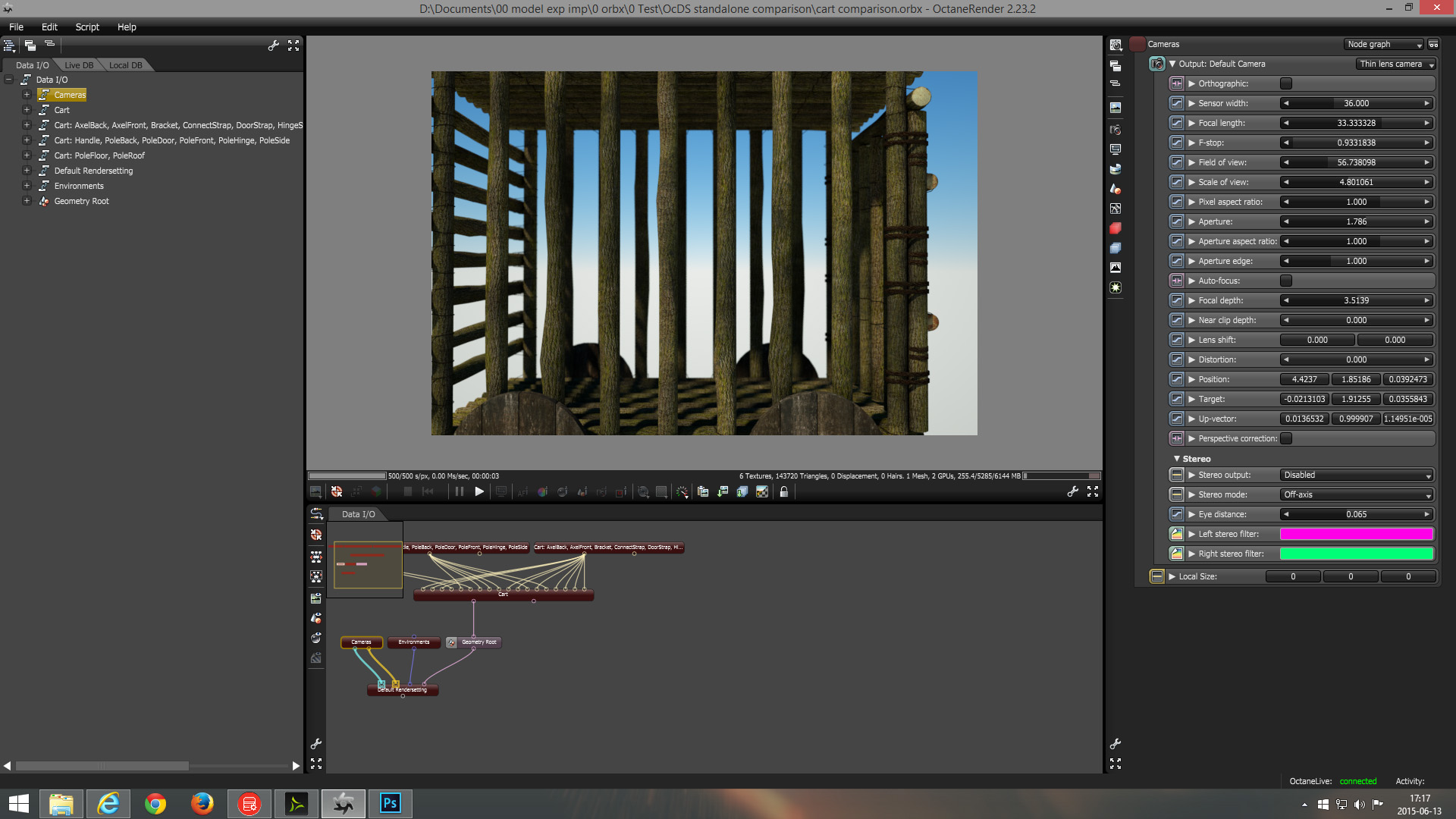

In the standalone you get
F33mm
F 0.93
Image example 3:
To make sure I now used another focal lenght:
Selected in OcDS
100mm
F1.4

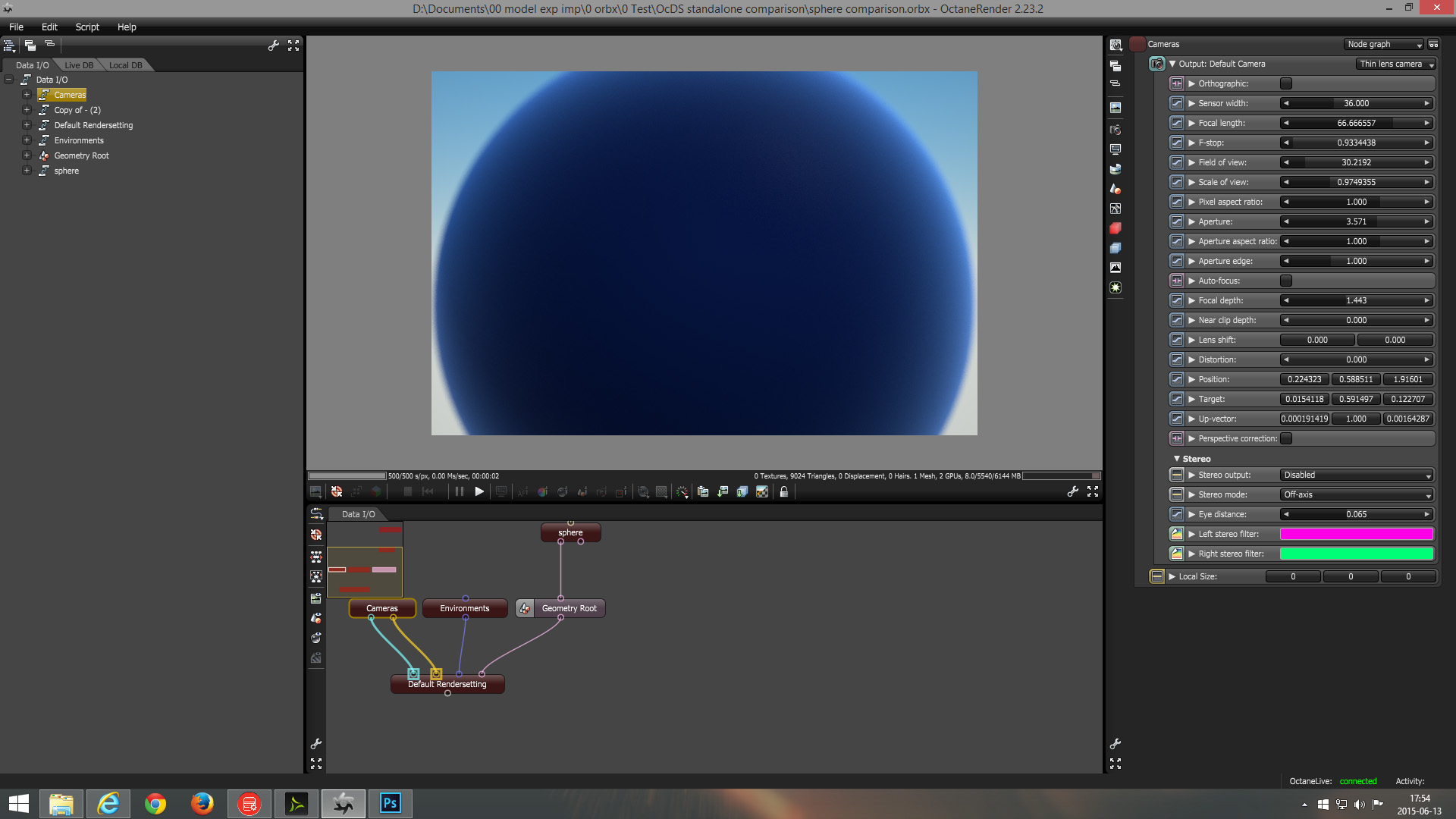

66mm
F 0.93
Update/Edit:
I wrote t_3 a pm to ask for further information to figure this out.
t_3 explained that DAZ Studio and OctaneRender standalone use a different camera system.
in octane, no matter what parameters you actually use, in the end only 2 parameters finally control crop and dof;
octane uses a point hole camera model, with
- aperture and _horizontal_ fov needed to be set.
daz studio uses a camera model based on (fixed) 36mm film
- with focal length and a _vertical_ fov to be set.
Side Note:
What does this mean in practice?
Only if you render out images in square aspect ratios the values of the two different camera systems will match.
If you render out images at extreme horizontal aspect ratios like 10x1 in DAZ Studio you may see distortions.
If you render out images at extreme vertical aspect ratios like 1x10 in OctaneRender standalone you may see distortions.
Because of that my personal preference is:
To use the native focal lenght of DAZ Studio when rendering images at vertical aspect ratios like 2x3.
To use the native focal lenght of OctaneRender standalone when rendering images at horizontal aspect ratios like 16x9 or 3x2.
This means for images with horizontal aspect ratios as a work around you can input the real world focal lenght values you want to match in OctaneRender standalone and then save that camera as .orbx.
Then in the OcDS plugin you can import that camera to get the "adjusted" focal lenght based on the OR standalone camera system.
Nevertheless this does not necessarily mean that this focal lenght is exactly identical to your real world camera focal lenght but it may match better for horizontal aspect ratios.
I guess it may all come down to a matter of personal preference:
My personal impression was that when rendering out images at 16x9 with 50mm focal lenght in DAZ Studio the images looked too wide angled for my taste.
When I observed that in OctaneRender standalone that 50mm is only 33mm I saw that gut feeling confirmed.
Therefore for 16x9 images my solution is to select a focal lenght of 75mm (74.9999) in DAZ Studio to get the effect that may look similar as a 50mm lens.
An alternative may be to just look at the image and move the slider until you like the result...
If anyone ever finds an exact solution to match real world cameras with either the DS or the OctaneRender camera system please write me a PM...

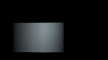

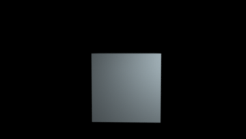

Object motion blur doesn't work.
I've setup scene where primitive cube and camera each are moving one to another. Here is the frame where cube is moving across the camera view rendered with different settings for MB:
No MB
No MB
Object MB
Object MB
Camera MB
Camera MB
Full MB
Full MB
As we see, switching 'Object MB' does nothing, switching 'Camera MB' on makes cube to blur, switching them both on equals to 'Camera MB' while object has it's own movement. So 'Object MB' doesn't work.
In addition, the object motion blur option in SFX dropdown in preview viewport is always disabled and cannot be turned on.
Again, questions arise about the quality of that 'inner circle testing' - motion blur was one of the key features of OR V2 and no one did test it in 6 months?

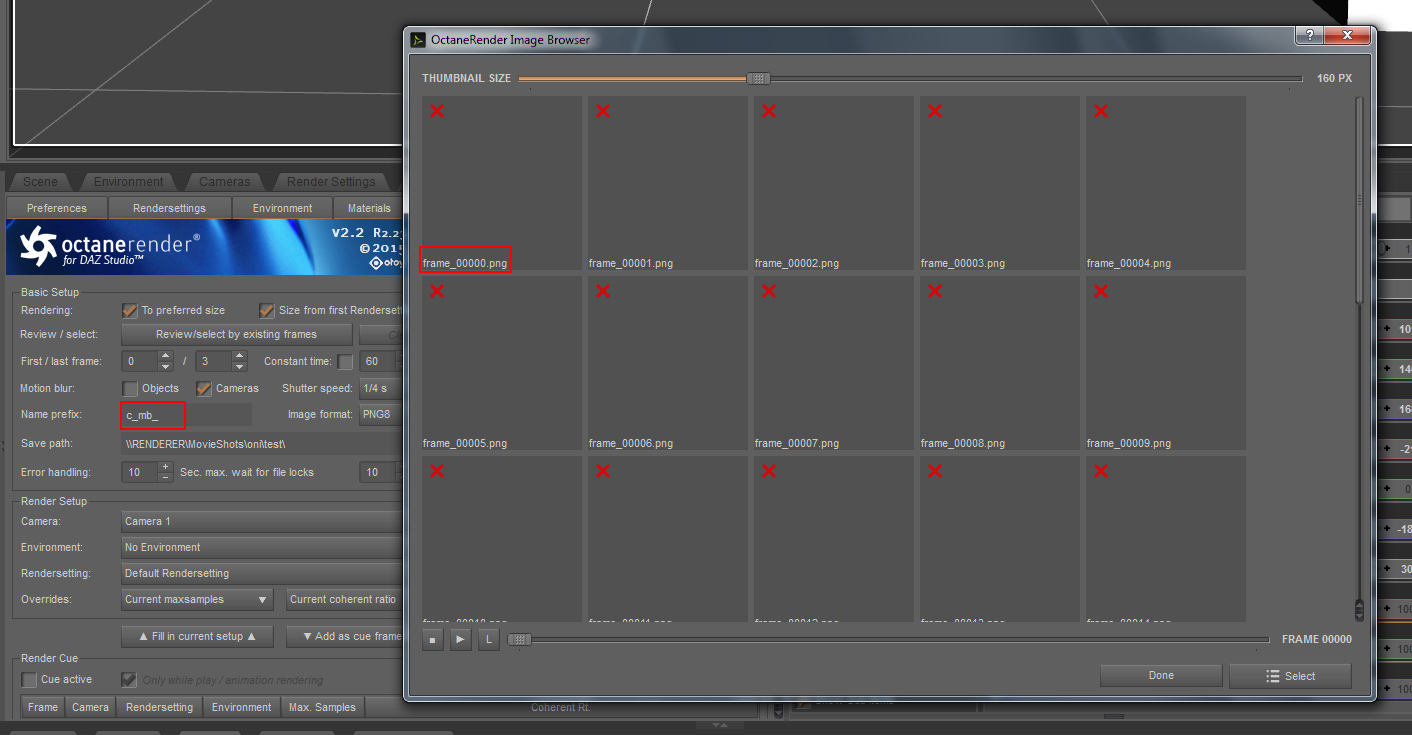

Another funny thing is new shiny image browser - animation player. It unable to browse or play anything when you have non-default frame name:
Image browser
Image browser
Pressing 'Select' does the same as pressing 'Done' - closes the damned thing. And how to open it without rendering animation?

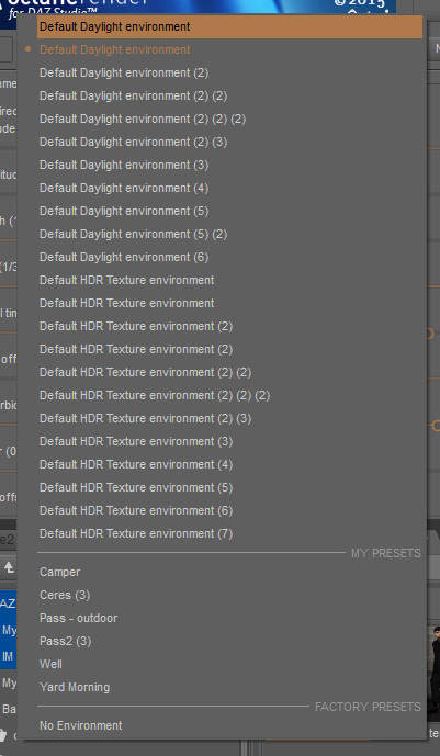

Is it me or this ... emm... stuff is cloning itself faster in new version?
Cloned environments
Cloned environments
Worked with just two scenes before this, both were from the scratch (but I switched between them several times, maybe that's why...). How can there be 10 default daylight environments now? Isn't it supposed to be only one default something?
And this is fresh new (Ctrl-N) scene. Who would need all this in new scene after all?
The same thing with render settings.

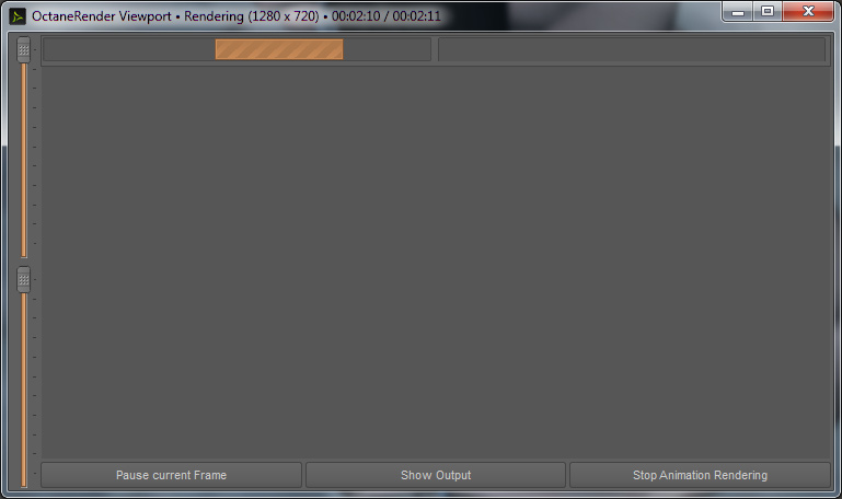

So, I've tried to render animation slightly more complex that a bunch of cubes. Actually, not so complex - just 3 G2 figures, building, some grass and rubble.
Know what? All old friends are here: missing or wrong first frame (if your Studio scrubber is on different frame than you specified as first one of animation), endless freeze (1.2 used to show black window, now we have something fancier) just after you hit 'Start animation':
Animation frozen
Animation frozen
The progress bounces but nothing happens, CPU and GPU are idle (frame-by-frame preview renders were OK). If you try to 'Stop animation render' the window pops up asking 'End animation render?' and after you hitting 'Yes'... nothing happens, you may try to 'Stop...' again, and again, and again... Then get to Task Manager and fire your Studio, it's the only way out.
Do anybody know what those dials on the left side are supposed to do? For me they're just doing nothing.
Well, I've fed up of this shit!

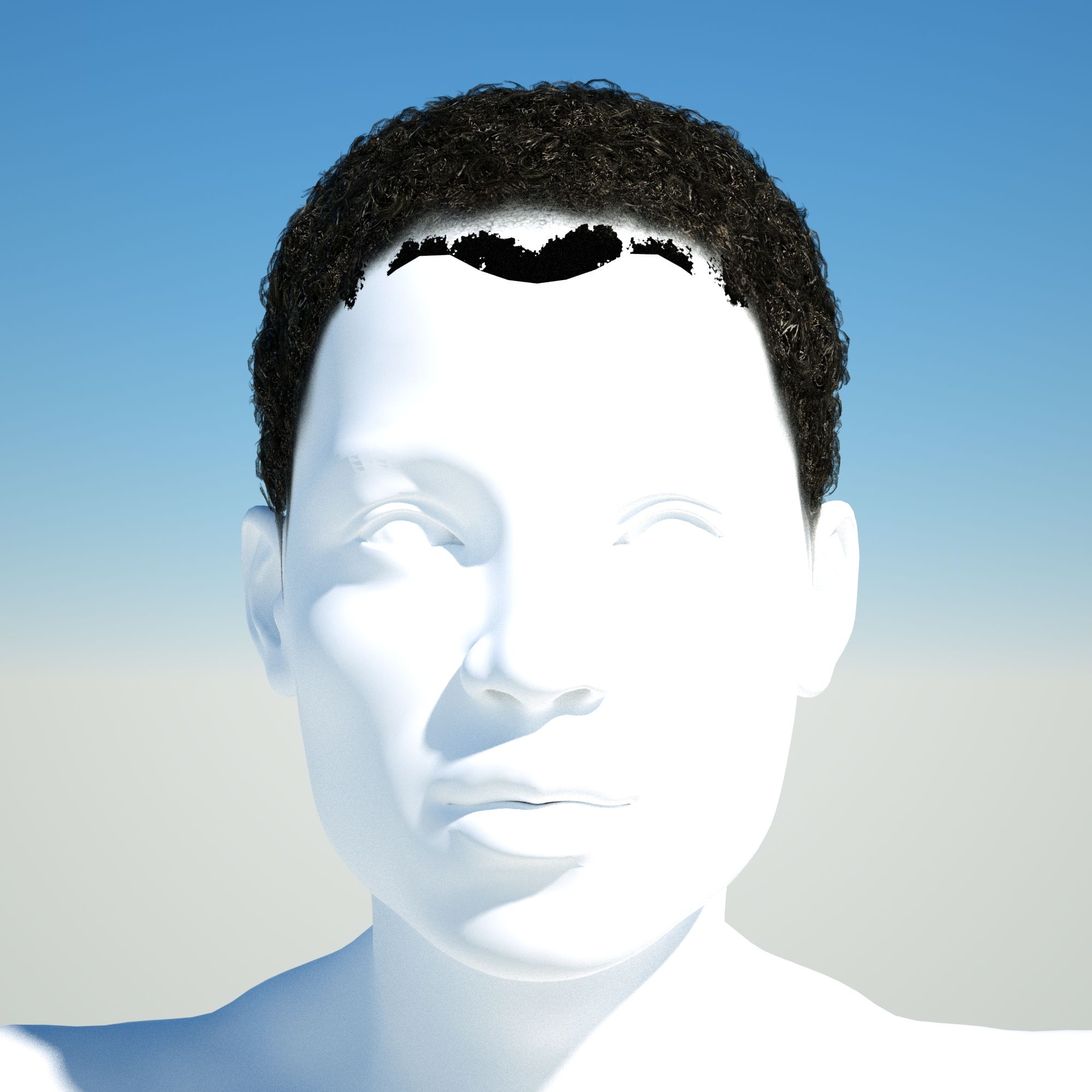

So far I've had a pretty positive experience with 2.2, however I'm seeing an issue when the transparent part of an object with transparency maps collides with another object, specifically hair scalp surfaces with transparency maps colliding with the face and head of figures.
On a separate note, I've also noticed that the render screen is reporting the temperature of the wrong video card, e.g. when I render with Card #1 it reports the temperature of Card #2 and vice versa.
